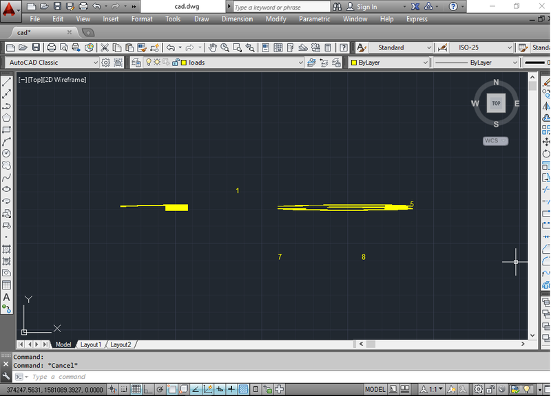

  On 8/30/2020 at 10:06 AM, shadi said:
good afternoon there 😇 , here is the cad file saved in earlier version than 2012 .. , that problem just appeared in mtext summing , not with texts ..  anyway , the most important to me is not to select text twice because really i could forget which one i select and that will affect the result ... thank u once again for ur care
Expand
Many thanks for the drawing, it was a big help. The problem was with the text width. It was picking up the width of the MTEXT text box, which I though I had accounted for. This should now work correctly. I was previously storing all the selected entities in a list to make deleting them easier. The lisp now checks any selected entity against the list. If you have already selected it a pop up alert will tell you it has already been selected. Hope this now works as you require.

sorry for that , but just for more enhancement..  i noticed that when i select entities , if i clicked around the text , the selection choice ended and the lisp start to ask me for insertion location for the sum .. so please if u could change it to be in way when click around , gives message (it even could be in command line) about no text selected and asks for select another entity instead of abort selection ... sorry many words 😁, i hope u got me 🙏
It's currently setup so that if you select a blank area of the screen this is deemed the end of selection. This is the easiest way to control and exit the loop so you have to ensure the required text is inside the pick box. There are three options :
1. Increase the size of the pickbox and reset it on exit. (find a size that suits and eliminates miss picks)
2. Have it ask a "Select Another" question on every iteration of the loop.
3. Change the selection process completely to a selection set pick. This would work if all the TEXT or MTEXT you want to select were on the same layer and would also aleviate the need to check for duplicate entries, but could result in missed items with no way to check.
I leave the decision up to you. It's late here so I'm off to bed, ansd will make any changes when I have time tomorrow morning.

sounds it is hard to change that selection of blank .. but may be it could ended with press space or ctrl or anything else if there is a way to program it
 anyway , thanks for u much , and good night for u there 😇
@shadi I've thought of another way. This asks if you have finished when you make a blank selection. "Yes" will calculate and insert total "No" will allow further selections. Default (press return or right click mouse) is "No"

this is amazing perfect to me 😍🤗 ,  thank u a lot for ur help @dlanorh .. to be honest , i am new in lisp programming and i was trying to do such lisp , i spent days to adjust the first lisp to make it be in the way i wanted but it was complicated to me to do , as u see in the attachment( desktop full of lisps try & error 😁).. then u finally did it to me like superman 😇... so thank u once again dear sir for ur help , ur time and ur patience🌹

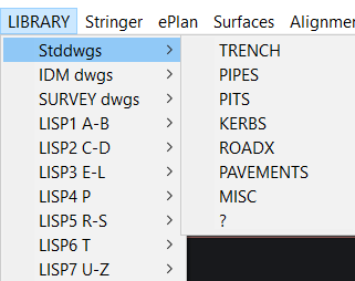

Re all your lisp you can make a custom menu very easy that will have all your lisps ready to use. 1st step is to save all your lisps in a common directory then they wont clutter your desktop.
You just need to add a support and trusted path for the location of the lisps.
You just use notepad save as say SHADI.MNU and use menuload to load it.
***MENUGROUP=SHADI
***POP20
**SHADILIB
             [LIBRARY]
             [1/4 POINTS]^C^C(LOAD "1-4 POINTS")
             [Add 2 Level]^C^C(LOAD "add-to-levels")
             [Add-pits-drain]^C^C(LOAD"Add-pits-drain")
             [Allbylayer]^C^C(LOAD "Allbylayer")
             [Channel Flow]^c^c^p(load "channel flow")
             [Chevron lines]^c^c^p(load "chevron") chevron
             [Color2layer]^C^C^p(LOAD "color2layer")
***MENUGROUP=SHADI
***POP20
**SHADILIB
             [LIBRARY]
Expand

You need to set up where the lisp's are located as a search path in Autocad. Then you can use just the name, else need say  [combineshadi]^C^C(LOAD "c:\\mylisp\\combineshadi") with full path to file.
TYPE OPTIONS
Add where the lisps are and also do Trusted paths, use the  Add then browse.
Edited by BIGAL
TYPE OPTIONS
Expand
i got it , so thank u for ur help , i will try it in morning , now it is too late for me here and so sleepy .. good times for u there 🌹
