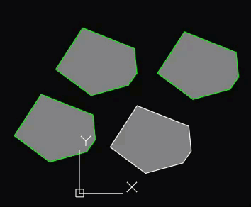

Wondering if someone has a LISP routine. I had a little scour of the web but I don't think I could get the wording right for finding what I need.
I need to hatch some polylines, which are on different layers, in one batch but for the hatches to match the layer of the boundary they are set within? This possible?
Cheers
Greg

Hi Ronjonp,
Thank you for a very swift response. I couldn't get this one to work unfortunately.
I'm not sure when I am supposed to run this routine, as in before I hatch or after, or do I hatch the boundaries first then use this as a kind of match properties tool?
Appreciate your help
Greg
Post a sample drawing. The only thing I can think of is your hatch is not associative.
I think I've figured out where I was going wrong. I was selecting multiple polyline boundaries first then turning them into separate hatches through Hatchedit. Doing it this way didn't seem to play nice with the LISP. I realise now that you just run that routine and it does all hatches, which I think is what confused me.
Doing it this way is likely to be more pain than it's worth on my drawing and I think match props is going to be easier but I do very much appreciate your help!

@gregmorris234 If you want to select the boundaries you can use this ... easy modification.
