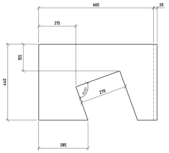

Hey,
Recieved a sketch from a collegue, asking me to add some dimensions to a part.  The dimensions provided were a bit basic, and I couldn't come up with a scientific method to reproduce the geometry without improvising.
Eventually (through trial and error) I have arrived at the solution.  But I am interested to hear if there is a proper method to reproduce the geometry, without having to guess?  I'll post the solution in the replies.
This was provided as a hand sketch, so scaling the dimensions is not an option.
Look forward to seeing the results.

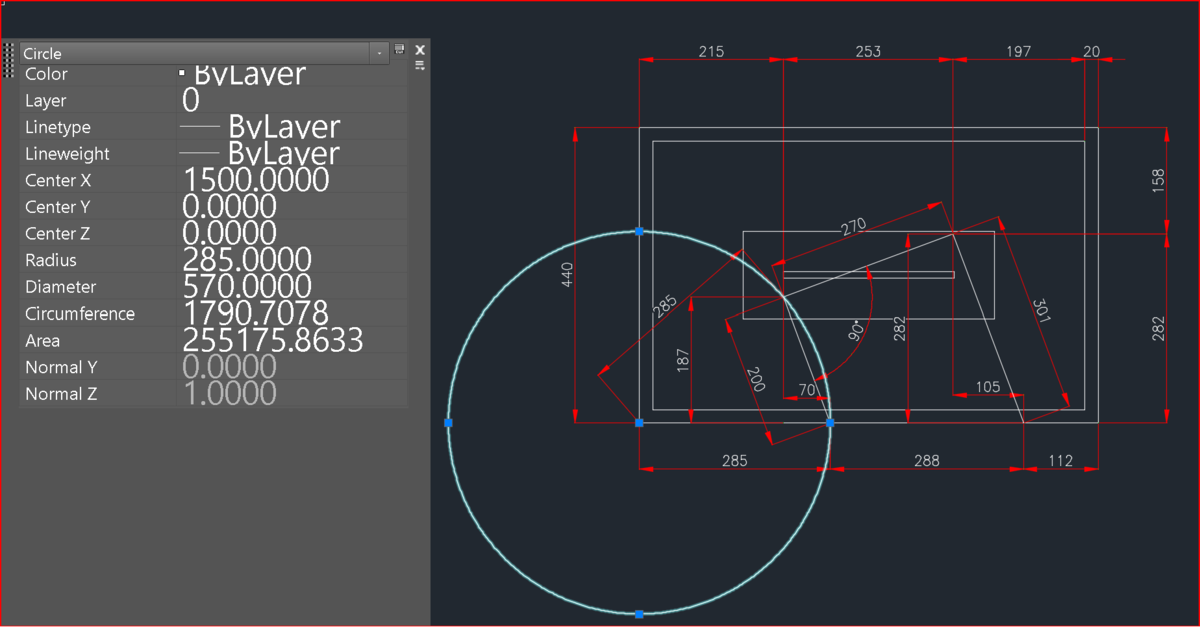

I'll try to post the solution image later. I drew the 440x685 rectangle, then used circles and made a rectangle 270x500 and rotated to the shown points.
I approached it somewhat like SLW210, but without using the Rotate command..
Pretty much nailed it right out of the gate, save for the fact that the intersection snap between the 285 radius circle which I had drawn and the 215 offset line was off very slightly when I really zoomed in close.  I drew a circle of radius 285 from the lower left corner and then found the intersection point of that circle with an offset line of 215 from the left end. Afterr creating that line I offset it by 270, but the corner did not fall on that suggested or mandated 155 offset line from the top, I took that to be a mistake in the dimensions supplied by your coworker.  It is pretty late in my zipcode, I will probably revisit this on the morrow.  I do enjoy a good puzzle though.  :beer:

Tried it again.

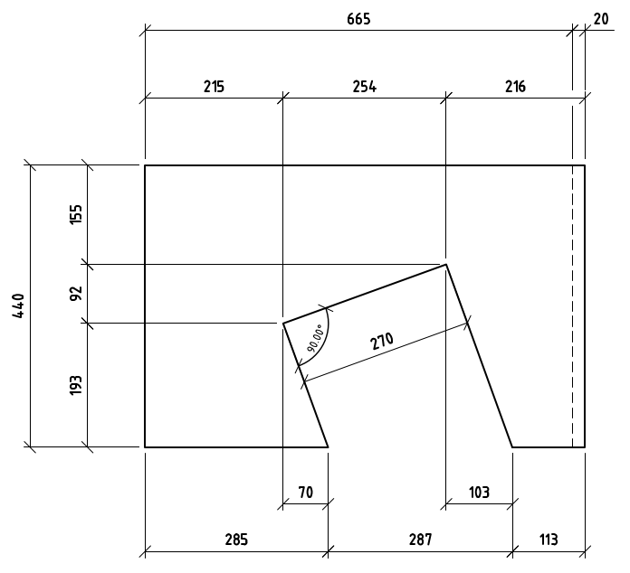

If you can solve the equation (70 * tan(a)) + (270 * cos(a)) = 285, you will be half way there!
@eldon I used the following equation with Google Sheets' Goal Seek (similar to Excel's Goal Seek) to find the complement to the angle you defined.
=70 /tan(radians(B2))+270* sin(radians(B2))-285
where B2 contained the angle alpha and the goal was to set the expression to 0.0.
It calculated an angle of 19.94519043 degrees (or 70.05480957 for your alpha)
Is this a valid approach since the OP asked for a non-trial and error solution and goal seek is just that?

Hi @SLW210 - That sounds like exactly what I did... but once I had the inner rectangle aligned to 2 of the 3 setout criteria (being the 215, 155 & 285 dimensions)... I had to rotate and move and rotate and move, until I found a location that hit all 3 check-points.  Is this what you did?
Hi @Dadgad - I have tested your method, and it is very close to the desired result.  But with a bit of shuffling, you can meet the 155 offset from the top edge.  I haven't been able to find a method to hit all the criteria straight off the bat - all my approaches involved some trial and error.  For example, using your arrangement... the next steps would be:
1.  Move inner rectangle up, to meet 155.  Which will increase 285 dim to 286 (which is so close it's pretty much the solution).
2.  Rotate inner rectangle clockwise about top left point, to meet 285 dim, which moves top edge off 285 dim.
3.  Rinse and repeat step 1 & 2.
Hi @eldon & @lrm - I never really considered a mathematical approach.  These solutions are great - I certainly have no objection to letting software or algorithms work things out for me... I just wish I have the math knowledge to be able to conceive such a solution😅
Doesn't AutoCAD 2014 have constraints, with construction lines drawn at 155 and 215, then constrain the corners to those horizontal/vertical construction lines. I don't have constraints in LT but Fusion 360 made a quick job of this.
Bravo @steven-g, using all the tools in the quiver!
