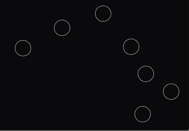

I have this command, it's very old. I've edited it down to it's core and intend to attach a screencast of it being used. It connects circles to each other with arcs. When new employees come on board, the hardest thing to get them to do is not crash it with an "escape". It doesn't trim itself when it crashes. See video for what I mean.
So I've set out to fix it. I've encountered the error message "Can't call a command without *push-error-with-command*, recommend using 'Command-s'"
I've tried the command-s, I've added the *push-error-with-command*, I've tried changing it to vl-cmdf. I can't get it to work.
Here's the routine:

Here's the screencast link so you get a feel for what it does:
https://autode.sk/2CjF844
Fix the code so forces trim before asking for next point you just have to remember the last centre/ last point. Then if esc does not matter. A while pick next is needed.
I've tried not to change too much, but this now works as you wanted. To be honest, the routine could probably do with a re-write.

"I've edited it down to it's core"
It does more than what I pasted here. I replaced global variables with actual values to make it work. It's a small part of a suite of drafting tools (+120 commands - some took a day to write, others took a year) that all work together.
One of the things the full version does is it presents an option to stretch the arc before moving on. This is in case there's an obstacle on the plan, like another light fixture symbol that's on another circuit. (We rarely draw our circuits with arcs. But when we do use arcs, this is the command we use.) So if the arc is stretched after the trim, then the arc is no longer pointed at the center. It's an aesthetics thing. I know what you're thinking, SO not a big deal. And if we were drawing it manually, it wouldn't be a consideration. But, since it's automated, why not do it right? My attitude is always to invest the time up front to make the lisp fully correct, then in theory it's done forever. So the arc remaining to the center is the way that's possible.
I also take the attitude that if something is possible, I should learn how to do it. This improves my skills. I've got some pretty cool stuff now. (This thing was written +15 years ago. And yes, I find myself doing rewrites often. The comment gave me a chuckle.) The error message about *push-error-with-command* and "command-s" imply it's possible to call a command from within an error trap. I'd like to know how.
I thought one possible solution, avoiding the question of "how do you do that", would be to remove the "command" calls. I can entmake a circle easily. I wonder if there's a way to trim (easily) without a command call.
Another solution that has occurred to me in reading your comments, is go ahead and do the trim first. But when someone triggers a stretch, go ahead and extend it back before the stretch. Then trim it back again after stretched. That might also work. So I do appreciate the input, I hadn't really thought of that. Perhaps I was being stubborn.

Do you trim these circles purely for aesthetics? If so, consider using wipeouts or hatched 255,255,255 color blocks maybe?
Solved. Not the way I was expecting, but effective. Still didn't learn to call a command from within an error trap. But learned about vl-catch-all-apply. Which is another topic I've wanted to learn.
Here's a link to what led me to a solution:
https://hyperpics.blogs.com/beyond_the_ui/2012/04/getting-user-input-with-autolisp-and-handling-esc.html

@Quest for Peace Here's a quick example using lines that does not rely on using osnaps .. maybe food for thought :)
(defun c:foo (/ _srt p1 p2 s)
  (defun _srt (p l) (car (vl-sort l '(lambda (r j) (< (distance p r) (distance p j))))))
  (if (and (setq s (ssget "_A" '((0 . "circle"))))
	   (setq s (mapcar '(lambda (x) (cdr (assoc 10 (entget x)))) (mapcar 'cadr (ssnamex s))))
    (while (and	(or p1 (setq p1 (getpoint "\nSpecify start point: ")))
		(setq p2 (getpoint p1 "\nSpecify next point: "))
      (entmakex	(list '(0 . "line") (cons 10 (setq p1 (_srt p1 s))) (cons 11 (setq p2 (_srt p2 s))))
      (setq p1 p2)
