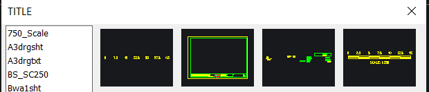

In civil3d its easy to use the layouttool who is extremly easy to handle legends, scalebar and so on in the layout mode. its somewhere here i want to come but with normal Autocad, serching tips to make it simple and fast as possible like the functions there.
But in normal Autocad do you make a new one for each drawing or you use templates there ?, if you using templates you need like 10 blocks with different scale bars for 1:200 1:500 and so on for different page sizes. Thats my thougt about it. How do you working ?
When i want to make a fast print in right scale i often use model sheet and just input a scalebar there, and the scale bars i got in a drawing with different sizes for different pages., and changing the paper size in print options.
But layouts in a template would maybe be the next level for me ;)
We have custom menus they are not hard to make if you can use notepad you can make a menu. One option in the menus is scale bars, the other way do a google is use a dynamic block that can have custom scales.
