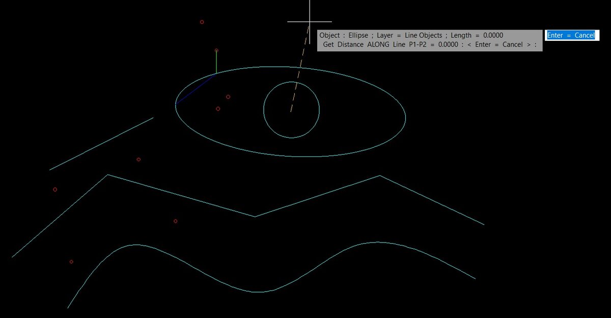

How to write lisp to following problem?
In attached image AB=155,Ay=95,yB=65,yx=75,Ayx=xyB=90 degree, need lisp to point x if enter distance from A and height of xy.  Any one help to solve this problem

Simple double polar, get angle of line, 1st polar is point at distance from end, 2nd polar is from new pt 90 for xy distance not rocket science.
Ok tricky bit but simple solution, pick line 1 end this is end for measure distance, a + or - offset will go left or right.
Do you know any lisp ?
here is the end check

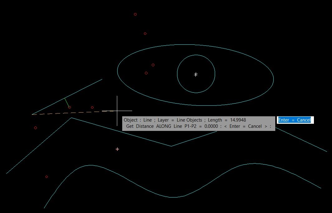

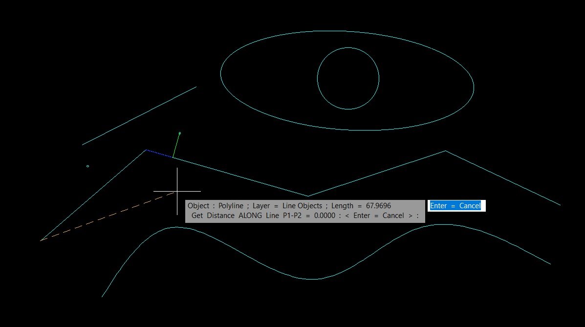

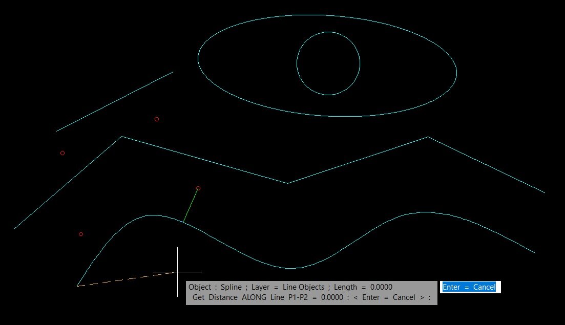

Or , something similar :
-- a NEGATIVE value for distance d1, will calculate the points ,  OUTSIDE of object / direction 1-2 .
- a POSITIVE value for distance d2 , will calculate the points , on the LEFT side of direction 1-2 .
- a NEGATIVE value for distance d2 , will calculate the points , on the RIGHT side of direction 1-2 .
(while (and (progn (reDraw) (setq d1 nil  d2 nil  o nil  p1 nil p2 nil  p12 nil  l (getVar "cLayer")  r 0.2) )
        (if (setq o (car (entSel "\n  Select  a  LINIAR  Object  :  <  Enter  =  2  Points  or  Cancel  >  :  ")))
         (setq p0 (cdr (assoc 10 (entGet o)))  oV (vlax-Ename->Vla-Object o)  p1 p0)
         (and
          (setq p1 (getPoint "\n  Reference  Point  1  :  <  Enter  =  Cancel  >  :  "))
          (setq p2 (getPoint p1 "\n  Reference  Point  2  :  <  Enter  =  Cancel  >  :  "))
        ) ; if o
 (while (and (progn (reDraw) (if (and p1 p12) (grDraw p1 p12 5) ) (if o (setq p1 p0) (grDraw p1 p2 1)) (if (and p12 pX) (grDraw p12 pX 3) ) T)
         (setq oT (if o (strCat "\n   Object  :  " (substr (vla-Get-ObjectName oV) 5) "  ;  Layer  =  " (vla-Get-Layer oV) "  ;  Length  =  "
          (RtoS (if (vl-Some '(lambda (x) (if (vlax-Property-Available-P oV x) (setq oL (vlax-Get-Property oV x)) )) '("Length" "ArcLength" "Circumference")) oL 0) 2 4) "") )  )
         (setq pX nil  d1 (getDist p1 (strCat oT "\n  Get  Distance  ALONG  Line  P1-P2  =  " (RtoS (if o 0 (distance p1 p2) ) 2 4) "  :  <  Enter  =  Cancel  >  :  ")) )
         (if o
          (setq p12 (vlax-Curve-GetPointAtDist o d1)  pa12 (vlax-Curve-GetParamAtDist o d1)
                p1 (vlax-Curve-GetPointAtParam o (fix pa12))  p2 (vlax-Curve-GetPointAtParam o (fix (1+ pa12))) )
          T) ; if
         (progn (reDraw) (if (not o) (grDraw p1 p2 1)) (if (and p1 p12) (grDraw p1 p12 5) ) (if (and p12 pX) (grDraw p12 pX 3) ) T)
         (setq d2 (getDist p12 "\n  Get  Distance  PERPENDICULAR  on  Line  P1-P2  :  <  Enter  =  Cancel  >  :  "))
  (if o T (setq p12 (polar p1 a d1) ) ) ; if o
  (setq a (angle p1 p2)  pX (polar p12 (+ (/ pi 2) a) d2) ) ;
  (entMake (list '(0 . "Circle") (cons 8 l) '(6 . "ByLayer") '(62 . 256) (cons 10 pX) (cons 40 r) )  ) ; end of e
 ) ; wh d
) ; wh p
Edited by Costinbos77
Change the lisp code and added more pictures .

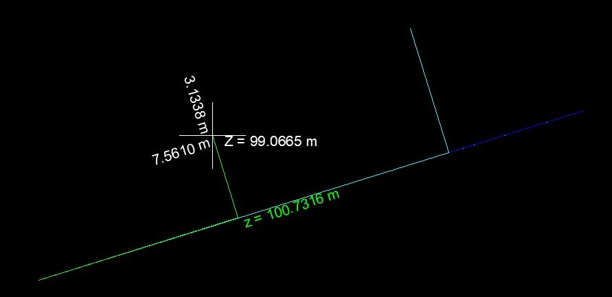

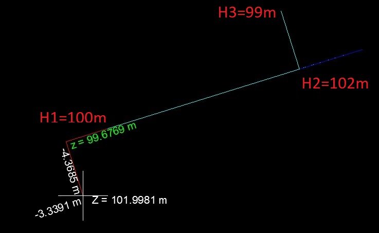

12 hours ago, BIGAL said:
Like the idea distance along a pline.
Thanks BIGAL ,
I done something similar for interpolating Height between 2 or 3 Reference points , using grRead function .
