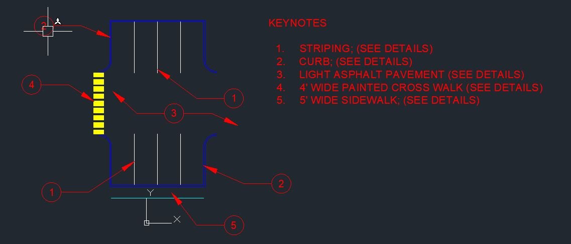

rcb007 Posted August 3, 2020 Posted August 3, 2020 Does anyone have any good ideas when Keynoting up Plans? Currently we have a block with a few common keynotes in it. Then we match the keynote block number with a mleader number. Are there routines where you can put a master list keynote and you can insert the ones you need? Quote

BIGAL Posted August 5, 2020 Posted August 5, 2020 (edited) Using the library list box dcl it allows you to enter the descriptions to be seen and pick one so can be longer than one word. A couple of ways the list of keynotes is ordered the same as their number 1-x so selecting one returns a picked item number this would be added to file name. Other is a double list (("Trees" "c:\\mystuff\\keynotes\\keynote 7 trees")......) = (description filename) This is better in that order does not matter. If you post a dwg I am sure some one will do the front end. Only need a couple of keynotes do not have to be real. What is maximum number of notes. Edited August 5, 2020 by BIGAL Quote
rcb007 Posted August 5, 2020 Author Posted August 5, 2020 Here we go, I have attached a example dwg with some of the keynote, typically used. As for the maximum amount of notes, maybe 30 or so. I would honestly say that it varies. I sure hope this helps! Thank you once again! Keynotes.dwgFetching info... Quote
BIGAL Posted August 6, 2020 Posted August 6, 2020 Try this it can have some smarts added to it. Select Exit to stop. You must make the mtext 1st with say "Keynotes" this could be added to code. ; https://www.cadtutor.net/forum/topic/70967-keynoting-plans/ ; adding keynotes By Alan H Aug 2020 (defun c:keynotes ( / keynotes x mtxt) (setq keynotes (list (list "Exit" "Exit") (list "Striping" "STRIPING; (SEE DETAILS)") (list "Curb" "CURB; (SEE DETAILS)") (list "Light Asph Pav" "LIGHT ASPHALT PAVEMENT (SEE DETAILS)") (list "4' wide painted x walk" "4' WIDE PAINTED CROSS WALK (SEE DETAILS)") (list "5' wide sidewalk" "5' WIDE SIDEWALK; (SEE DETAILS)") ) ) (defun picknote ( / key ) (setq lst '()) (foreach key keynotes (setq lst (cons (car key) lst)) ) (setq lst (reverse lst)) (if (not AT:ListSelect)(load "Listselect")) (setq pointspick (car (AT:ListSelect "Keynotes" "Select notes" 10 10 "false" lst ))) (if (/= (setq note (cadr (nth (atoi item) keynotes)))"Exit") (setq note (strcat "\\P"(rtos x 2 0) "." "\t" (cadr (nth (atoi item) keynotes)))) ) ) (setq note "") (command "_.CMLEADERSTYLE" "KEYNOTE CALLOUT") (setq x (getint "\nEnter start number")) (setq mtxt (vlax-Ename->Vla-Object (car (entsel "\Pick mtext")))) (setq txtstr (vla-get-textstring mtxt)) (picknote) (while (/= note "Exit") (princ "\nLeader pick points") (command "mleader" (getpoint "\pick 1st point then 2nd point") pause (rtos x 2 0)) (vla-put-textstring mtxt (setq txtstr (strcat txtstr note))) (setq x (+ x 1)) (picknote) ) ) (c:keynotes) Quote

BSmiths1544 Posted May 15, 2024 Posted May 15, 2024 BIGAL, Thank you! Your code worked great! I use MLEADERS with blocks at the end. The block is basically just a solid-filled circle with the number in the middle. How could I insert these number blocks automatically next to the corresponding note inside the MTEXT note box? Quote
BIGAL Posted May 15, 2024 Posted May 15, 2024 Maybe start with this. You can edit and add the solid hatch and do draworder to send to back. Pt num bubble.lspFetching info... Quote
