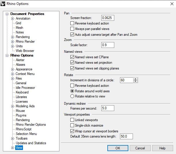

Problem locating shaded and show mesh wires in options
Can someone here help me locate the shaded and show mesh wires option in Rhino Options
I am using version 5.
Ezra Botvinic
The options do have a mesh section under document properties.
That could be it.
-ChriS

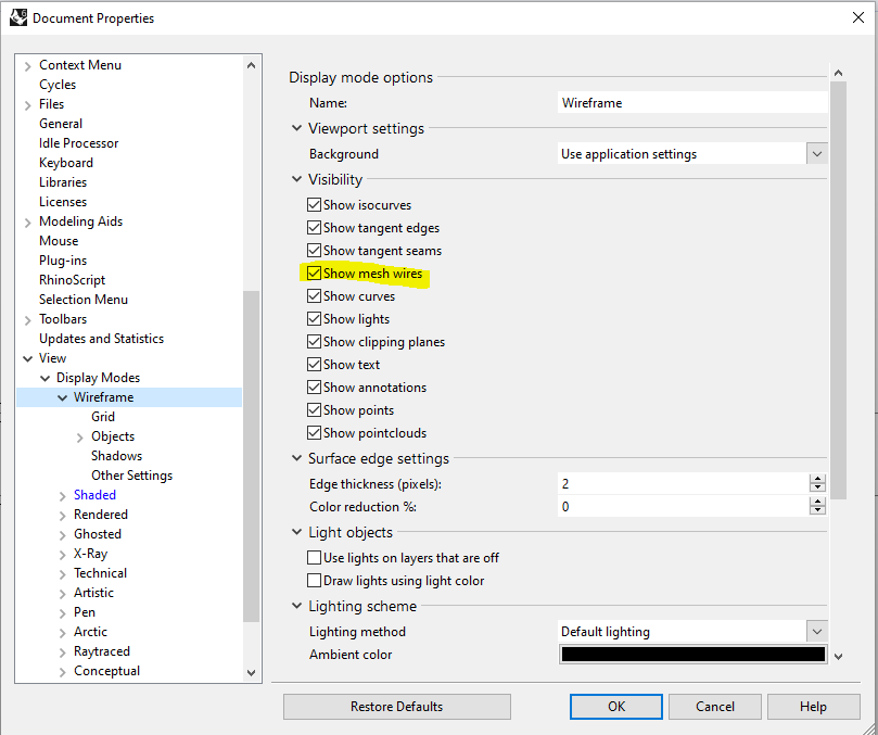

The display modes for display ports are located in a drop-down menu under the display port title bar. If for some reason mesh wires aren't displaying when you are in the wireframe display mode, you can find the setting to turn them on in the options under "View > Display Modes > Wireframe".
