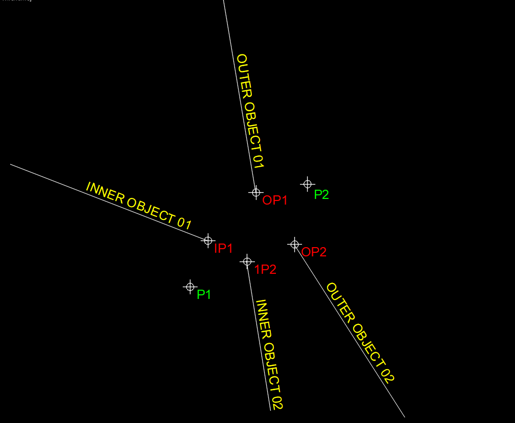

Can someone help me to find the solution for some doubts.
If someone will make one lisp for this, so I think I will get answer for few doubts
I need to draw a pline  inside this 4 line using line point
like this
My doubts
1                     how to get “line point” with window selection (4 line all pints not in window only 4 line 4 point)

2                     how to segregate the entity (which one is first which one is last)
3                  how to entmake pline
I think select 4 lines then pick a point in approx middle this is needed to make sure get correct end of line else may go to wrong end, the get a list of points sort on angle of point to end of line then draw pline, no idea if it will work just an idea. Need time, should work for any amount say 3+

Let me consider these lines are only 4
From p1 to p2 I need to segregate to inner object and outer object
