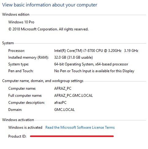

afrazahmed Posted July 22, 2020 Posted July 22, 2020 Could you please some one help me what specification are more prefer for Civil 3D / MAx or Auto Desk App. please advice me a good configuration PC for running such apps. PC good or Workstation please advice Quote

afrazahmed Posted July 22, 2020 Author Posted July 22, 2020 Im from UAE -Dubai and I have already im using now i7 32 GB RAM but im not happy with this i want good speed Quote
f700es Posted July 22, 2020 Posted July 22, 2020 What graphics card friend? To get faster with renders then you are going to have to jump to an AMD Threadripper and they are EXPENSIVE! The current fastest one is almost $6k USD but you do get 64 cores and 128 threads at 4.3 GHz!https://www.newegg.com/amd-ryzen-threadripper-3990x/p/N82E16819113620?Item=9SIA8UCBA07441&Description=Threadripper&cm_re=Threadripper-_-19-113-620-_-Product&quicklink=true You'll need quad channel ECC ram as well. I have the same CPU and ram at work but I don't do a lot of renders. Quote
Cad64 Posted July 22, 2020 Posted July 22, 2020 On 7/22/2020 at 1:32 PM, afrazahmed said: Im from UAE -Dubai and I have already im using now i7 32 GB RAM but im not happy with this i want good speed Expand What are you not happy with? Rendering speed? System performance? And what would you consider to be "good speed"? My last computer was an i7 with 24GB RAM and it was able to do everything I threw at it. If you could provide some examples of the type of work you're doing and what problems you are experiencing, maybe we could be of more assistance, but if you're using an i7 with 32GB RAM and you're having trouble, I can only assume it's your video card. 2 Quote
afrazahmed Posted July 25, 2020 Author Posted July 25, 2020 On 7/22/2020 at 3:37 PM, Cad64 said: What are you not happy with? Rendering speed? System performance? And what would you consider to be "good speed"? My last computer was an i7 with 24GB RAM and it was able to do everything I threw at it. If you could provide some examples of the type of work you're doing and what problems you are experiencing, maybe we could be of more assistance, but if you're using an i7 with 32GB RAM and you're having trouble, I can only assume it's your video card. Expand see I want to use for Civil 3D when Creating any file like surface alignment cross section its hanging the file and when converting into cad for further work its hanging my pc cant scrool or work taking time . Quote
Cad64 Posted July 25, 2020 Posted July 25, 2020 On 7/25/2020 at 11:10 AM, afrazahmed said: see I want to use for Civil 3D when Creating any file like surface alignment cross section its hanging the file and when converting into cad for further work its hanging my pc cant scrool or work taking time . Expand I don't use Civil 3D so I can't help you with that. You might want to post a question in the Civil 3D section. Maybe someone knows how to solve that issue. https://www.cadtutor.net/forum/forum/45-civil-3d-amp-ldd/ Quote
BIGAL Posted July 26, 2020 Posted July 26, 2020 If its hanging your CIV3D there is something wrong with your CIV3D you may need to reinstall even though its a big step. Are you using a 3rd party software on top of your CIV3D ? I run every day CIV3D no probs. Quote
afrazahmed Posted July 26, 2020 Author Posted July 26, 2020 No Im not using any 3rd Party app with Civil 3D when creating any surface or corridorre its handing even converting file into cad much hanging some time not successful this operation im thinking if C3D like this how people are working even i have reinstall many time and using good PC configuration. Quote
Cad64 Posted July 26, 2020 Posted July 26, 2020 On 7/26/2020 at 4:17 AM, afrazahmed said: No Im not using any 3rd Party app with Civil 3D when creating any surface or corridorre its handing even converting file into cad much hanging some time not successful this operation im thinking if C3D like this how people are working even i have reinstall many time and using good PC configuration. Expand Can you provide one of your files for testing? Maybe BigAl or someone can take a look and see if they experience any issues. Quote
tombu Posted October 29, 2020 Posted October 29, 2020 On 7/26/2020 at 4:17 AM, afrazahmed said: No Im not using any 3rd Party app with Civil 3D when creating any surface or corridorre its handing even converting file into cad much hanging some time not successful this operation im thinking if C3D like this how people are working even i have reinstall many time and using good PC configuration. Expand What Video Card are you using? Quote
