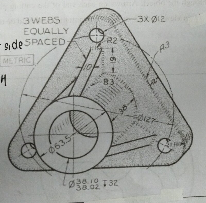

I don't know how to get started with the main object. Extruding a 2D triangle doesn't work and I tried to fillet a pyramid but realised that I can't smoothen the top vertex. And I'm not sure what the height of the main object is to begin with.
This is a very odd drawing to look at. It's like an isometric and plan view drawing combined in the same drawing. :lol:
The height of the main triangle is 12. It's shown on the side edge.
I would probably start by drawing the 127 dia. centerline circle, then draw the three small dia. holes, then offset the holes to get the rounded corners of the triangle. Then you can draw the lines for the edges of the triangle using the Tangent Osnap. Then Trim everything and run the Polyedit command to join all the segments of the triangle into one continuous polyline.
That should get you started. Let us know if you get stuck.

How I would start is draw the center circles as a reference point.  array 3 lines around the circle and offset each 5 mil to each side for the webs, then offset again 19 mil to finish the webs.
from there I would draw the larger 127 mil circle.
Draw the 12 mil circle holes (array if u want).
offset the drill holes 15 mil to get outside of each corner.
tangent osnap would clean up the rest.

It's an oblique projection.  It's a form of a parallel projection but unlike an axonometric projection (i.e., isometric, dimetric and trimetric) the projection lines are not perpendicular to the viewing plan (although parallel to each other).  We made them back in the day because you could draw a circle as a circle if the circle was in a plane parallel to the viewing plane.  Axonometric projections require drawing an ellipse to represent a circle.  If the third axis is scale by a half then it is called a cabinet projection.

@Cad64 @ammobake yes that definitely helped! I don't know why I find it so hard just to figure out how to start haha. Thank you.

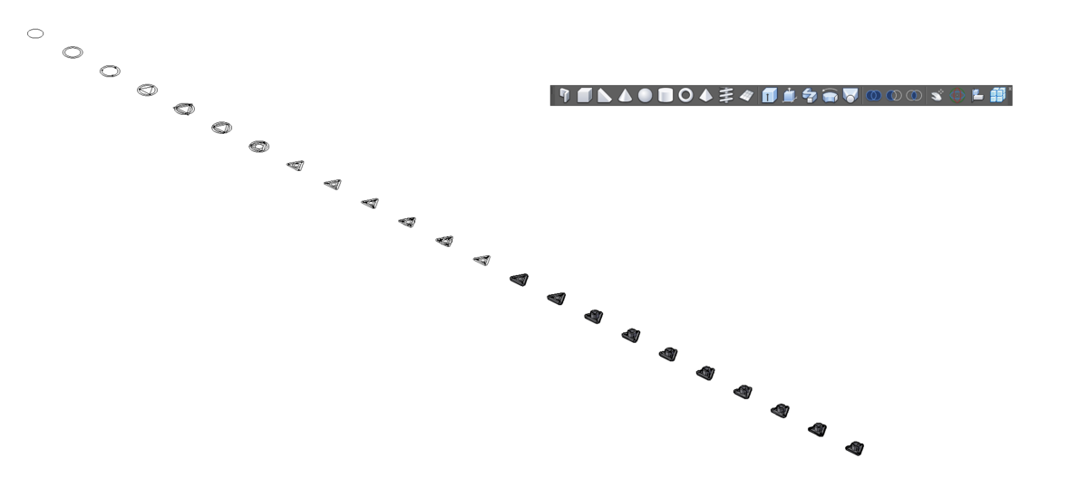

As far as modeling this in 3D hopefully this progression of images will help the OP sort of think it through, so many different ways to approach it.
