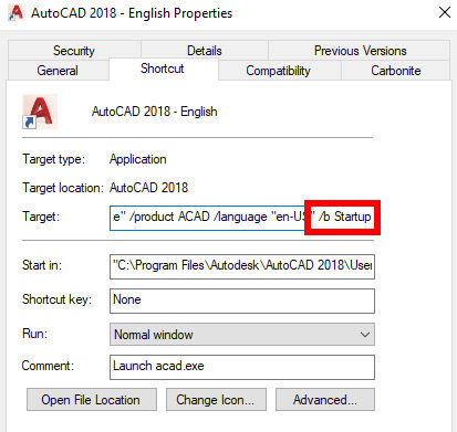

2. Right click on your Autocad desktop icon and click on "Properties". Then add /b Startup to the end of the "Target Location" as shown below.
