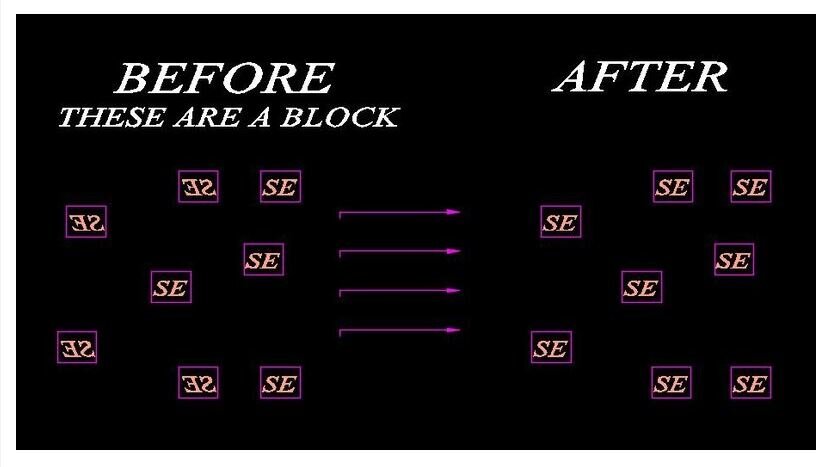

In the mirror command the letter inside block get inverse . are there any lisp code mirroring block without reveres letter inside them.
And how we can correct them after mirroring, as the following picture ::
Before mirroring text, make sure the mirrtext system variable is set to 0. This will ensure attribute text is not mirrored, but text will be. If the text is mirrored then you will need to check if the xscalefactor/yscalefactor properties are a minus value or  dxf codes 41 & 42 and adjust

AND POINT IS :
IS THERE A WAY TO RETURN MIRROD BLOCK TO INITIAL DIRECT  REFER  TO FOLLOWING PIC :
OR
Select similar
Ctrl+1 = Properties
Change X to a non-negative value
