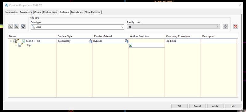

I got help from someone else and basically had to add overhang correction and breaklines to the surface
Good to know. Civil 3D has always had a problem with vertical surfaces. Something about dividing by zero, I guess.
