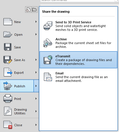

If you want to open from another PC or server save with eTransmit
This will create .rar file with every image in the file and you can use it when you want without problem.

Good to know Trudy, so can i do eTransmit and send via email? can other people open with no issue? as far as ETransmit if people still keep moving the image folder or rename folder  i will still having issue correct? Etransmit won't help right?
Expand
Correct. You need to stop people from moving and/or renaming folders. Every time someone does this, it breaks the link and the files won't show up when you open the drawing. This is the root of your problem.
As for emailing files, Trudy is correct, Etransmit is definitely the way to do it. It's a pity that more people don't know about this. I get files from engineer's and architect's all the time with missing xrefs and images, and when I contact them and ask them to Etransmit the files, they have no idea what I'm talking about. :roll:
