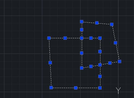

bah026 Posted June 24, 2020 Share Posted June 24, 2020 Hello, I need to generate a close polylines from the end/beginning points of a line , which mean, after I'm having all lines in the drawing I need to run some loop that find the vertex of those lines and to generate a poly from those vertexes, The vertex point I already able to find by autolist code, so I only need to generate the polyline. in the attached files I have example of the beforeDocument2.pdf and after that result I need to get Quote Link to comment Share on other sites More sharing options...

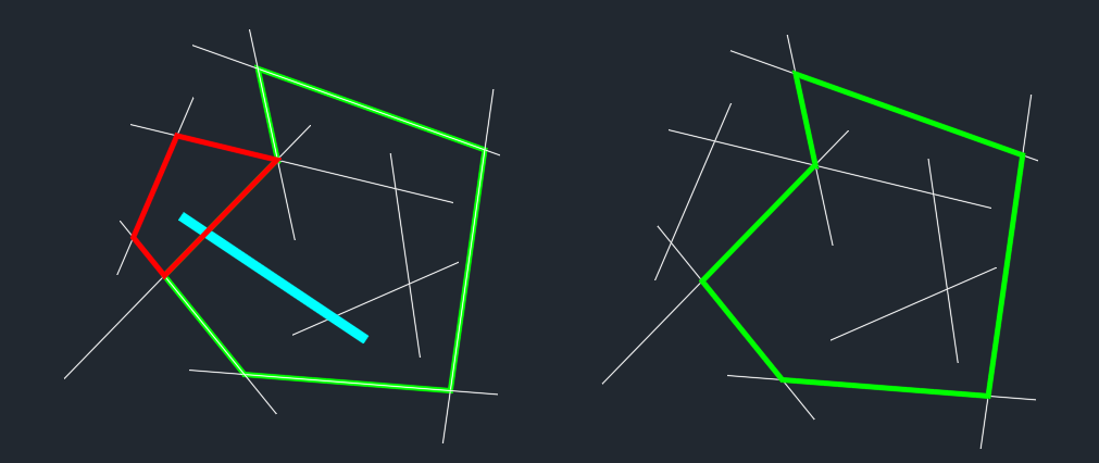

BIGAL Posted June 25, 2020 Share Posted June 25, 2020 (edited) Bpoly with OOPS no need for code. Look at cyan line. Edited June 25, 2020 by BIGAL Quote Link to comment Share on other sites More sharing options...

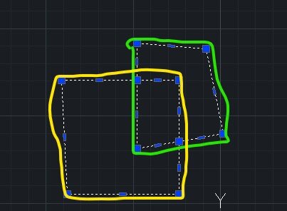

bah026 Posted June 28, 2020 Author Share Posted June 28, 2020 Thanks for the answers, The Bpoly don't do it's work, even a simples lines, it couldn't recognize the 4 closed poly, only the 2 outers (yellow and green) Quote Link to comment Share on other sites More sharing options...

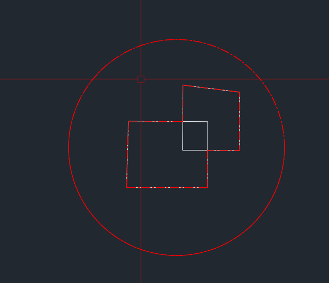

BIGAL Posted June 29, 2020 Share Posted June 29, 2020 Agree with Stefan your 1st example was random lines not overlapping objects. If I remember correct there is an answer using region for simple overlapping objects. This is not a new request and has been solved previously its a case of finding that solution. Google is your friend. A quick and dirty, draw say a circle or pline around outside of objects, then BOUNDARY with island detect on Pline option, pick point inside circle see image two plines are made. Very limited testing. Quote Link to comment Share on other sites More sharing options...
bah026 Posted June 29, 2020 Author Share Posted June 29, 2020 Hi Stefan, see attached drawing befor and after runnung the enclosed_polyline.lsp Maybe I didin't express myself, but I'm looking to get all the closed polylines contain the vertex point of the lines, in this example Drawing11.dwg Drawing11-after.dwg Quote Link to comment Share on other sites More sharing options...

Roy_043 Posted June 29, 2020 Share Posted June 29, 2020 On 6/28/2020 at 12:03 PM, bah026 said: Thanks for the answers, The Bpoly don't do it's work, even a simples lines, it couldn't recognize the 4 closed poly, only the 2 outers (yellow and green) I would say that 6 different polylines can be derived from those lines. Quote Link to comment Share on other sites More sharing options...
marko_ribar Posted June 29, 2020 Share Posted June 29, 2020 (edited) I counted 8 different polylines... Edited June 29, 2020 by marko_ribar Quote Link to comment Share on other sites More sharing options...
