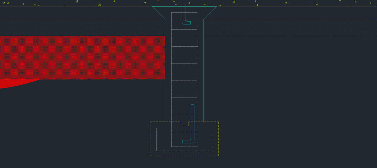

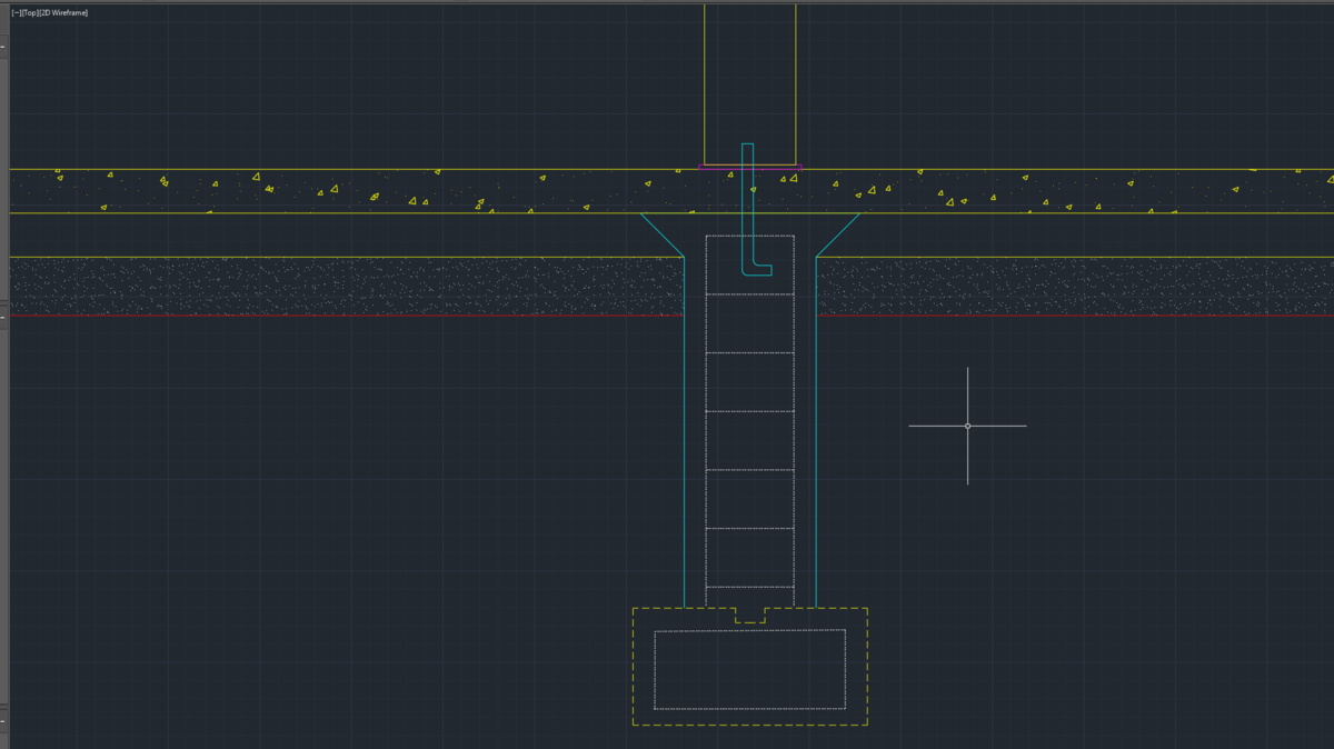

Also should I just connect the pillar rebar and footing rebar together instead of showing it like they are not connected?
How do I draw the southern Roofline on plate 2?
Here is my updated J bolt on the drawing. I drew it with a radius of 3/4", 4" horizontal line, and 3.5" projecting out from top of concrete slab. Hope I got it right.
Are the baseplates also located on top of the I beams? Can I just draw a line connecting the tops of the I beams to show it as a roof? Also is there metal siding on the top of second floor channel?
I would draw the rebar at the bottom of the footing "U" shaped then extend the rebar in the pier down into the footing and add a hook pointing outward.  Make this rebar overlap the "U" rebar by 2".  Didn't P-F give you an example to refer to as part of the structural project?

Rave for your info, the J bolt is probably bent cold so the radius is probably to tight its been a while since I did rebar, but there will be a rule about rad * x I would use say 4 * bar dia.
That is good to know. I tried to draw the radius based on the 1 1/2 diameter the pdf states. I hadnt thought that info was for the J hook initially so I just made it 90 degrees, but i corrected it now.

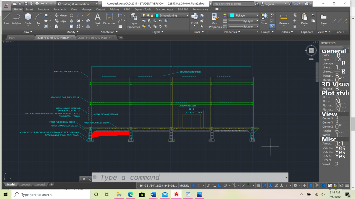

Also  (I am assuming I finished my Plate 2. Any comments on the screenshot? 😞
Unfortunately Plate 2 is not finished nor is it correctly drawn.  Some of the things that need to be addressed are:
The opening for the overhead door does not show the columns the beam rests on.  The sliding door would not be shown.
The roof is incomplete.  You have not shown the caps on the columns at both ends nor the thickness of the roof.  The roof thickness would be drawn using the hidden line type.
It appears as though you have added an actual "J" hook in the footing.  That is incorrect.  Unfortunately it is difficult to see clearly.
You have not shown portions of the metal siding.
Your dimensions appear to be quite small but once again it is difficult to determine because of the size of the image.
So if I show the beams the overhead rests on, the sliding door that I have already drawn would look correct? I am just clarifying since I saw most sliding doors represented like this in other students drawing here.
Ok, I am removing the J hooks from the footer.

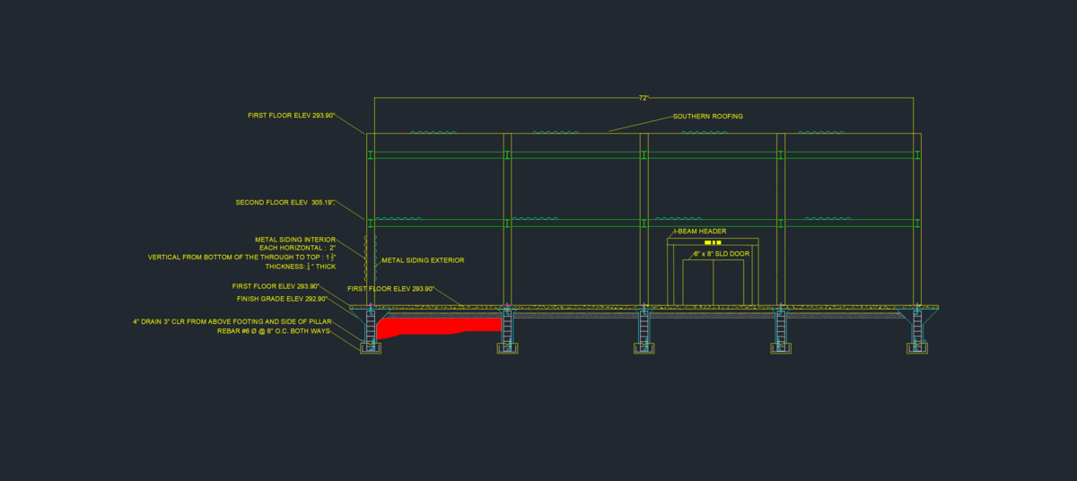

I made some changes. I am still confused about drawing the southern roofing. I put steel decking on 2nd and third  columns. But i just a drew a lijne connecting everything at top to represent the southern roofing. I am not sure if i need to draw the roof drain/poured in concrete that slopes on plate 2. I hope my enlarged text font helps.
The W10x45 beam should be extended to the nearest column on each side.
There is no "J" bolt in the footing.
The vertical rebar in the pier should end with the bars pointing in the opposite direction and 2" off the "U" shaped rebar in the footing.
The metal siding on the building runs vertically not horizontally and should be shown in elevation view in a few (three or four) locations) of the building.  Draw freeform closed polyline areas and hatch them according to the instructions.
Your hatching is too dense.  Increase the scale factor.

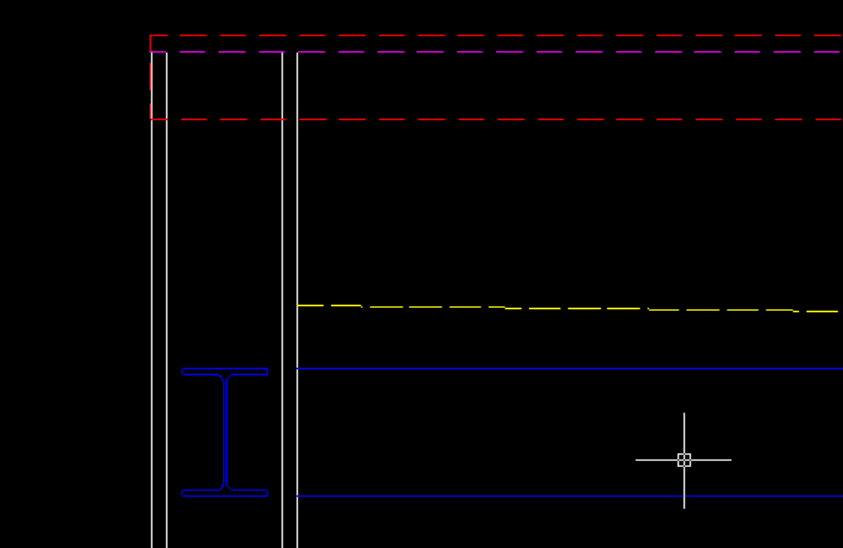

This is how one student showed the roof line (color: red).  Note: the roofline is actually the flashing on the edge of the entire perimeter of the building.  The roof, which sits below the flashing, is depicted in color yellow.  I believe the student determined the layer colors himself rather than follow the project instructions.  I would not recommend doing that.  The ability to follow instructions is important in any task or job.  BTW...the footings, columns and roofline are supposed to be shown using a hidden linetype as per the instructions.
Two more things.  1. The rebar in the footing is #6 bar at 8" in BOTH directions.  You have only shown the rebar in ONE direction.  w. You need to show the thickness of the flanges on the beam above the sliding door.  The columns can be drawn with the flange edges exposed or the face of the flange.  It's your choice.  neither are incorrect.

Your footing/pier detail should look more like this.  The hooks at the end of the rebar that extends into the pier lock the footing and pier together.
Like Remark the J hook will possibly extend further down into the concrete footing looks to close to top. Overturning moment from column will pull hook out.
