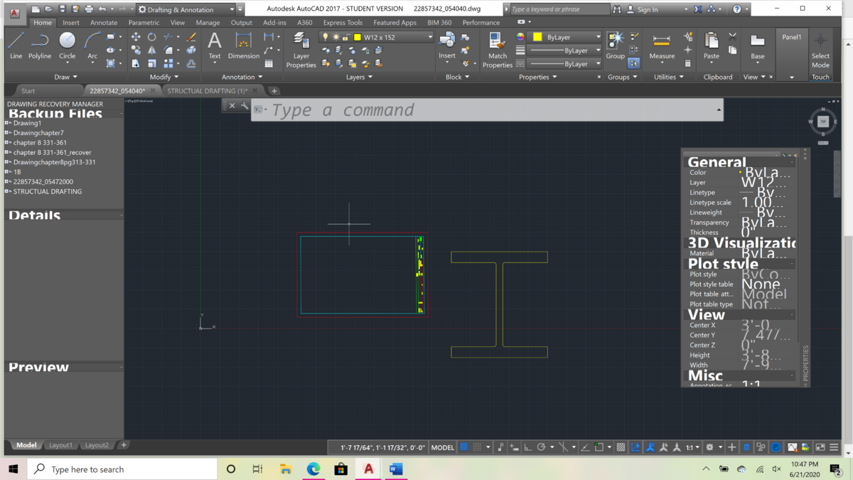

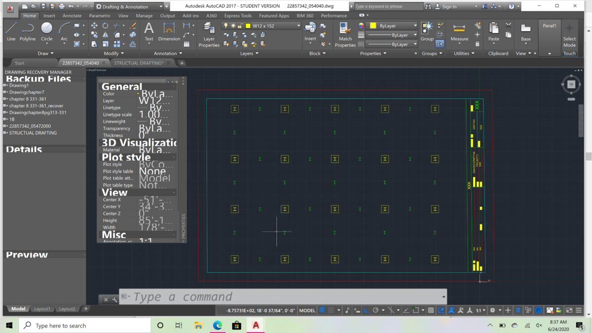

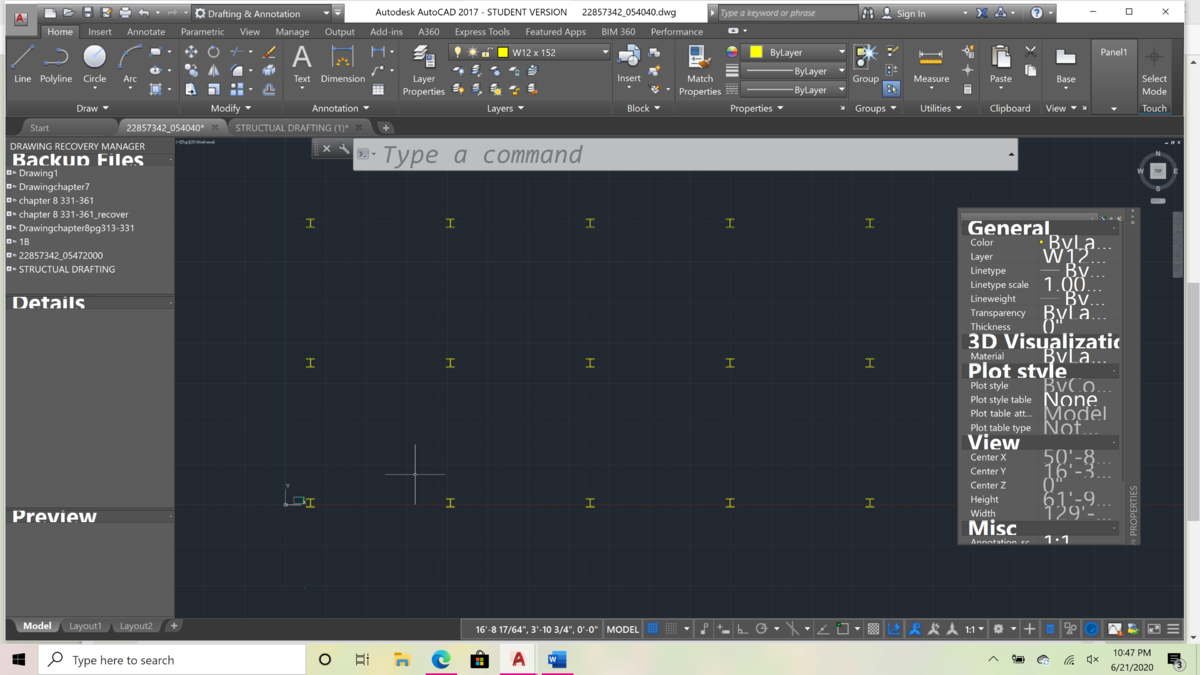

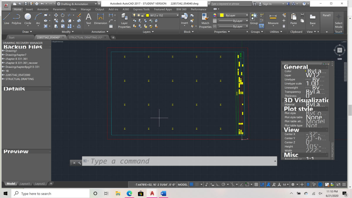

Rave Posted June 22, 2020 Posted June 22, 2020 Hello, I am having trouble with how the scaling looks like. I am still creating the I beam before i add it inside the title block. I wanted to understand if i did it right. As per the pdf says : "Units: Set the architectural units to 64ths. Use surveyor’s units for the system of angle measurement. " So I went to units, and under Length type: i set it to architectural and under precision i set it 0'-0 1/64". then i set the Angle : Type to surveyor units. Did i do it right? If i did it right, when i create the I beam, it looks extremely larger in comparison to the border/title block. I used the measurements I got from another thread here to make the I beam: W12x152 rough dimensions Depth = 13.71 Web thickness = 0.870 Flange width = 12.480 Flange thickness = 1.40 Source: Manual of Steel Construction, Allowable Stress Design, 9th edition AISC I created the array of I beams, but again its too large in comparison to the Border/title , so I tried to scale the I beam array to fit in side it and now the I beam looks like really small I's , what am i doing wrong , I am attaching picture for reference. the second picture with the array also shows the border/title block near the lower left corner of the array. Quote
Rave Posted June 22, 2020 Author Posted June 22, 2020 if I decide to scale the border/title to fit the i beams, it looks like this: Does this look right? Quote
BIGAL Posted June 22, 2020 Posted June 22, 2020 Its a pity the exercises have not been updated, it would be far more practical to use the Title in a layout and have a Model view at scale to suit. That's what layouts were made for. Quote

ReMark Posted June 22, 2020 Posted June 22, 2020 (edited) There are a number of threads relating to this project here at CADTutor. Have you read any of them? I am fairly sure that some of those threads also contain images of completed drawings. Regarding the title block and border. Once created it should be saved as a block and at a future point inserted into your drawings and scaled accordingly (usually up). Refer to pages 3 and 4 of your instructions. The image you included in your second post appears to be correct. Just one question. When you measure between column centerlines, horizontally or vertically, what do you get for a distance? It should be 18'-0" in either direction. Edited June 22, 2020 by ReMark Quote

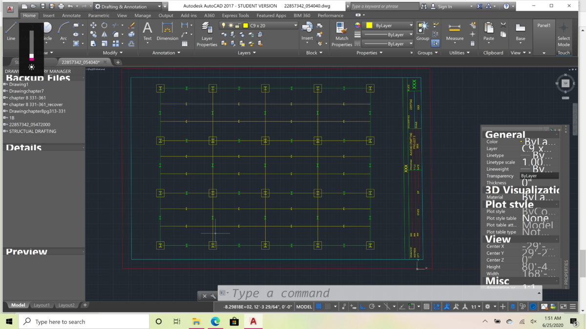

Rave Posted June 24, 2020 Author Posted June 24, 2020 I compare the drawings on plate 1 and i see that some of them have the girders and channel represented as I and C on the drawing while others have lines drawn. Which is correct way to represent? I made a girder with dimensions from appendix H and inserted it as an array between the beams. Here is how mine looks. I am planning to make the C channel and make it in array to insert horizontally in the bays. Again mine wont look like lines but letters. Am i doing it right? Quote
ReMark Posted June 24, 2020 Posted June 24, 2020 Sorry but on my computer I can barely see the columns and the footings in your drawing let alone anything else. Penn-Foster does not provide clear instructions on how the connecting beams and channels are to be shown on the drawing so I have seen them drawn in using the provided dimensions as well as drawn in using a single polyline with an assigned width (ex. - 4"). Since they are also going to be labeled with their correct designations I suppose it does not matter. Where I worked we used polylines with an assigned width between columns if we were doing 2D drawings. Quote

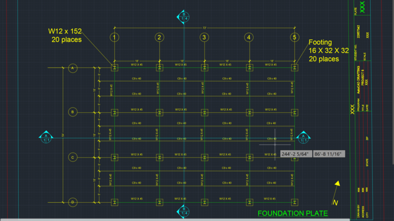

Rave Posted June 25, 2020 Author Posted June 25, 2020 Here is my most recent one. Do i need to show the Angle attached to the girder in a separate drawing beside this drawing? Quote
ReMark Posted June 25, 2020 Posted June 25, 2020 (edited) I would suggest you remove your drawing from the post above. Another student might decide to "borrow" your hard work. I wasn't aware that Penn-Foster required hand sketches. No previous student post has ever mentioned that requirement. No, you do not need to show the angle in the plan view of the building. Angles will be shown in a different drawing mainly in details. Edited June 25, 2020 by ReMark 1 Quote

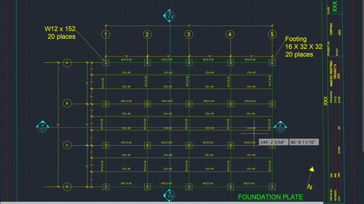

Rave Posted June 27, 2020 Author Posted June 27, 2020 (edited) Plate 1 done, going to plate 2. Here is my plate 1: any feedback welcome Edited June 27, 2020 by Rave Quote
ReMark Posted June 28, 2020 Posted June 28, 2020 I have the following comments. 1) The cyan colored section line should not pass through text if it can be avoided. 2) The size of the text in the bubbles for your column centerlines should be the same. It looks like the the numbers at the top are larger than the letters on the side. Pick one size (I prefer the size used for the numbers, but check your instructions). 3) I would break the dimension lines that pass through the bubbles labeled 1 & 5 as well as A and D so as to avoid them running through your text. 4) I would suggest adding a little more space between the dimensions at the top and the columns similar to what you did on the A thru D column centerlines. Otherwise, from what I can see the drawing meets the requirements as outlined. Quote
