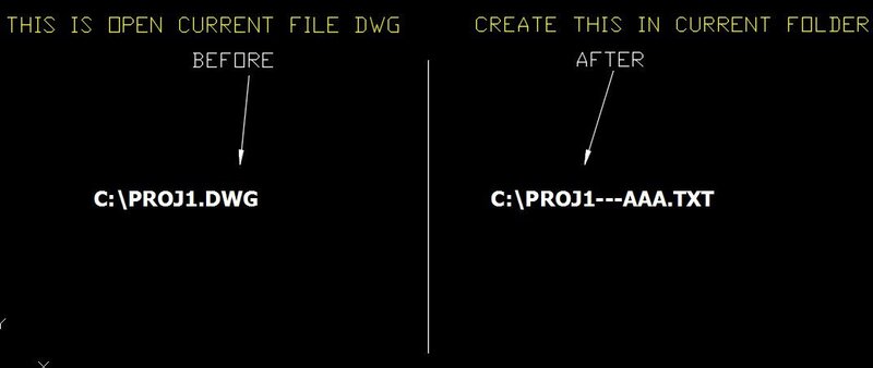

Hello guys
I need code lisp to create a empty file text in current folder as the following pic:
1-GET INPUT TEXT LIKE "AAA"
2-CREATE EMPTY TEXT FILE
thank you in advance for any helping.

Your now up to 300+ posts its time to do it yourself, you should be starting to know how by now.
  • Prompt the user for a string using the getstring function
  • Obtain the path of the current drawing using the DWGPREFIX system variable
  • Obtain the drawing filename using the DWGNAME system variable
  • Obtain the value of these system variables using the getvar function
  • Obtain the filename without the extension using the vl-filename-base function
  • Concatenate the filepath, filename, "---", user string, and ".txt" extension using the strcat function
  • Create the text file using the open function with the "w" argument (to open for writing)
  • Close the text file using the close function

HI TO ALL
APPRECIATE FOR ALWAYS AIDED, I LIKE YOU ALL SO MUCH.
I TRIED TO CREATE TILL*️⃣
(defun c:crytxt(/)
 (vl-load-com)
(setq AAA (getstRING "tell ---AAA"))           ;;;Prompt the user for a string using the getstring function
(setq PATHF (getvar "dwgprefix"))             ;;;Obtain the path of the current drawing using the DWGPREFIX system variable
(setq DWGN  (getvar "dwgNAME" ))                 ;;;Obtain the drawing filename using the DWGNAME system variable
                                      ;;;Obtain the value of these system variables using the getvar function
(setq DWGNNN (vl-filename-base DWGN)) ;;;Obtain the filename without the extension using the vl-filename-base function
(STRCAT PSTHF DWGN "---" AAA ".TXT"  );;;Concatenate the filepath, filename, "---", user string, and ".txt" extension using the strcat function
ANY RECOMAND !!!
if you're wondering why it showing the error.
; error: bad argument type: stringp nil
... you mispelled one variable at your strcat statment
and you are almost there..
Also this and fixed 3 errors you had 2 brackets at end and wrong filename.
(setq fname (STRCAT PATHF DWGNNNN "---" AAA ".TXT" ) "w")

Thank you to all with your guide this issue solved perfectly '
