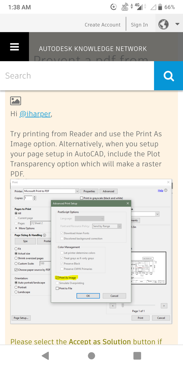

  On 6/19/2020 at 12:39 AM, Cad64 said:
Yes, there is software that can convert pdf's into CAD drawings. Even Autocad 2017 and above can do this.
This discussion may be of interest: https://forums.autodesk.com/t5/autocad-forum/prevent-a-pdf-from-being-converted-to-dwg/td-p/6758822
Expand
Thank you for the link... Went though the discussion.
Does this actually work!! I have my doubts.
Expand
I haven't tried it, but like I mentioned before, if someone wants to steal your design, they will convert it or trace it or reverse engineer it, and there's not a lot you can do about it unless you want to waste a lot of time and money fighting them in court. Just try to find honest companies to work with. I know that's easier said than done though. These days everyone wants something for nothing.
Expand
True...
Then, should I settle with this only!!
Let's see, what's others have to suggest.
There are no other suggestions, AutoCAD is designed as a collaborative software. If you are involved in the design of products it doesn't matter what you do to try and protect your designs it isn't fool proof. Just take a look at any object around you or picture in a magazine. I don't need to contact the designer to get the drawings if I want to copy it I will look for the easiest method that I can get away with. If someone is intent on not paying you then they won't pay. A contract is not just there to show in a court case at the ends of months of fighting, it is there at the initial start of a project to also see how a client reacts to it if they start by being difficult when you suggest a contract, even a simple one , then it should give you an idea of the type of people they are. Which are you more worried about not getting work because you approach it professionally or not getting work because you don't want to ask difficult questions.
