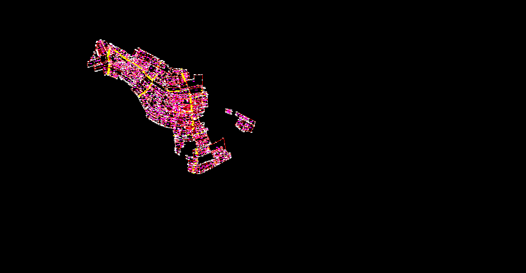

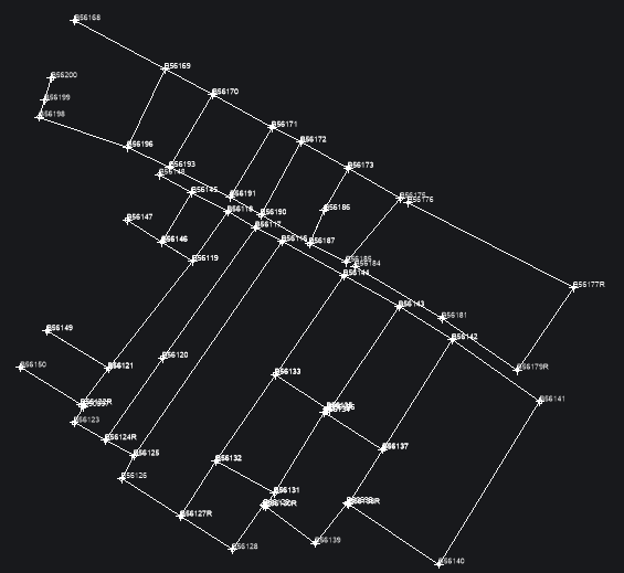

Galtar53 Posted June 16, 2020 Author Share Posted June 16, 2020 Good evening, dear friends, what I need is a lisp to import a file (* .txt) for several plots in the form of polygons on autocad. the structure of the file (* .txt) and as below: P118B425 212.744,77 223.283,86Br2 212.784,27 223.317,31Br3 212.815,88 223.344,28BR401 212.838,92 223.363,25B400 212.852,84 223.373,15B401 212.846,86 223.355,14B402 212.833,65 223.324,66B403 212.828,60 223.314,74B404 212.869,57 223.297,64B405 212.884,75 223.291,75B407 212.880,87 223.283,55B408 212.945,74 223.265,13B409 212.979,53 223.256,34B410 212.991,78 223.253,21B421 212.984,73 223.224,08B422 212869.16 223253.38B423 212863.66 223238.85B424 212803.73 223260.59 Pour nous donner le résultat suivants : cordialement Fichier1.TXT Quote Link to comment Share on other sites More sharing options...

BIGAL Posted June 17, 2020 Share Posted June 17, 2020 (edited) My $0.05 it could have layers etc but that is unknown same with Point as a block. 9546 points ? Entmake makes a huge difference compared to Command. ; https://www.cadtutor.net/forum/topic/70687-importer-fichier-dat-sur-autocad/ ; Read multiple points skip non xy points ; By AlanH info@alanh.com.au ; thanks to Lee-mac for this defun ; www.lee-mac.com ; 44 is comma ; 32 is a space (defun _csv->lst ( str del / pos ) (if (setq pos (vl-string-position del str)) (cons (substr str 1 pos) (_csv->lst (substr str (+ pos 2)) del)) (list str) ) ) (defun entpt ( ptxyz ) (entmake (list '(0 . "POINT") '(100 . "AcDbEntity") '(100 . "AcDbPoint") (cons 10 ptxyz) ) ) ) (defun entxt ( txt ) (entmake (list '(0 . "TEXT") '(100 . "AcDbEntity") '(100 . "AcDbText") (cons 10 pt) (cons 1 txt) '(40 . 2.5) '(50 . 0) '(73 . 0) ) ) ) (defun c:MyImportDatTest-2 ( / fp f ans pt txtans oldsnap) (setvar 'pdmode 34) (setvar 'pdsize 2) (setq oldsnap (getvar 'osmode)) (setvar "osmode" 0) (setq fp (getfiled "Select File:" "" "txt" 16)) (setq f (open fp "r")) (if fp (progn (while (setq newline (read-line f)) (setq ans (_csv->lst newline 32)) (if (= "B" (substr (car ans) 1 1)) (progn (setq pt (list (atof (cadr ans)) (atof(caddr ans)) 0.0)) (setq txtans (car ans)) (entpt pt) (entxt txtans) ) ) ) ) ) (close f) (setvar 'osmode oldsnap) (command "zoom" "e") (princ) ) (c:MyImportDatTest-2) Edited June 17, 2020 by BIGAL Quote Link to comment Share on other sites More sharing options...
Hippe013 Posted June 17, 2020 Share Posted June 17, 2020 Bigal, Lee Mac is a darn good programmer. I am aware of his functions. However, the example that you posted appears to have an error in the recursive call. (Too few arguments) I also don't feel that installing dos_lib would be over-bearing to anybody wanting to learn lisp, beginner or otherwise. Galter53, I have the following code that draws the polylines using the points in the file. I prefer using vla objects because it runs faster than using dxf codes and entmod. This version does use Bigal's recommendation of using Lee Mac's parsing function. (With the error corrected) (defun c:MyImportDatTest-3 () (setq flag 0) (setq fp (getfiled "Select File:" "" "txt" 16)) (setq pList nil) (if fp (progn (setq ms (vlax-get-property (vlax-get-property (vlax-get-acad-object) 'ActiveDocument) 'Modelspace)) (setq f (open fp "r")) (while (setq line (read-line f)) (setq tokens (_csv->lst line 32)) (if (= flag 0) (progn (princ (strcat "\nCurrent Position: " line)) (setq flag 1) ) (progn (if (= flag 1) (progn (princ (strcat "\nNumber of Points: " line)) (setq flag 2) ) (progn (if (= flag 2) (progn (if (= 3 (length tokens)) (progn (princ (strcat "\n " (nth 0 tokens))) (setq x (read (nth 1 tokens))) (setq y (read (nth 2 tokens))) (setq pList (append pLIst (list x y))) ) (progn (setq flag 0) (princ (strcat "\nCurrent Position: " line)) (setq flag 1) (setq pl-Obj (vlax-invoke-method ms 'AddLightweightPolyline (pl->var pList))) (vlax-put-property pl-Obj 'Closed :vlax-True) (setq pList nil) ) );End If token length = 3 ) );End If flag = 2 ) );End If flag = 1 ) );End If flag = 0 );End While ) );End If fp (princ) );End Defun (defun _csv->lst ( str del / pos ) (if (setq pos (vl-string-position del str)) (cons (substr str 1 pos) (_csv->lst (substr str (+ pos 2)) del)) (list str) ) ) (defun pl->var (pl / ub sa var) (setq ub (- (length pl) 1)) (setq sa (vlax-make-safearray vlax-vbdouble (cons 0 ub))) (setq var (vlax-make-variant (setq sa (vlax-safearray-fill sa pl)))) ) Let me know if this works for you. regards, hippe013 Quote Link to comment Share on other sites More sharing options...
BIGAL Posted June 17, 2020 Share Posted June 17, 2020 (edited) Hippe013 put the extra del into the code and changed the option for space or comma as per lees original code the second del got lost somewhere. Interesting is that it was working, Huh ? New code includes plines using entmake. Was not sure about closed , Trudy yes or no change (70 . 1) for closed or repeat 1st point as last point with (70 . 0) for those you want to appear closed. ; https://www.cadtutor.net/forum/topic/70687-importer-fichier-dat-sur-autocad/ ; Read multiple points skip non xy points ; By AlanH info@alanh.com.au ; thanks to Lee-mac for this defun ; www.lee-mac.com ; 44 is comma ; 32 is a space (defun _csv->lst ( str del / pos ) (if (setq pos (vl-string-position del str)) (cons (substr str 1 pos) (_csv->lst (substr str (+ pos 2)) del)) (list str) ) ) (defun LWPoly (lst cls) (entmakex (append (list (cons 0 "LWPOLYLINE") (cons 100 "AcDbEntity") (cons 100 "AcDbPolyline") (cons 90 (length lst)) (cons 70 cls)) (mapcar (function (lambda (p) (cons 10 p))) lst))) ) (defun entpt ( ptxyz ) (entmake (list '(0 . "POINT") '(100 . "AcDbEntity") '(100 . "AcDbPoint") (cons 10 ptxyz) ) ) ) (defun entxt ( txt ) (entmake (list '(0 . "TEXT") '(100 . "AcDbEntity") '(100 . "AcDbText") (cons 10 pt) (cons 1 txt) '(40 . 2.5) '(50 . 0) '(73 . 0) ) ) ) (defun c:MyImportDatTest-2 ( / fp f ans pt txtans oldsnap) (setvar 'pdmode 34) (setvar 'pdsize 2) (setq oldsnap (getvar 'osmode)) (setvar "osmode" 0) (setq fp (getfiled "Select File:" "" "txt" 16)) (setq f (open fp "r")) (if fp (progn (setq lst2 '()) (while (setq newline (read-line f)) (setq ans (_csv->lst newline 32)) (if (= "B" (substr (car ans) 1 1)) (progn (setq pt (list (atof (cadr ans)) (atof(caddr ans)) 0.0)) (setq lst2 (cons pt lst2)) (setq txtans (car ans)) (entpt pt) (entxt txtans) (setq pl "Y") ) (progn (if (= pl "Y") (LWPoly lst2 0) ) (progn (setq pl "N") (setq lst2 '()) ) ) ) ) (LWPoly lst2 0) ) ) (close f) (setvar 'osmode oldsnap) (command "zoom" "e") (princ) ) (c:MyImportDatTest-2) Edited June 18, 2020 by BIGAL Quote Link to comment Share on other sites More sharing options...
