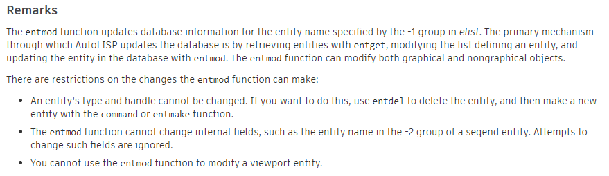

EDIT: tried it with Viewports, somehow it doesnt respect entmod for changing the layer.  Ended up using VLA-PUT-LAYER instead of  this:
(entmod (subst	(Cons 8 nly)
			(assoc 8 (entget el))
			(entget el)
You guys have any idea why is that?
Edited by pBe
Hi,
From the help document and note the last sentence. :)
ENTMOD FUNCTION
  • Like 2
Thats good to know Tharwat
Thank you for that valuable information. 👍
