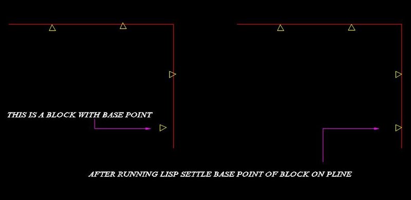

is there anyway in lisp to settle base point of closest block on pline . we define the max distance around pline and after running code settle them on pline.
we select plines and run it.

Very simple use "getclosestpointto" just take insert point of block, get other point then move or update insert point.
Lots of code examples around google.
(setq newpt (vlax-curve-getclosestpointto obj inspt))
