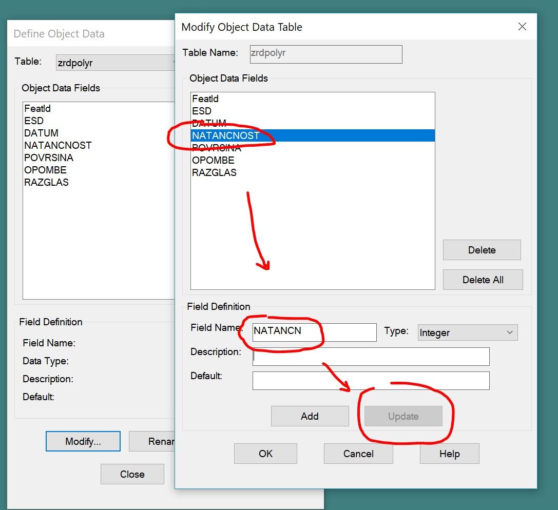

Jest Posted June 11, 2020 Posted June 11, 2020 (edited) In my drawing, using Autocad Map 3d 2021, I cannot rename Object Data Field Name. In "Define Object Data" I normally select my Table, then click "Modify", then I select Object data field in which I wish to rename its Field name. But when I change Field Name, button "Update" is inactive...it's colour remains gray and cannot click on it. It is possible to rename Description but not Field Name! Why? Is it possible at all? Edited March 26, 2021 by Jest 1 Quote

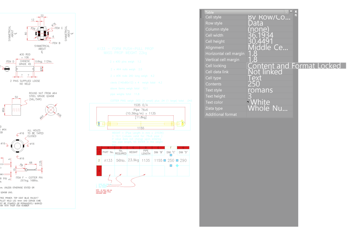

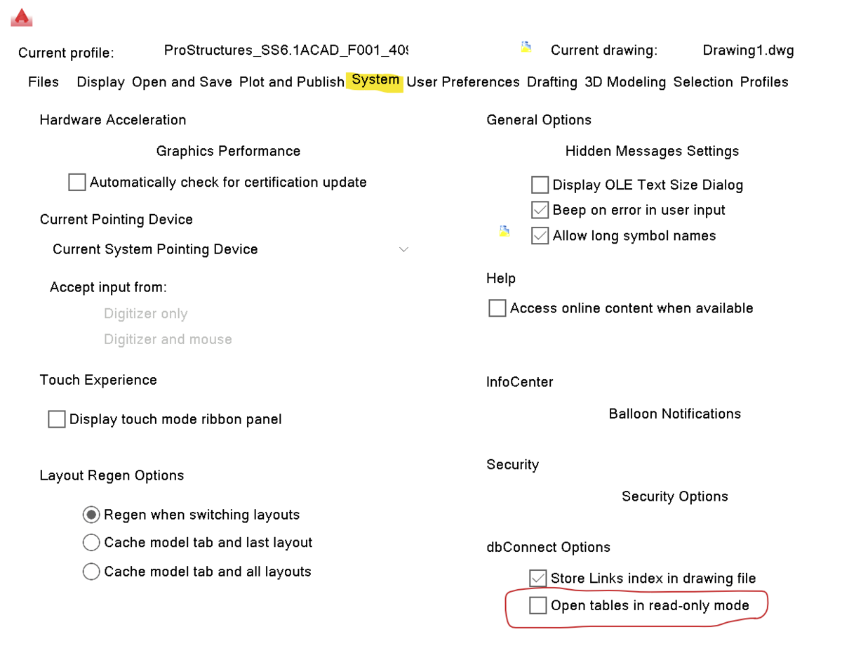

Dadgad Posted June 11, 2020 Posted June 11, 2020 (edited) I have never used Map 3D, but I have created and edited lots of Tables in Vanilla AutoCAD and ProSteel. It sounds like the Table, or the Cells are LOCKED? In AutoCAD in OPTIONS on the SYSTEM tab once is able to Open tables in read-only mode? Might you have a similar setting available and checked in your OPTIONS? Edited June 11, 2020 by Dadgad second suggestion Quote
