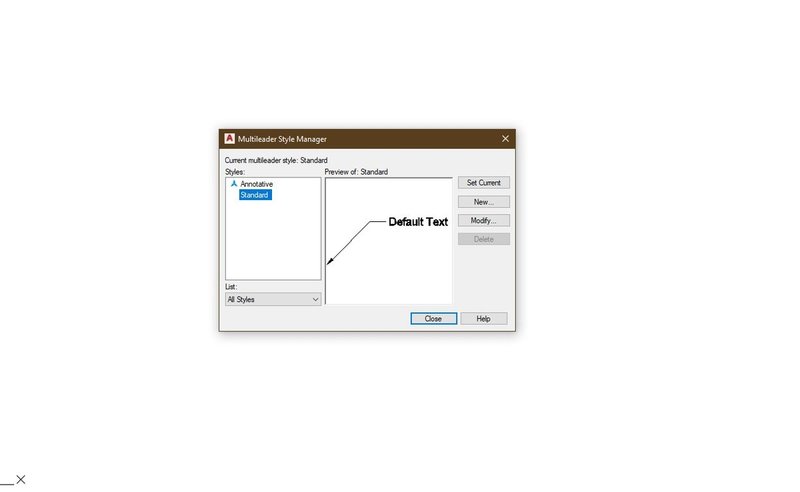

Hi all i am facing one problem that one of my lsp program is starting whenever i start my autocad and problem is i am unable to found out which lsp is that, can anbody help me to disable this on startup

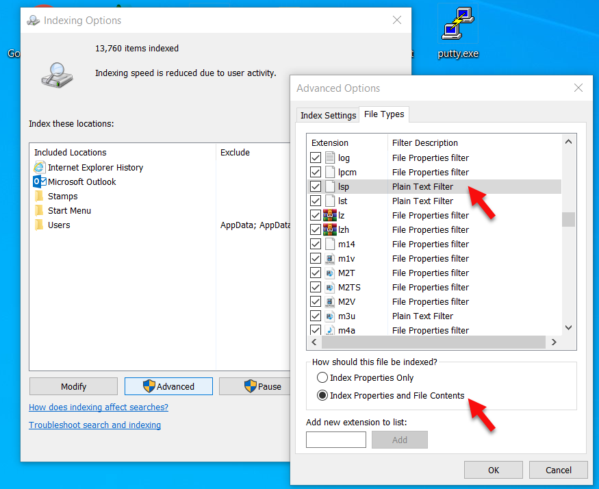

2 hours ago, pmadhwal7 said:
tried but not working...
Do you have your *.lsp index set to "Index Properties and File Contents" ?
