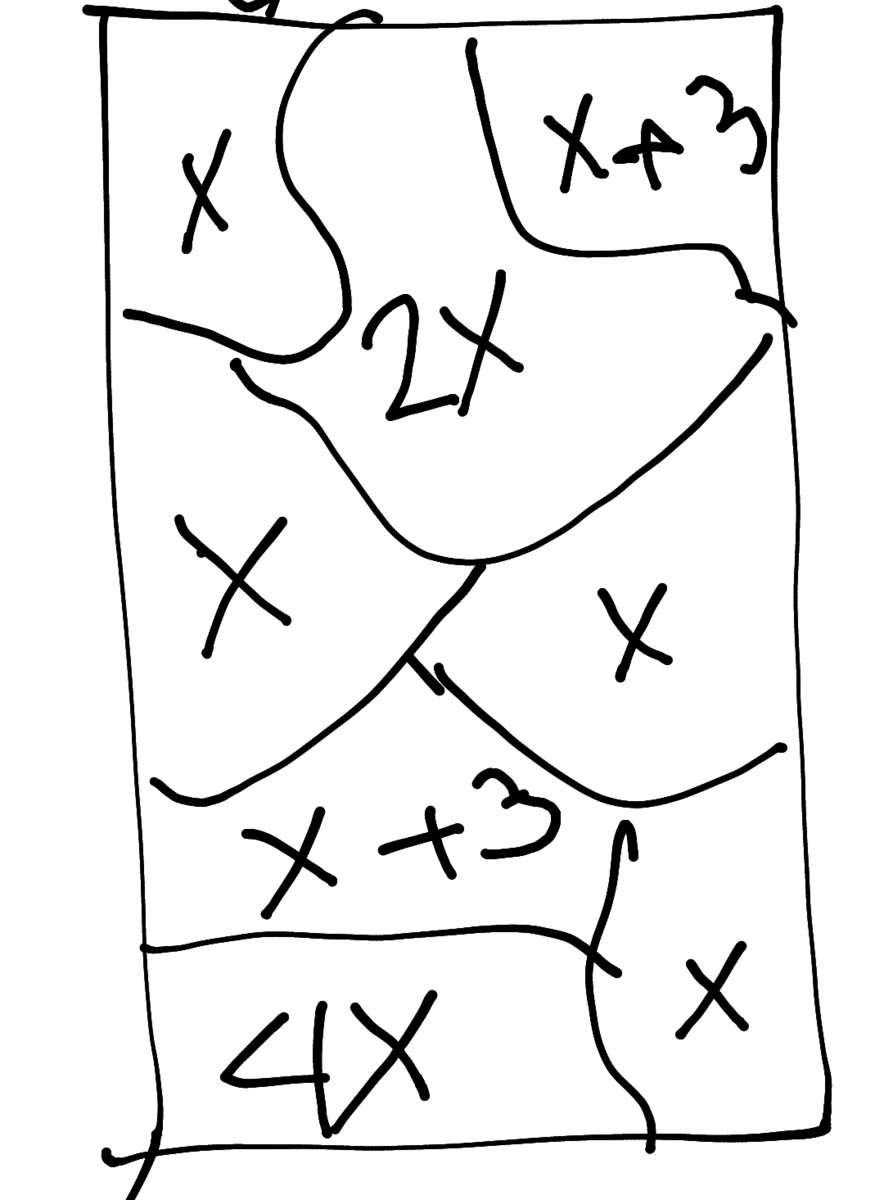

The following code are apart of lisp code for replacing text in  drawing.i would like to change it for replacing text in current sellection set of drawing.

any help for adding or modifiying it🙄

the major point is that we get some project in the day and must modify them the following pic is simplified instance with just x parameter.
if we want find and replace for more parameter like x,y,... by lisp code. which command you offer??
