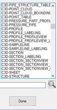

Hello everybody,
Usualy, i create my own lisps and when i get stuck i ask for help.
But in this case i got an other type of problem.
We used to have a plug-in that we used to create layers from an excelsheet to AutoCAD.
The developer has stopped the support of this tool and now, we cannot use it anymore.
I managed to create a LSP-code that wil create a layer with the right settings from an EXCEL-database into the DWG.
Now i am looking for a way to give the users a selection methode to pick the layer they want to be created.
I am thinking of a DCL-format, where i get a scrollable list with all my layer names, and a simple button that wil execute 'my' command to create that layer.
That should look something like this, where the user can select a layername, and press a button, that wil execute command: (CREATENEWLAYER "<layername>")
The list could be generated from a (setq layerlist (list "layer1" "layer2" "layer3"), i can make the translation from the excel to that format.
BUT...
I have never done anything with DCL, and to the honest, i find it hard to learn DCL.
We are in pretty need of a tool like this, so i am realy hoping somebody can help me fix this last piece of my puzzle...

; choose from list
(defun cfl (l / f p d r)
  (and (setq p (open (setq f (vl-filename-mktemp ".dcl")) "w"))
       (princ "cfl:dialog{label=\"Choose\";:list_box{key=\"lb\";}ok_cancel;}" p)
       (not (setq p (close p)))(< 0 (setq d (load_dialog f)))(new_dialog "cfl" d)
         (start_list "lb")(mapcar 'add_list l)(end_list)
         (action_tile "lb" "(setq r (nth (atoi $value) l))(done_dialog 1)")
         (action_tile "accept" "(setq r (get_tile \"lb\"))(done_dialog 1)")
         (action_tile "cancel" "(setq r nil)(done_dialog 0)")
         (start_dialog)(unload_dialog d)(vl-file-delete f)
  (cond ((= r "") nil)(r r)(t nil))
(defun c:t1 ( / lay-list)
  (setq lay-list '("layer1" "layer2" "layer3"))
  (if (setq inp (cfl lay-list)) (alert (strcat "You selected " inp))(alert "You cancelled"))

Thanks for the quicky!
This was just what i needed. 🙂
