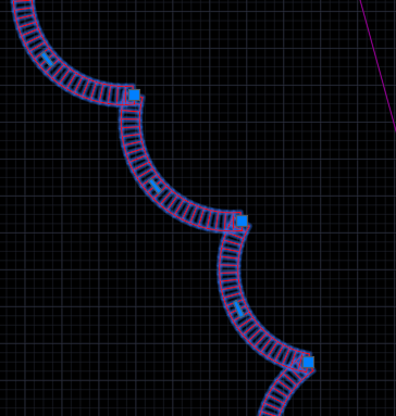

This is a cloud made from a polyline. Can someone tell me why it is not filled in?
Is your 'FILLMODE' set to 1?
Yes
What is your visual style?
2D Wireframe. I have tried switching it in the properties box but nothing changed.
Are you viewing the polyline from a rotated view? This will result in polylines appearing unfilled like what you're showing. Switch your view to "Top" and the polyline should appear filled.
  • Thanks 1
That solved it. Thanks!
