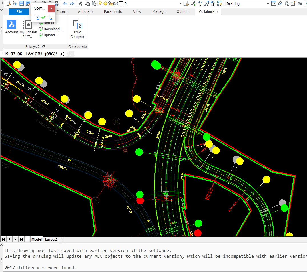

I've tested BCAD's DWGCOMPARE, quite easy, it highlight objects with different color!
