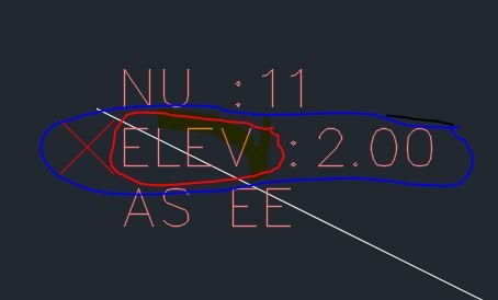

hosneyalaa Posted May 28, 2020 Posted May 28, 2020 (edited) Sorry English is not good Hello all AND Roy_043 If possible, help with a small change In the LISP By choosing the type that contains the height He did not succeed with the change I have a reference block containing 1. number 2 - height3. Description ;;https://www.cadtutor.net/forum/topic/66770-help-for-creating-a-point-from-reference-block/ (defun KGA_Conv_Pickset_To_ObjectList (ss / i ret) (if ss (repeat (setq i (sslength ss)) (setq ret (cons (vlax-ename->vla-object (ssname ss (setq i (1- i)))) ret)) ) ) ) (defun GetLevel (nme blksObj oldtxtstr / out) (vlax-for obj (vla-item blksObj nme) (cond (out);1 ((/= "V-NODE-TEXT" (strcase (vla-get-layer obj))) nil );2 ((= "AcDbBlockReference" (vla-get-objectname obj)) (setq out (GetLevel (vla-get-name obj) blksObj)) );3 ((not (vlax-property-available-p obj 'textstring)) nil );4 ((wcmatch (vla-get-textstring obj) (strcat "*"oldtxtstr"*")) (setq out (vla-get-textstring obj)) );5 );COND ) ) (defun c:CreatePoints ( / blksObj doc pt spc ss oldstr) (setq doc (vla-get-activedocument (vlax-get-acad-object))) (setq blksObj (vla-get-blocks doc)) (vla-endundomark doc) (vla-startundomark doc) (SETQ oldstr (getstring "\n-> INTER NAME ELEVATION :"));ELEV (if (setq ss (ssget '((0 . "INSERT") ))) (progn (setq spc (vla-get-modelspace doc)) (foreach obj (KGA_Conv_Pickset_To_ObjectList ss) ;;; (setq obj (CAR(KGA_Conv_Pickset_To_ObjectList ss))) (setq pt (vlax-get obj 'insertionpoint)) (vla-addpoint spc (vlax-3d-point (list (car pt) (cadr pt) (CADR (LM:parsenumbers(GetLevel (vla-get-name obj) blksObj oldstr)))))) ) ) ) (vla-endundomark doc) (princ) ) ;http://www.lee-mac.com/parsenumbers.html ;; Parse Numbers - Lee Mac ;; Parses a list of numerical values from a supplied string. (defun LM:parsenumbers ( str ) ( (lambda ( l ) (read (strcat "(" (vl-list->string (mapcar '(lambda ( a b c ) (if (or (< 47 b 58) (and (= 45 b) (< 47 c 58) (not (< 47 a 58))) (and (= 46 b) (< 47 a 58) (< 47 c 58)) ) b 32 ) ) (cons nil l) l (append (cdr l) '(())) ) ) ")" ) ) ) (vl-string->list str) ) ) 0-civil points nove01EP.dwg Edited May 28, 2020 by hosneyalaa Quote

Roy_043 Posted May 29, 2020 Posted May 29, 2020 (edited) @BIGAL I don't understand why you describe a problem that is already handled by the original code. Compared to the previous discussion two new problems have been introduced: The text that needs to be read contains mtext formatting. IMO using mtext formatting here makes no sense at all. After removing the formatting, the text has to be parsed to find the actual numerical value. Edited May 29, 2020 by Roy_043 Quote
hosneyalaa Posted May 29, 2020 Author Posted May 29, 2020 (edited) HI ALL Roy_043 AND BIGAL The problem with this line only when I write "*ELEV*" directly work LISP fine ((wcmatch (vla-get-textstring obj) "*ELEV*") (setq out (vla-get-textstring obj)) ((wcmatch (vla-get-textstring obj) "*ELEV*") (setq out (vla-get-textstring obj)) But When I want to a variable depending on what the user enters, it does not work Thank you ((wcmatch (vla-get-textstring obj) (strcat "*"oldtxtstr"*")) (setq out (vla-get-textstring obj)) (defun GetLevel (nme blksObj / out) (vlax-for obj (vla-item blksObj nme) (cond (out);1 ((/= "V-NODE-TEXT" (strcase (vla-get-layer obj))) nil );2 ((= "AcDbBlockReference" (vla-get-objectname obj)) (setq out (GetLevel (vla-get-name obj) blksObj)) );3 ((not (vlax-property-available-p obj 'textstring)) nil );4 ((wcmatch (vla-get-textstring obj) "*ELEV*") (setq out (vla-get-textstring obj)) );5 );COND ) ) Edited May 29, 2020 by hosneyalaa Quote
Roy_043 Posted May 29, 2020 Posted May 29, 2020 The proposed LM:parsenumbers function can actually be used to solve both new problems: (defun KGA_Conv_Pickset_To_ObjectList (ss / i ret) (if ss (repeat (setq i (sslength ss)) (setq ret (cons (vlax-ename->vla-object (ssname ss (setq i (1- i)))) ret)) ) ) ) (defun GetLevel (nme blksObj / out) (vlax-for obj (vla-item blksObj nme) (cond (out) ((/= "V-NODE-TEXT" (strcase (vla-get-layer obj))) nil ) ((= "AcDbBlockReference" (vla-get-objectname obj)) (setq out (GetLevel (vla-get-name obj) blksObj)) ) ((not (vlax-property-available-p obj 'textstring)) nil ) ((wcmatch (vla-get-textstring obj) "*#.#*") (setq out (last (LM:parsenumbers (vla-get-textstring obj)))) ) ) ) ) (defun c:CreatePoints ( / blksObj doc pt spc ss) (setq doc (vla-get-activedocument (vlax-get-acad-object))) (setq blksObj (vla-get-blocks doc)) (vla-endundomark doc) (vla-startundomark doc) (if (setq ss (ssget '((0 . "INSERT")))) ; Removed layer filter. (progn (setq spc (vla-get-modelspace doc)) (foreach obj (KGA_Conv_Pickset_To_ObjectList ss) (setq pt (vlax-get obj 'insertionpoint)) (vla-addpoint spc (vlax-3d-point (list (car pt) (cadr pt) (GetLevel (vla-get-name obj) blksObj)))) ) ) ) (vla-endundomark doc) (princ) ) 1 Quote
