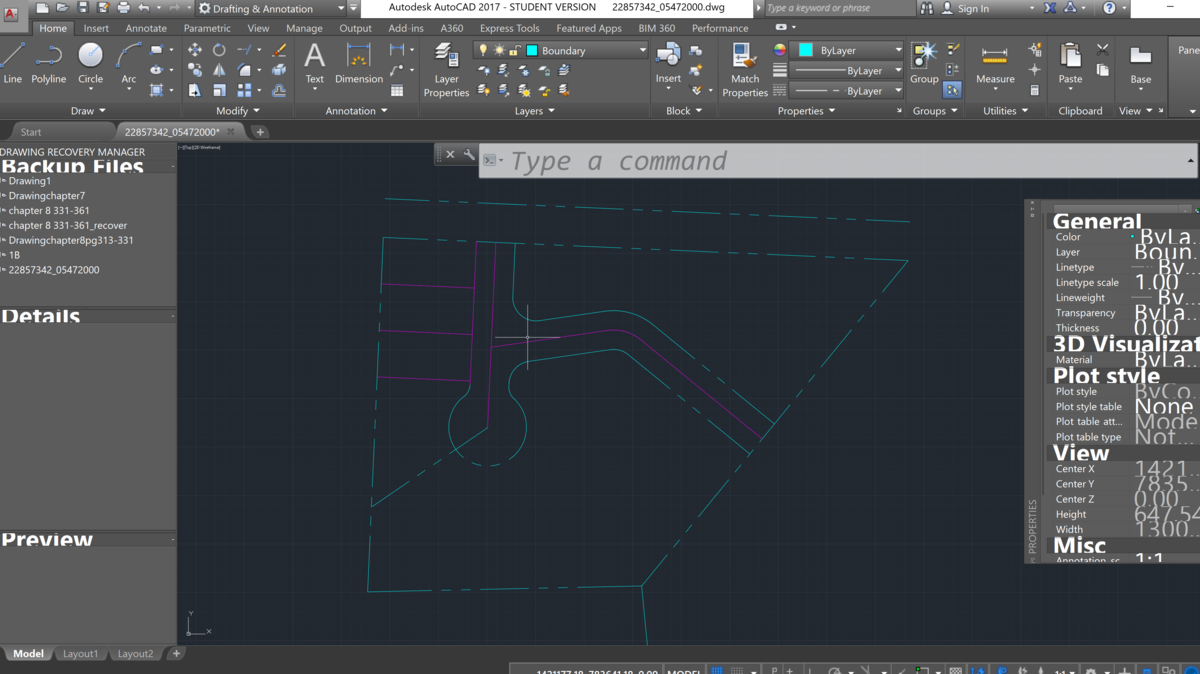

Rave Posted June 2, 2020 Author Share Posted June 2, 2020 @ReMarki am trying to create Lot 5:should i follow similar steps from creating Lot 4: here i need to draw a circle with radius of 69.10 , center point at the west end of the southern property line of Lot4? I am trying to follow your reply to a previous thread (dec 7, 2012) to "Autocad Student-Apprentice" where you drew circles. How did you draw the red circle of Lot 4 ? what radius is it? i have attached your answer to a previous thread , and i would like to know the measurement to draw the circles. i have also attached a png file of my work till now. Quote Link to comment Share on other sites More sharing options...

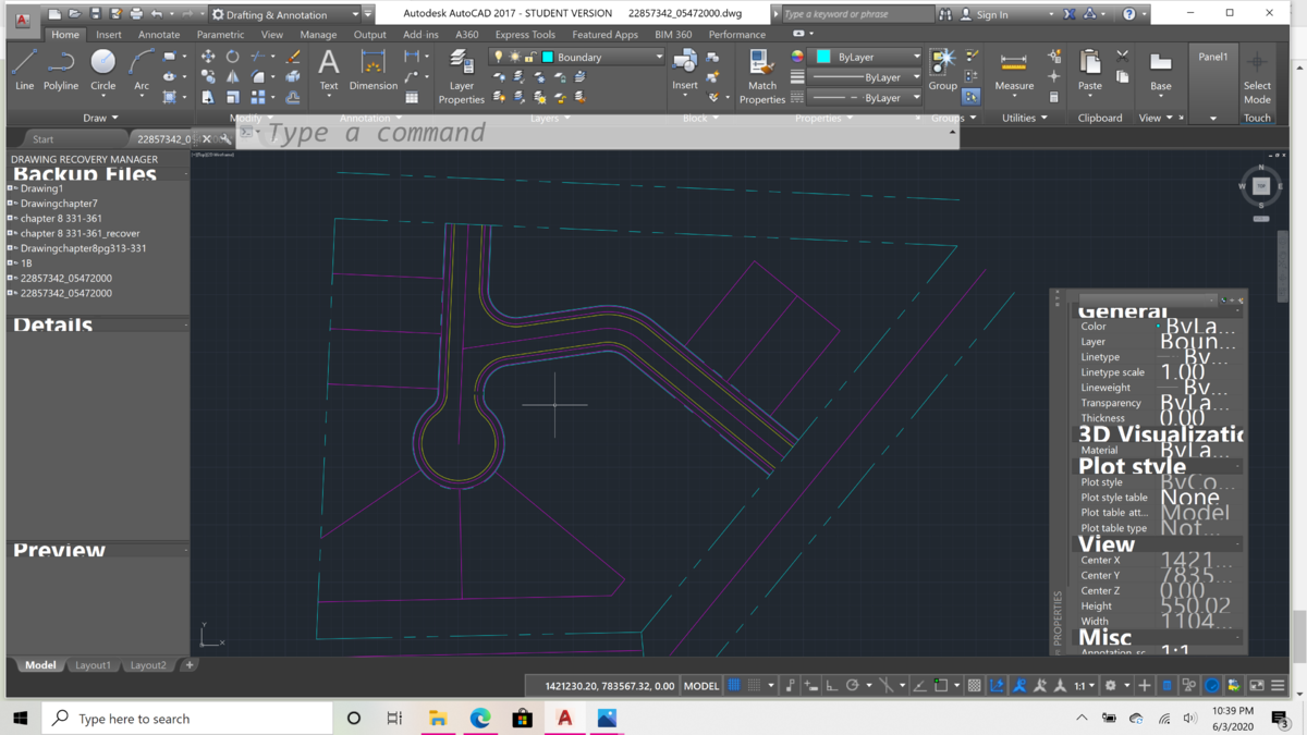

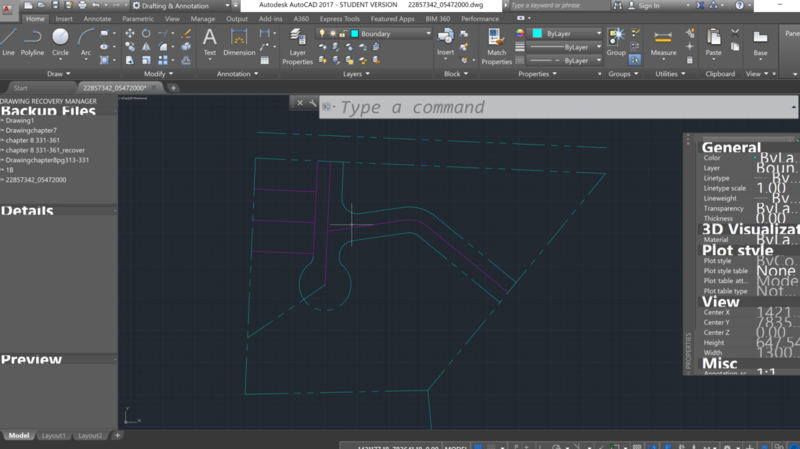

Rave Posted June 2, 2020 Author Share Posted June 2, 2020 @ReMarkI am trying to draw the two additional streetlines and centerlines for Kensignton Place and SW Oleson Road. I didnt see where the width of it is given in the document. I am attaching my recent work. Also the buffer/sidewalk and curb for the first cul de sac (the one that connects lot 1,2,3,4,5,6), whats the dimensions for offsetting it? Quote Link to comment Share on other sites More sharing options...
ReMark Posted June 2, 2020 Share Posted June 2, 2020 The width of SW Kensington Place is listed as 40 feet. The width of SW Oleson Road R.O.W. is listed as 80 feet. The offsets you are asking about are 1 foot (curb), 3 foot (parking strip) and 6 foot (sidewalk) for a total of 10 feet. Quote Link to comment Share on other sites More sharing options...

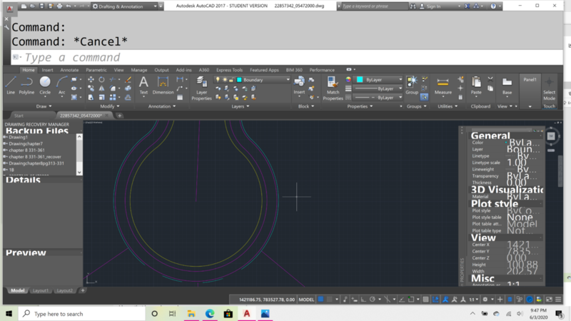

Rave Posted June 3, 2020 Author Share Posted June 3, 2020 Thank yoy @ReMark ! I would like to clarify the offsets for curb, parking strip and sidewalk that you mentioned above. Was that for the first cul de sac? i was looking through the image you posted in the old thread: attaching below Quote Link to comment Share on other sites More sharing options...
ReMark Posted June 3, 2020 Share Posted June 3, 2020 That's for both roads. And let me clarify something. The offsets fall inside the streetlines (also referred to as the R.O.W. lines). So. it is 1 foot between the streetline and the back of the sidewalk. Then 6 feet for the sidewalk itself and finally 3 feet for the parking strip as shown in the above image. 1 Quote Link to comment Share on other sites More sharing options...

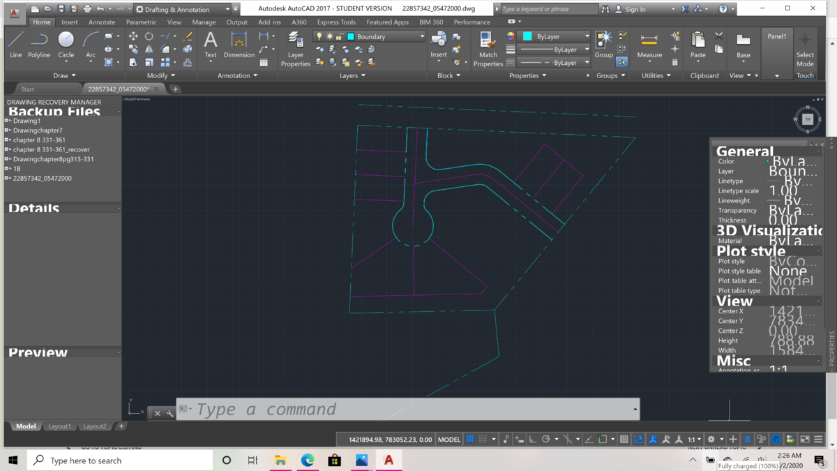

Rave Posted June 4, 2020 Author Share Posted June 4, 2020 Got it ! Thanks a lot ! I was reading through your replies on that thread and I saw your comment about the offsets falling inside the street lines. Does this look ok? the parking strip should be on the border Layer with yellow right? Quote Link to comment Share on other sites More sharing options...

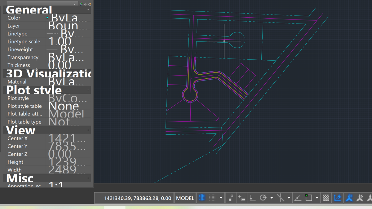

Rave Posted June 4, 2020 Author Share Posted June 4, 2020 (edited) I have another question , what is the coordinate at which the SW Davies Court starts from SW 85th Avenue? Edited June 4, 2020 by Rave My drawing shows there is no space to draw this SW Davies Court anywhere with its cul de sac and all. When i compared my drawing, i also noticed that I had offset the Alden st (i dont know where i saw that info but it is not enough to insert the SW Davies Quote Link to comment Share on other sites More sharing options...
Rave Posted June 4, 2020 Author Share Posted June 4, 2020 is this how it should be looking? i am inserting your drawing from previous thread for comparison with mine in my reply above Quote Link to comment Share on other sites More sharing options...
Rave Posted June 4, 2020 Author Share Posted June 4, 2020 okay I got far from the previous question and now i am trying to draw the SW Washington st, its width is 50 and it starts at the benchmark, but i am trying to see how much the length is and cant find that info anywhere on the pdf. Could you please tell me? attaching my updated work: Quote Link to comment Share on other sites More sharing options...
ReMark Posted June 4, 2020 Share Posted June 4, 2020 You are right, there is no length given. The student can make it any length they want. Quote Link to comment Share on other sites More sharing options...

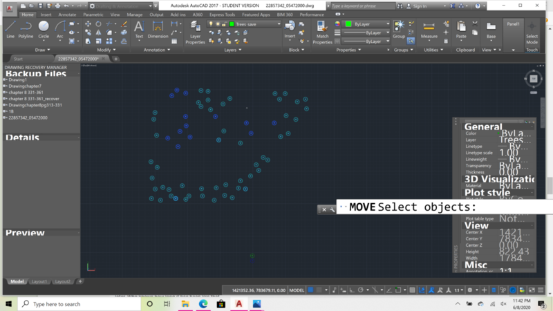

Rave Posted June 5, 2020 Author Share Posted June 5, 2020 @ReMark Thank you ! I am now going to add the tree blocks. Wish me luck since that procedure seems daunting Quote Link to comment Share on other sites More sharing options...
