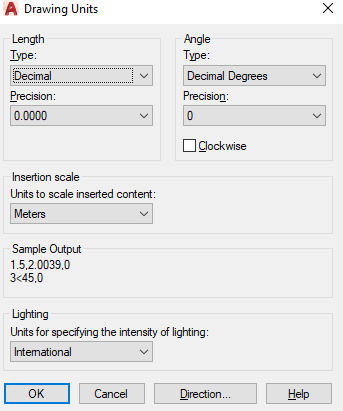

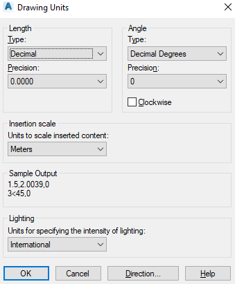

rog1n Posted May 21, 2020 Posted May 21, 2020 Hi, always when I search about a question I found rotines write by Lee Mac hehehe. I trying to insert a dynamic block with preset visibility so I used the code below ( LM:insertwithstate ( blk vis bse cmd def ent ext new obj pth rtn tmp ) ( pth ( ( blk)) ext ( (( blk)) ()) bse ( blk) ) ( ( pth) ( pth ( pth )) ) ( ( ( ( ( ( bse) ( blk bse) ) ( blk ( ( pth bse ext))) ) ) ( ( bse )) ) ( ( ( obj ( ( (LM:acdoc) ( ( 1 ( 'cvport)) 'paperspace 'modelspace ) ) 'insertblock '(0.0 0.0 0.0) blk 1.0 1.0 1.0 0.0 ) ) ( obj ) ( ( obj)) ) ( obj) ( ( bse )) ) ( ( (LM:setvisibilitystate obj vis)) ( obj) ( ( bse vis ) ) ) ( ( tmp 0) ( ( ( blk ( ( ( tmp ( tmp)))) ) ) ) ( ( ( (LM:acdoc) 'copyobjects ( obj) ( def ( ( (LM:acdoc)) 'add '(0.0 0.0 0.0) blk ) ) ) ) ) ( obj) ( ent () cmd ( 'cmdecho) ) ( 'cmdecho 0) ( ) ( ( ( blk 1.0 0.0 ) ( ( ent ( ent ()))) ( new ( ent)) ( ( new)) ) ( ( rtn ( ( new 'explode))) ( new) ) ) ( 'cmdecho cmd) ( ' ( def)) ) ) rtn ) ( LM:getvisibilityparametername ( blk vis ) ( ( ( blk 'effectivename) ( blk ( ( ( blk)) ( blk) ) ) ( ( blk)) ( ( blk)) ( vis ( '( ( pair ) ( ( ( 360 ( pair)) ( ( ( 0 ( ( pair)))) ) ) ( pair) ) ) ( ( ( blk)) ) ) ) ) ( ( 301 ( vis))) ) ) ( LM:SetVisibilityState ( blk val vis ) ( ( ( vis (LM:getvisibilityparametername blk)) ( ( val) ( ' (LM:getdynpropallowedvalues blk vis)) ) ) (LM:setdynpropvalue blk vis val) ) ) ( LM:acdoc ( ( ' 'LM:acdoc ' ( ()) ) ) (LM:acdoc) ) () () But I found a strange result, on Autocad 2018 when I insert a block the scale of block is set to: Scale X: 0.001, Scale Y: 0.001 and Scale Z: 0.001, but on Autocad Civil 3D 2018 the Scale are 1, anyone know why this happens? I attached a example of block this happens test.dwg Quote

rog1n Posted May 21, 2020 Author Posted May 21, 2020 (edited) On 5/21/2020 at 3:57 PM, Lee Mac said: That code looks to be seriously mutilated... Original posts here, here & here. As for your question, check the insertion units in your drawings. Thank you for you reply Lee, I got the exactly code from the first link (maybe my CTRL+C>CTRL+V to the forum bug the code). All drawing units are in meters. you can check below. Autocad 2018 Autocad Civil 3D 2018 edit: I found the problem on my Autocad 2018 the variable INSUNITSDEFTARGET was set to 4, thank you again Lee. Edited May 22, 2020 by rog1n Quote
