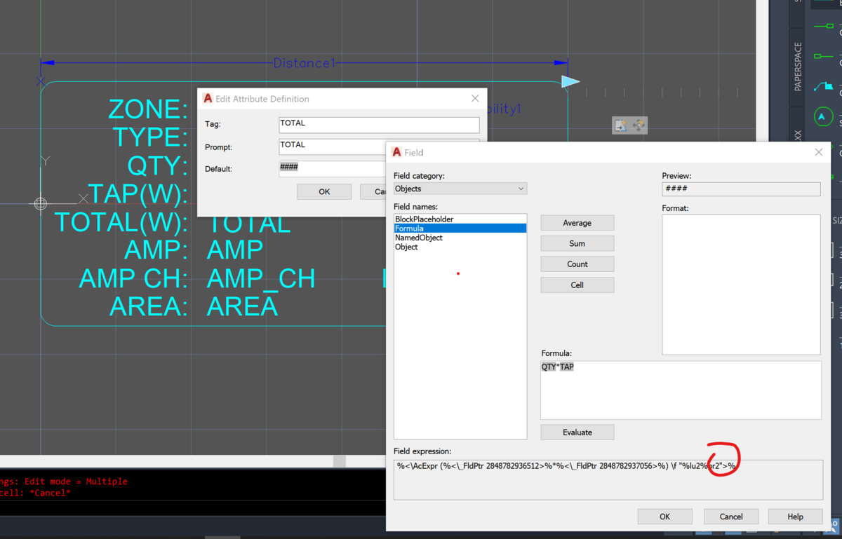

I have a block with a field as an attribute that's multiplying two other attributes. It always multiplies to a whole number, but the precision is set to two decimal places. I can not seem to find out how to fix this. It's staring right at me in the Field Expression, but as far as I know, this isn't editable. Any help?
Can not see the atts are they a integer no decimals may explain ?
Post a dwg.
As far as I know fields use the system precision 'units'. But what are the properties you have used for the fields in the formula, I would expect to see a number there for the value and not the Tag of an attribute (ie. the field property should be 'value'). Can you post a copy of the block? or show us the field  dialogue for one of the fields from the formula. There are no details showing inside the 'Format' section you should be able to choose between decimal, architectural, etc. and be able to set the precision from there independantly.

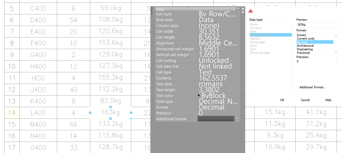

That sounds about right, like you would be able to, if it were a cell in a Table.

@steven-g There are no values because it's multiplying two other fields, which are defined from other attributes. And I tried updated the UNIT precision, nothing.
@Dadgad That's what everyone keeps pointing to, the properties. But because I have to open the attribute editor first, there's no way to get to the properties by the time I select the field, if that makes sense.

To get an attribute field formula to read other attributes does require a trick and some rules
1) the 'total' attribute has to have the property 'preset' =yes so that it doesn't prompt for a value on insertion and overwrite the field
2) when inserting the fields the tickbox in the attribute editor for 'use block value' has to be ticked
3) and this is the trick - the block has to have a dynamic action carried out once inserted to make it an annonymous block so that the formula will read the values in that block rather than from the block definition, the easiest way is to use a visibility state and hide the total attribute for the state that is used on insert.
In your block you already have a visibility state with 'OFF' being the default so the total attribute needs to be hiden for that state but visible to all the others, I just added a new visibility state 'Total'
When you first insert the block fill in your values then change the visibility state to one of the other values and do a regen so that the fields can update.
As for the precision once you have added the 'two fields in the formula press the 'evaluate' button and you should then get the chance to select decimal and adjust the precision.

3. We always just REGEN when we're all done. Quickest way to get everything to re-read. And What does the TOTAL VS do? We already have OFF where the total attribute is hidden, and it's visible in all the other VS... so I'm confused on this one?
The EVALUATE button doesn't change anything.
2.
3. The total visibility state is only there because I didn't know wether you always switch to a visibility state once the block is inserted, and 'total' just keeps the same visual settings as 'OFF' but the important point is you MUST make a dynamic alteration to the block once inserted before the 'total' attribute will work, if you always select a different visibility state then ther is indeed no need for 'total'
That box is definitely ticked.
And thanks for the visual... I haven't had enough coffee this morning, so that helped.

The field expression can be copied out to notepad. Change the 2 to whichever precision you want. Copy that new field expression and paste into your attribute instead. That becomes the field with the desired precision.
