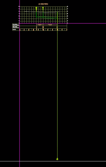

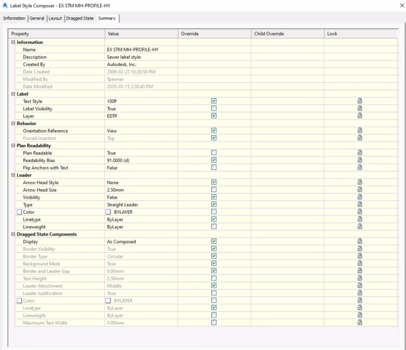

Silvercloak Posted May 15, 2020 Share Posted May 15, 2020 Hi all, Got a question, sometimes Civil3d labels baffle me. I've got Manhole tags here, the first two look ok because I've had to drag and tweak them to set it properly. But originally they started out exactly like the third label there. I've tried changing the anchor point but maybe I'm doing something wrong. Is there a way to get it to at LEAST snap closer to the manhole instead of trying to reach the center of the earth here? Posted the summary, if you need more detail for how the label was made let me know. Silvercloak Quote Link to comment Share on other sites More sharing options...

CyberAngel Posted May 18, 2020 Share Posted May 18, 2020 I believe there is a default value for the elevation of those labels. It's like inserting a block and leaving the Specify On-Screen box unchecked, it winds up somewhere you didn't expect. Sorry, I don't have Civil 3D now, so I can't tell you exactly where to look. Maybe check the properties of the object(s) before drawing the profile. Quote Link to comment Share on other sites More sharing options...

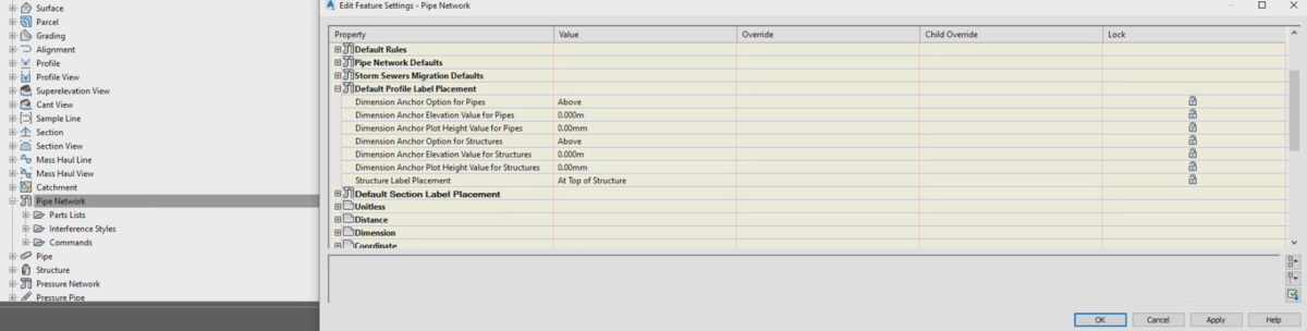

Silvercloak Posted June 12, 2020 Author Share Posted June 12, 2020 Solved. It's tucked away in settings. The last place I'd look. Gotta right click on Pipe Network and voila... Now if only I could figure out how to get it to anchor the MH # bubble to top of the MH and the inverts to the bottom - but I can live with this. Quote Link to comment Share on other sites More sharing options...
