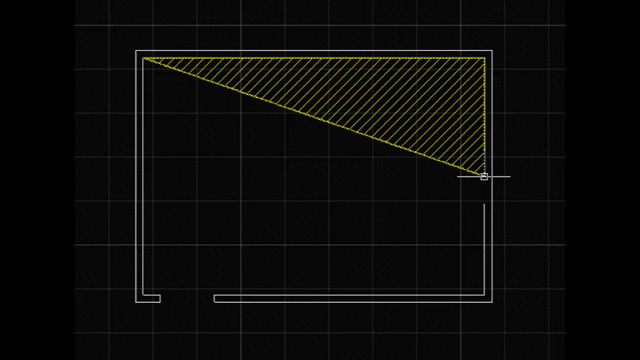

carmelo Posted May 11, 2020 Share Posted May 11, 2020 Hi all! With a little imagination and sweeping around, I have been able to create a routine to get the area. (defun c:ap (/ area e1 text) (command "PLINE" ) (setq area (vla-get-area (vlax-ename->vla-object (entlast)))) (setq e1 (entlast)) (command "-ERASE" e1 "") (princ "\nArea: ") (princ (rtos area)) (vl-load-com) (princ) ) The first and simple question is: How can i set the polyline width to, i.e., 0.02 and when i finish the lisp i reset the width to 0? The second and, maybe, more complex question is: Is it possible to fill "dynamically" the polyline, vertex by vertex? I hope the second question is clear. Thank you very much C Quote Link to comment Share on other sites More sharing options...

carmelo Posted May 13, 2020 Author Share Posted May 13, 2020 10 hours ago, BIGAL said: Try this forgot to hit post yesterday (defun c:ap (/ area e1 text) (setvar 'plinewid 0.2) (princ "\nPick pline points press c to close ") (command "PLINE" ) (while (= (getvar "cmdactive") 1 ) (command pause)) (setq area (vla-get-area (vlax-ename->vla-object (entlast)))) (command "-hatch" "s" (entlast) "" "p" "Ansi31" 1 0.0 "") (alert (strcat "Area: "(rtos area 2 1))) (command "ERASE" (entlast) "") (command "ERASE" (entlast) "") (setvar 'plinewid 0.0) (princ) ) Thank you BIGAL... but in nanocad, hatch command open a dialog box and i can't disable the dialog box, so your code doesn't work... I remind you that the hatch command, or other way to fill my polyline, must be "dinamic" (as autocad area command, point by point increase the fill). I append a gif for i.e. Thank you very much 1 Quote Link to comment Share on other sites More sharing options...
