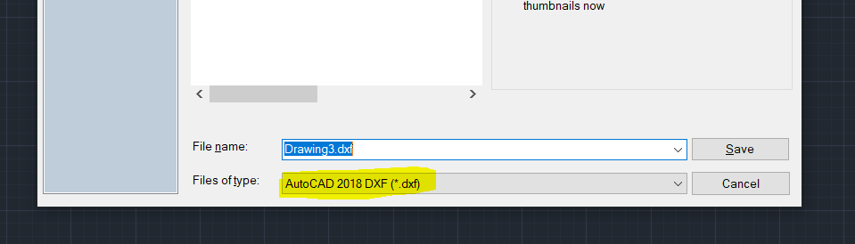

@Jonathan Handojo @Roy_043   I would like to highlight one issue which I am facing because of this program - that my drawing save template/environment is changed and it is set to DXF default . Even if I am opening existing drawing files or creating new files in which I don't want to run this program, the save/saveas command is giving dxf default option which is quite irritating. (refer below image)
 Can you guys please modify this program so that it restore the default settings after its completion  ?
Thanks
Edited by Skierz
BricsCAD uses a SAVEFORMAT setting and the _DxfOut command does not change this setting.
In AutoCAD, apparently (https://www.cadforum.cz/cadforum_en/qaID.asp?tip=6439), this approach should be used:

@Roy_043 thanks for your helping hand. This fixed the issue.

Here is the snapshot of the result obtained for one of the case (it is working fine)
Thanks
