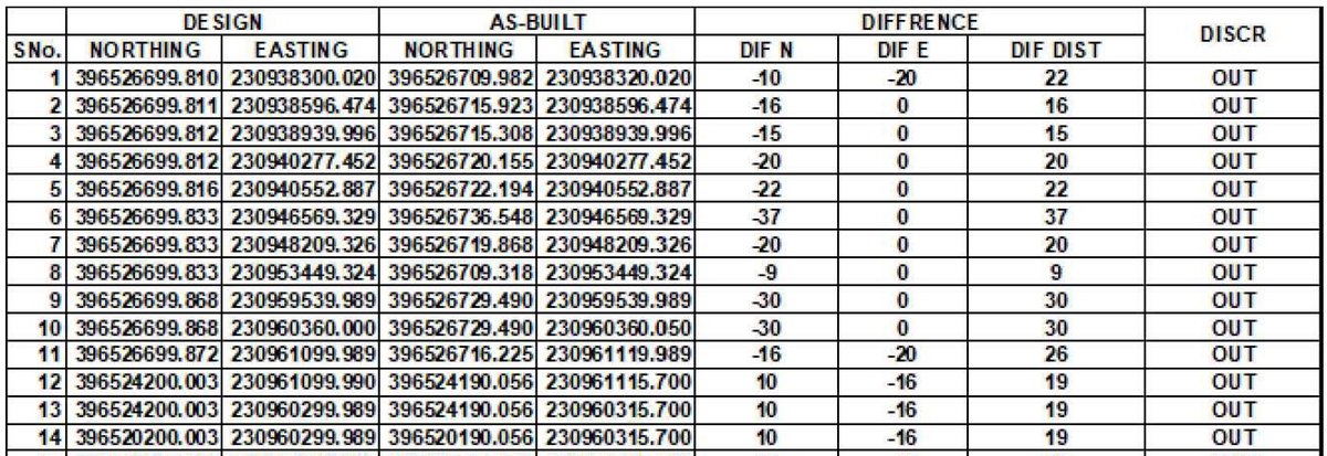

since this corona situation started all my Surveyors left me behind without help .
i'm stuck with 300 Sheets of drawings to extract data and submit to client !
i'll brief .
i have 2 layers :
Design / As-Built
i need to extract the coordinates from both superimposed layers with difference(  In /Out )
i have picture to explain i'll post it here :)
i really hope i can get help here even if i have to pay for it since i already been late to deliver those data !
Thank you very much ,

Thanks For The reply !
these are sample ;
the real deal is .. i need to see the boundary difference between as-built and the design each 0.5 meter and get points .
i have to generate these numbers  .
i'll attache 1 drawing for the job and the sample of work done simller to it :)
Thanks !

@Jonathan
i'll brief :
red line is as-built
green is design (IFC)
we have superimposed those drawings floor by floor , and i need to make list showing the followings :
1- every 0.5m
(maybe max of 1) coordinates for both as-built and design showing the DIF DIST ( the difference of distance ).
2- these points and number we have to add , it will not come with the drawings , every 0.5m (maybe max of 1) will make point with coordinate .
3- will generate those points to excel as same as the attached sample .
can you help me out making this possible !?
Thanks :)

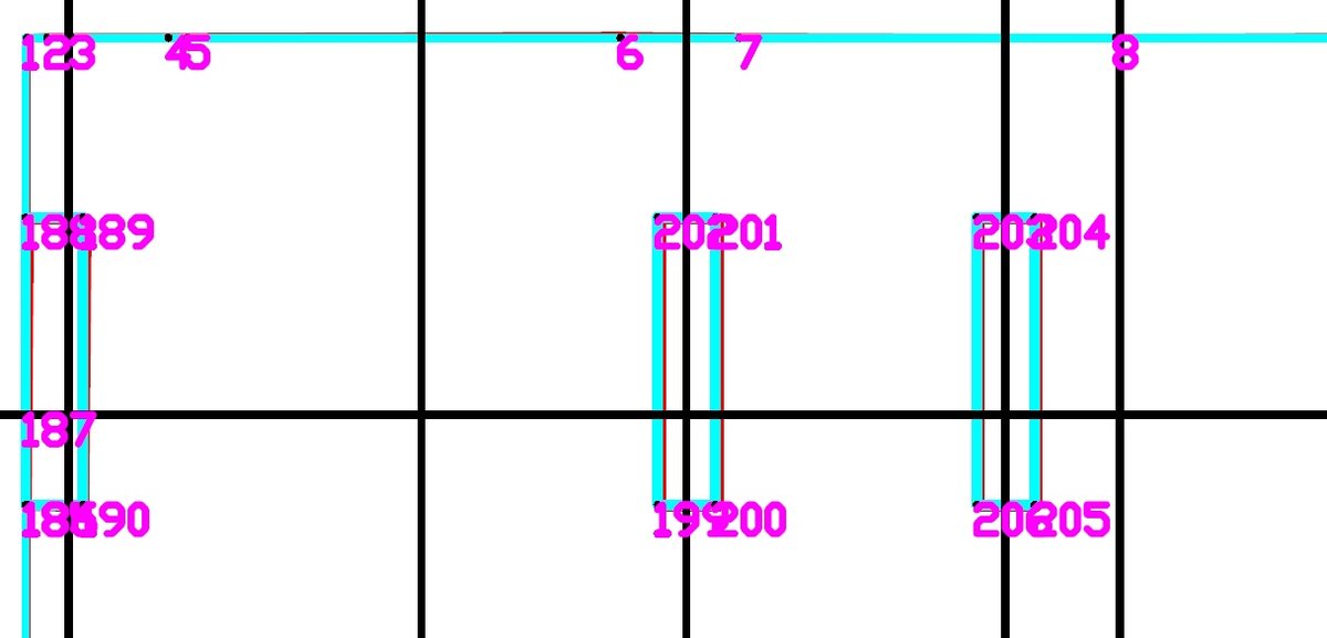

Something like this what you're after? Or am I still missing something?
(defun c:survey ( / *error* acadobj activeundo adoc dets esclays i instpt lay1 lay2 layers msp pointheight rtn ss tolerance totable txthgt vtab)

	layers '("IFC" "As-Built")	; <--- a list of two strings (texts) representing the layer of the texts
					;  ^^^ the first layer will be compared to the second.
	pointheight 400			; <--- the text height for the labels on the drawing
	tolerance 200			; <--- the tolerance (how far apart should the points be to still be considered equal)
	;; Table generated will only look based on screen size, so irrespective of zoom
	;; ------------------------------------------ SETUPS ------------------------------------------ ;;

	    (setq instpt (getpoint "\nSpecify insertion point for table: "))
	    (setq i 0
		  txthgt (* 0.011 (getvar 'viewsize))
		  dets
		     (mapcar
			 '(lambda (x / vt)
			      (vla-put-Alignment
				  (setq vt (vla-AddText msp (itoa (setq i (1+ i))) (vlax-3d-point 0 0 0) pointheight))
				  acAlignmentTopLeft
			      (vla-put-TextAlignmentPoint vt (vlax-3d-point (car x)))
			      (list
				  (itoa i)
				  (rtos (cadar x) 2 3)
				  (rtos (caar x) 2 3)
				  (rtos (cadr (last x)) 2 3)
				  (rtos (car (last x)) 2 3)
				  (rtos (apply '- (mapcar 'cadr x)) 2 0)
				  (rtos (apply '- (mapcar 'car x)) 2 0)
				  (rtos (apply 'distance x) 2 0)
				  "OUT"
			 rtn
		  totable
		     (cons '("" "DESIGN" "" "AS-BUILT" "" "DIFFERENCE" "" "" "DISCR")
			   (cons '("S No." "NORTHING" "EASTING" "NORTHING" "EASTING" "DIF N" "DIF E" "DIF DIST" "") dets)
		  vtab (vla-AddTable msp (vlax-3d-point instpt) (+ 2 (length dets)) 9 (* 2 txthgt) (* 15 txthgt))
	    (vla-put-RegenerateTableSuppressed vtab :vlax-true)
	    (vla-UnmergeCells vtab 0 (1+ (length dets)) 0 8)
	    (foreach x
		       (0 0 1 2)
		       (0 0 3 4)
		       (0 0 5 7)
		       (0 1 8 8)
		(apply 'vla-MergeCells (append (list vtab) x))
	    (vla-put-RegenerateTableSuppressed (JH:put-list-to-table vtab totable 0 0 txthgt) :vlax-false)
    (if activeundo nil (vla-EndUndoMark adoc))

Thanks Romiui. I stick by to the title here...
:D
You can reduce the gap in the LISP file itself. Simply change the tolerance which was 200 to 25.
I didn't know what the "OUT" and "IN" was, so I simply put "OUT" for all of them...

**i have attached DWG showing the readings horizontally ,vertically & curve
i have noticed one small issue into the lisp ,
1- the lisp is reading horizontally and vertically fine with no issues and no errors  , but the Problem started with the curve somehow !
it start reading wrong gaps between as-built and IFC
2- if you can notice into the DWG ; the lisp is skipping some points where it should be added into location that more than 25+ mm ,
i have no idea if it working randomly or it can be forced to add point where ever the tolerance is more than 25+mm ( clouds added blue )
3- can u please send me same lisp but with update ? its to switch the reference to be from the as-built i guess it might give better readings ?!
please excuse my lack of experience to update it my self , u really big help for me
i hope i could someday find a way to pay you back this :)
sorry for the time gap between us , i live in MEA
waiting you're assistance .
Thank You in Advance !
TB-1013 8th FLOOR PLAN AB_Sample to edit lisp.dwg
Edited by Romiui

Technically I'm only using the end points of the IFC drawings, which explain why it didn't capture some of the points whose end point is residing on the As-Builts.
I didn't knew you want it that way.
P.S. you're not the only one around here who's free of time you know. I have my own duties to carry as well!
(defun c:survey ( / *error* acadobj activeundo adoc all dets esclays i instpt lay1 lay2 layers ln msp pointheight rtn ss tolerance totable txthgt vtab)
    (defun *error* ( msg )
	(if (not (wcmatch (strcase msg T) "*break*,*cancel*,*exit*"))
	    (princ (strcat "Error: " msg))
    (setq acadobj (vlax-get-acad-object)
	  adoc (vla-get-ActiveDocument acadobj)
	  msp (vla-get-ModelSpace adoc)
	  activeundo nil)
    (if (= 0 (logand 8 (getvar "UNDOCTL"))) (vla-StartUndoMark adoc) (setq activeundo T))
    (setq
	esclays (mapcar '(lambda (x) (cons 8 (LM:escapewildcards x))) layers)
    (if
	(and
	    (setq ss (ssget (append '((0 . "LINE") (-4 . "<OR")) esclays '((-4 . "OR>")))))
	    (foreach x (setq ln (JH:selset-to-list ss))
		(if (eq (strcase (cdr (assoc 8 (entget x)))) (strcase (car layers)))
		    (setq lay1 (cons (list (vlax-curve-getStartPoint x) (vlax-curve-getEndPoint x)) lay1))
		    (setq lay2 (cons (list (vlax-curve-getStartPoint x) (vlax-curve-getEndPoint x)) lay2))
	    (setq all (LM:UniqueFuzz (append (apply 'append lay1) (apply 'append lay2)) 1e-4))
		(foreach x all
		    (vl-some
			'(lambda (y / cl)
			     (if
				 (and
				     (equal x (setq cl (vlax-curve-getClosestPointTo y x)) tolerance)
				     (null (equal x cl 1e-4))
				 (setq rtn (cons (list x cl) rtn))
			ln
		rtn
	    (setq i 0
		  dets
		     (mapcar
			 '(lambda (x / vt)
			      (vla-put-Alignment
				  acAlignmentTopLeft
			      (list
				  (itoa i)
				  (rtos (caar x) 2 3)
				  "OUT"
			 rtn
		  totable
	    (foreach x
		       (0 0 1 2)
		       (0 0 3 4)
		       (0 0 5 7)
		       (0 1 8 8)

Some areas that you clouded don't even have end points. How the hell is it supposed to find those then?
