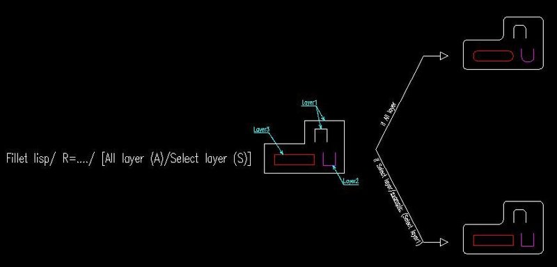

Temy Posted May 6, 2020 Posted May 6, 2020 Hi all, I want to fillet multiple lines at once, but it has to be one layer, Something similar to the image I have attached below. can somebody help me please? thanks For example.dwgFetching info... Quote
dlanorh Posted May 6, 2020 Posted May 6, 2020 (edited) In a basic form try this (defun c:fbl ( / fr ent lyr pea rad ss a ) (setq fr (getvar 'filletrad) ent (car (entsel "\nSelect Object on layer to fillet : ")) lyr (cdr (assoc 8 (entget ent))) ) (cond ( (not (= 1 (getvar 'peditaccept))) (setq pea (getvar 'peditaccept)) (setvar 'peditaccept 1))) (initget 6) (setq rad (cond ( (getreal (strcat "\nEnter Fillet Radius <" (rtos fr) "> : "))) (fr))) (if (/= rad fr) (setvar 'filletrad rad)) (setq ss (ssget (list (cons 8 lyr))) a (ssname ss 0) ) (command "pedit" a "_J" ss "" "") (setq ent (entlast)) (command "fillet" "_P" ent) (command "explode" ent) (if pea (setvar 'peditaccept pea)) (setvar 'filletrad fr) (princ) ) Edited May 11, 2020 by dlanorh updated code 2 Quote

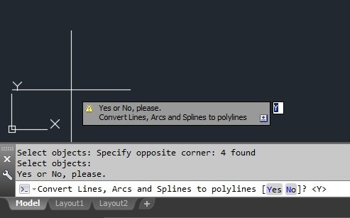

Temy Posted May 11, 2020 Author Posted May 11, 2020 On 5/6/2020 at 9:51 AM, dlanorh said: In a basic form try this (defun c:fbl ( / fr ent lyr rad ss a ) (setq fr (getvar 'filletrad) ent (car (entsel "\nSelect Object on layer to fillet : ")) lyr (cdr (assoc 8 (entget ent))) ) (initget 6) (setq rad (cond ( (getreal (strcat "\nEnter Fillet Radius <" (rtos fr) "> : "))) (fr))) (if (/= rad fr) (setvar 'filletrad rad)) (setq ss (ssget (list (cons 8 lyr))) a (ssname ss 0) ) (command "pedit" a "_J" ss "" "") (setq ent (entlast)) (command "fillet" "_P" ent) (command "explode" ent) (setvar 'filletrad fr) (princ) ) Expand Thanks very much. I tried it, but it has a problem. Please help me fix it. Quote
BIGAL Posted May 11, 2020 Posted May 11, 2020 Dlanorh seemed to fix (command "pedit" (ssname ss 0) "_y" "_J" ss "" "") missing convert to pline yes 2 Quote
dlanorh Posted May 11, 2020 Posted May 11, 2020 On 5/11/2020 at 7:30 AM, Temy said: Thanks very much. I tried it, but it has a problem. Please help me fix it. Expand Apologies. This is a system variable problem (peditaccept). I have altered the code in my original post to account for this, or you can go with @BIGAL approach and replace the command call in my code with his. 1 Quote

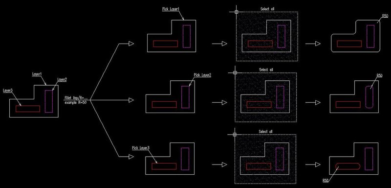

Temy Posted May 11, 2020 Author Posted May 11, 2020 I'm sorry, With this lisp I have accepted it however I want it to be more complete for me. please help me again. thanks! For example2.dwgFetching info... Quote
BIGAL Posted May 12, 2020 Posted May 12, 2020 So you want pick all layers then do it ? (defun c:fbl ( / fr ent lyr rad ss a lst) (setq lst '()) (setq fr (getvar 'filletrad)) (setvar 'orthomode 0) (initget 6) (setq rad (cond ( (getreal (strcat "\nEnter Fillet Radius <" (rtos fr) "> : "))) (fr))) (if (/= rad fr) (setvar 'filletrad rad)) (while (setq ent (car (entsel "\nSelect Object on layer to fillet : "))) (setq lst (cons (cdr (assoc 8 (entget ent))) lst)) ) (setq pt1 (getpoint "Pick corner pt1")) (setq pt2 (getpoint pt1 "Pick corner pt2")) (repeat (setq x (length lst)) (setq lay (nth (setq x (- x 1)) lst)) (setq ss (ssget "w" pt1 pt2 (list (cons 8 lay)))) (command "pedit" (ssname ss 0) "_y" "_J" ss "" "") (setq ent (entlast)) (command "fillet" "_P" ent) ) (setvar 'filletrad fr) (princ) ) 1 Quote

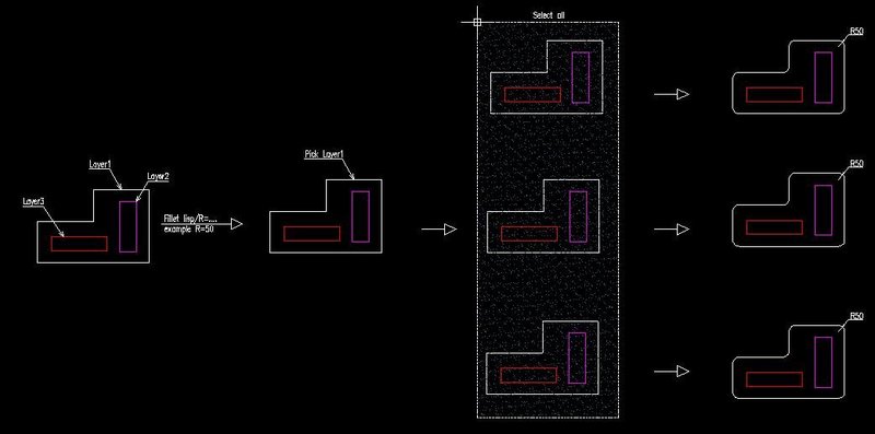

Temy Posted May 12, 2020 Author Posted May 12, 2020 Thank you for your kind help! I tried modifying and it worked, but don't know if it works well or not. Check it out and Can you extend the functionality for me? (defun c:fbl2 ( / fr ent lyr dxf in rad ss a lst) (setq lst '()) (setq fr (getvar 'filletrad)) (initget 6) (setq rad (cond ( (getreal (strcat "\nEnter Fillet Radius <" (rtos fr) "> : "))) (fr))) (if (/= rad fr) (setvar 'filletrad rad)) (defun dxf (n o) (cdr (assoc n (entget o)))) (if (setq ss (ssget "_:L" '((0 . "LINE")))) (progn (repeat (setq in (sslength ss)) (setq lst (cons (ssname ss (setq in (1- in))) lst)) ) (foreach e lst (foreach ent lst (if (or (equal (dxf 10 e) (dxf 10 ent) 1e-8) (equal (dxf 11 e) (dxf 10 ent) 1e-8) (equal (dxf 11 e) (dxf 11 ent) 1e-8) (equal (dxf 10 e) (dxf 11 ent) 1e-8) ) (command "_.fillet" e ent) ) ) ) ) ) (princ) ) I hope to receive more help from yous! Quote
dlanorh Posted May 12, 2020 Posted May 12, 2020 (edited) @Temy Tested and working. I think it covers every case so far. It utilises the dynamic prompt for the All/Select prompt default is All so a right click or enter will select the default. Default for fillet radius is the current fillet radius as before. (defun c:fbl ( / *error* c_doc sv_lst sv_vals fr fuzz typ rad filter ss ssp bx cnt ent lyr) (vl-load-com) (defun *error* ( msg ) (if (and c_doc (= 8 (logand 8 (getvar 'UNDOCTL)))) (vla-endundomark c_doc)) (mapcar 'setvar sv_lst sv_vals) (if (not (wcmatch (strcase msg) "*BREAK*,*CANCEL*,*EXIT*")) (princ (strcat "\nOops an Error : " msg " occurred."))) (princ) );_end_*error*_defun (setq c_doc (vla-get-activedocument (vlax-get-acad-object)) sv_lst (list 'cmdecho 'osmode 'peditaccept 'dynmode 'dynprompt 'filletrad) sv_vals (mapcar 'getvar sv_lst) fr (getvar 'filletrad) fuzz 1.0e-6 );end_setq (mapcar 'setvar sv_lst '(0 0 1 3 1)) (initget "All Select") (setq typ (cond ( (getkword "\nProcess All or Selected Layers? : [All/Select] <All>")) ("All"))) (if (= typ "Select") (setq ent (car (entsel "\nSelect Object on layer to fillet : ")) lyr (cdr (assoc 8 (entget ent))))) (initget 6) (setq rad (cond ( (getreal (strcat "\nEnter Fillet Radius <" (rtos fr) "> : "))) (fr))) (if (/= rad fr) (setvar 'filletrad rad)) (if (and c_doc (= 8 (logand 8 (getvar 'UNDOCTL)))) (vla-endundomark c_doc)) (vla-startundomark c_doc) (if (= typ "Select") (setq filter (list '(0 . "LINE") (cons 8 lyr))) (setq filter (list '(0 . "LINE")))) (setq ss (ssget ":L" filter)) (cond (ss (command "_.pedit" "_M" ss "" "_J" fuzz "") (setq bx (mapcar 'cdr (apply 'append (mapcar 'cdr (vl-remove-if-not '(lambda (x) (minusp (car x))) (ssnamex ss))))) ssp (ssget "_WP" (apply 'append bx) '((0 . "LWPOLYLINE"))) ss nil );end_setq (repeat (setq cnt (sslength ssp)) (setq ent (ssname ssp (setq cnt (1- cnt)))) (command "fillet" "_P" ent) (command "explode" ent) );end_repeat ) );end_cond (if (and c_doc (= 8 (logand 8 (getvar 'UNDOCTL)))) (vla-endundomark c_doc)) (mapcar 'setvar sv_lst sv_vals) (princ) );end_defun Any problems let me know Edited May 13, 2020 by dlanorh code updated 1 Quote

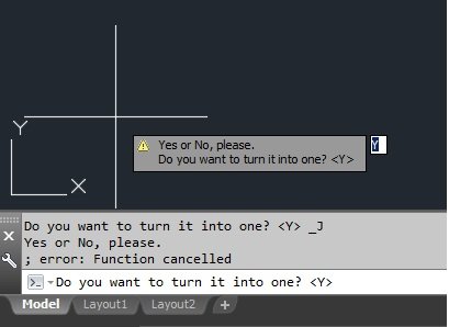

Temy Posted May 13, 2020 Author Posted May 13, 2020 (edited) On 5/12/2020 at 10:14 AM, dlanorh said: @Temy Tested and working. I think it covers every case so far. It utilises the dynamic prompt for the All/Select prompt default is All so a right click or enter will select the default. Default for fillet radius is the current fillet radius as before. (defun c:fbl ( / *error* c_doc sv_lst sv_vals fr fuzz typ rad filter ss ssp bx cnt ent lyr) (vl-load-com) (defun *error* ( msg ) (if (and c_doc (= 8 (logand 8 (getvar 'UNDOCTL)))) (vla-endundomark c_doc)) (mapcar 'setvar sv_lst sv_vals) (if (not (wcmatch (strcase msg) "*BREAK*,*CANCEL*,*EXIT*")) (princ (strcat "\nOops an Error : " msg " occurred."))) (princ) );_end_*error*_defun (setq c_doc (vla-get-activedocument (vlax-get-acad-object)) sv_lst (list 'cmdecho 'osmode 'dynmode 'dynprompt 'filletrad) sv_vals (mapcar 'getvar sv_lst) fr (getvar 'filletrad) fuzz 1.0e-6 );end_setq (mapcar 'setvar sv_lst '(0 0 3 1)) (initget "All Select") (setq typ (cond ( (getkword "\nProcess All or Selected Layers? : [All/Select] <All>")) ("All"))) (if (= typ "Select") (setq ent (car (entsel "\nSelect Object on layer to fillet : ")) lyr (cdr (assoc 8 (entget ent))))) (initget 6) (setq rad (cond ( (getreal (strcat "\nEnter Fillet Radius <" (rtos fr) "> : "))) (fr))) (if (/= rad fr) (setvar 'filletrad rad)) (if (and c_doc (= 8 (logand 8 (getvar 'UNDOCTL)))) (vla-endundomark c_doc)) (vla-startundomark c_doc) (if (= typ "Select") (setq filter (list '(0 . "LINE") (cons 8 lyr))) (setq filter (list '(0 . "LINE")))) (setq ss (ssget ":L" filter)) (cond (ss (command "_.pedit" "_M" ss "" "_J" fuzz "") (setq bx (mapcar 'cdr (apply 'append (mapcar 'cdr (vl-remove-if-not '(lambda (x) (minusp (car x))) (ssnamex ss))))) ssp (ssget "_WP" (apply 'append bx) '((0 . "LWPOLYLINE"))) ss nil );end_setq (repeat (setq cnt (sslength ssp)) (setq ent (ssname ssp (setq cnt (1- cnt)))) (command "fillet" "_P" ent) (command "explode" ent) );end_repeat ) );end_cond (if (and c_doc (= 8 (logand 8 (getvar 'UNDOCTL)))) (vla-endundomark c_doc)) (mapcar 'setvar sv_lst sv_vals) (princ) );end_defun Any problems let me know Expand Thank you @dlanorh I have used and worked well on AutoCAD2008 version, but on AutoCAD2019 version it has a problem. It reports the following error. please fix it... Edited May 13, 2020 by Temy update question Quote
BIGAL Posted May 13, 2020 Posted May 13, 2020 (edited) Had another go a simpler method using Autocads pedit multiple. (defun c:fbl3 ( / fr pt1 pt2 ss) (setq fr (getvar 'filletrad)) (initget 6) (setq rad (cond ( (getreal (strcat "\nEnter Fillet Radius <" (rtos fr) "> : "))) (fr))) (if (/= rad fr) (setvar 'filletrad rad)) (setq pt1 (getpoint "\nPick 1st cnr point")) (setq pt2 (getpoint pt1 "\nPick 1st cnr point")) (command "Pedit" "m" "w" pt1 pt2 "" "Y" "Join" 0.0 "") (setq ss (ssget "w" pt1 pt2 '((0 . "LWPOLYLINE")))) (repeat (setq x (sslength ss)) (setq ent (ssname ss (setq x (- x 1)))) (setq pt1 (vlax-curve-getendpoint (vlax-ename->vla-object ent))) (command "fillet" "P" pt1 ) ) (princ) ) (c:fbl3) Edited May 13, 2020 by BIGAL 1 Quote
dlanorh Posted May 13, 2020 Posted May 13, 2020 On 5/13/2020 at 12:58 AM, Temy said: Thank you @dlanorh I have used and worked well on AutoCAD2008 version, but on AutoCAD2019 version it has a problem. It reports the following error. please fix it... Expand This is probably because the system variable "peditaccept" is different on the two systems. It should be 1. I have altered the posted code in my last post to account for this. 1 Quote
