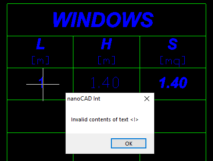

2 minutes ago, carmelo said:
Now is perfect!
wow...you didn't stop until you totally solved the problem! You are a great men 🏆
Thank you very much
Excellent, you are welcome anytime. :)
@Tharwat Perhaps a bit simpler? ( based on example drawing )
(defun cmts (str)
  (if (and (wcmatch str "*{*;*}")
	   (setq str (substr str (+ 2 (vl-string-position (ascii ";") str 0 t))))
    (substr str 1 (vl-string-position (ascii "}") str))
    str
