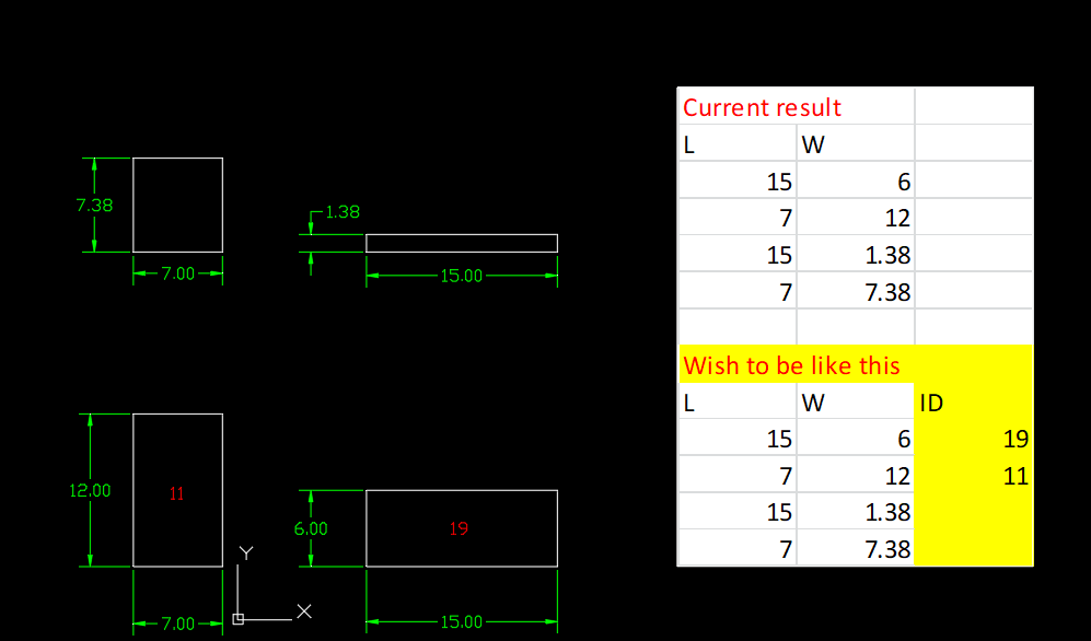

Length and Width of Rectangles With ID to excel
tefached
@RonnieBN Give this a shot.

20 hours ago, Tharwat said:
Give this a shot.
Thanks Tharwat! It works. But an we make it works with the rectangles without the ID inside?
3 minutes ago, RonnieBN said:
Thanks Tharwat! It works. But can we make it works with the rectangles without the ID inside?
Certainly. :)

Just test your work. Thanks!
I was meaning that could we make the lisp give the results as for both case 1- with the ID and 2-without the ID in only one command/lisp.
Thanks!

No worries @RonnieBN , please find the latest version that should cover the two options with / without ID [ Yes , No ] < Default value Tes > as ordered in the program.
Please try the following untested codes and let me know how you get on with it.
I have tested. It works perfectly and so helpful. I appreciate so much!
  • 5 months later...
Hey Tharwat. I am a newbie here in lisp. Can you tell me how do I change whats the outcome in excel file. I have attached jpeg showing how I want. What lines do I need to Edit?
