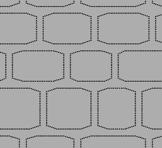

sups-rec.patFetching info...
  On 7/4/2024 at 1:19 PM, marko_ribar said:
Not good at all... This is what I got after around 6000 seconds... Reference for "sups-rec.pat" file was already posted "sups-rec.dwg"... So, perhaps someone with some new method should chime in - if that method exist!!!
Regards, so long from me...
M.R.
sups-rec.pat 14.41 kB Â· 0 downloads
Expand
Thanks for taking a look into this. Greatly appreciated! I don't have the knowledge to help. Otherwise I would.
Hopefully, someone can help you. All the best.

I've been trying to figure out why AutoCADs' preview looks next to useless (and that's been very generous). See the attached example hatch pattern and the original drawing file also.
The preview looks like this ðŸ˜‘
What does bricsCADs' preview look like?
I have the hatch drawn in a 1x1 square with a rounding of 0.01.
It should half resemble this 1x1 square, I would of thought.
Stone Cobble 01.dwgFetching info... Stone Cobble 01.patFetching info...
Edited by 3dwannab
In Bricscad the preview is a Black rectang, it may be due to the pattern using dots rather than lines.
The pattern it self works, but I know from past experience doing lines as dots can massively slow down a dwg.
Edited by BIGAL
Dots. Oh. The pattern is drawn as lines. Am I missing something?
If you look at the pattern file in a text editor, all 4732 lines of the definition format have an angle (first number of a definition line) of 0 degrees and a length (sixth number of a definition line) of 0.
There are no lines and if you zoom into the hatch pattern you will see the dots
Edited by eldon
removed picture
If you want lines only, the pattern consists of 8 rows of cobbles with 6 cobbles in each row. Each cobble is made up with 8 lines, so the definition file should have 384 lines.
