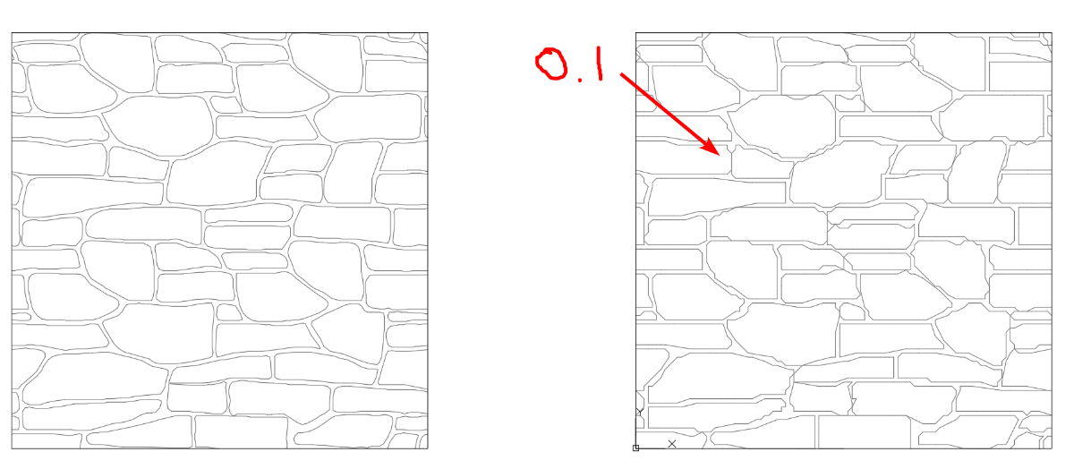

@marko_ribar, I get Specified string not valid.
Why do you say that generated .pat files are bad? What's the best way to do them? Manually by entering the data?
Edit:
Sorry I put testpat.pat as the description. testpat works for both description and filename.
Edited by 3dwannab
It's a long story... If you analyze *.lsp posted lastly by me, you'll notice that every line is searching for collinearity in a rectangular array of boundaries very far from original line, plus there should be satisfied requirenment that offset of lines meets adjacent boundary at correct distance... If these two clauses are fulfilled, then there should be no problem, and when hatching there should be exact matching of source lines and hatched ones... But more than often these clauses are not fulfilled, and so *.pat files are bad... But you'll never know, maybe someone find some better way to solve those lacks... As far as I can see, making correct *.pat files in rectangular array is heavy task to acomplish; therefore that's why AutoDesk implemented SUPERHATCH command, but it works with blocks and not *.pat files... It seems that for users that are drafters that had no effect on the way they work, and to cut the story, noone had any complainments about hatching with blocks instead of with *.pat files...
Regards, M.R.
Edited by marko_ribar

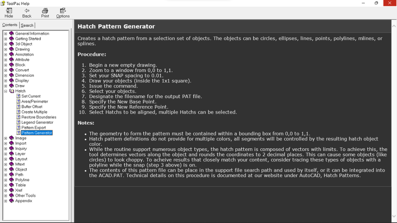

Thanks for the very clear answer. I will test this program out as I'm trying to create a stone hatch library for the office and will use this script in doing so.
To fix your script you can change this line:
 (write-line (strcat "*" des ", " des) f)
to:
(write-line (strcat "*" (vl-filename-base fn) ", " des) f)
@3dwannab
I've modified my latest version to be just slightly more reliable... My mistake was in sub (removetrailingzeros)... And plus I changed ' (apostrophes) with adequate (function) or (quote) calls... That's all, but I haven't tested it yet on more complex DWGs...
Here is the code :

Thanks. This hatch doesn't look great at 0.01 grid spacing at a 1x1 square.
Is that 0.1 grid thing a limitation of some kind?
Look I did something different than that author (don't know his name), but he used trigonometry for generization of angled lines and yes that limitation is too bad... Now looking at your picture, I suppose that this isn't just 100x100 pixels, but I don't know how is it generated... Maybe with the same routine from cadalyst site and user used much densier lines... Actually initialy I started to code my version as I saw his instruction (100x100) for which I was unsatisfied...
That's all of the story...

This capture is from ToolPac chm help file... Basically hatch generator uses the same algorithm as Lanny Schiele Hatch Maker...
I guess from looking at that. I used to have it installed for 2020 and never really got a chance to test it out.
