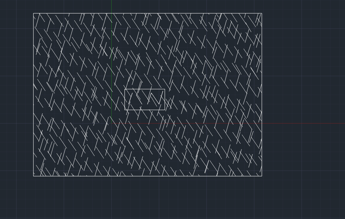

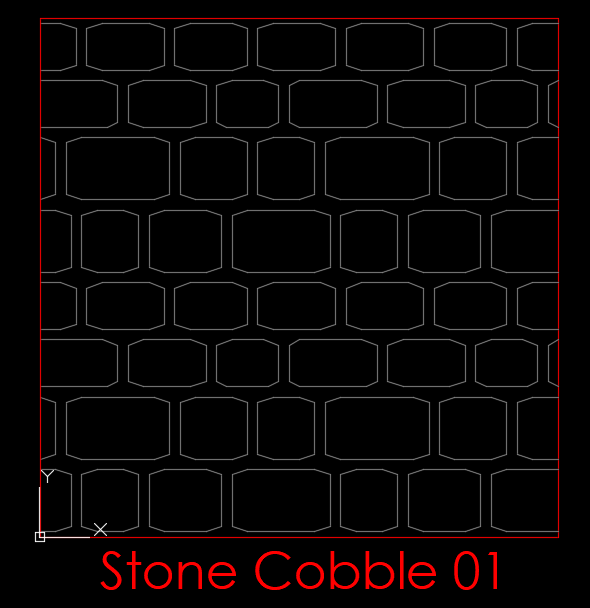

But sometimes, calculation of HATCH PAT file by using my method can be very long and I still haven't found a way to speed it... Recently I posted a question at theswamp : http://www.theswamp.org/index.php?topic=55999.0 and I implemented solution in my codes... Read carefully all defuns... You'll see that I coded two global variables for getting partial results of calculations... So routine can be interrupted, but then you should save results into files... The goal is to make hatch by combining all saved *.txt files of *ll* variable... So firstly you apply fist (c:func1), then second, then third and so until you apply all in order I coded them... When you want to continue after interruption you should load *slsthand* global from saved file and repeat procedure on DWG you opened again or not... *slsthand* variable should be smaller after some data had been calculated... You do this all to the end... Finally you combine *.txt files of *ll* variables... Sometimes you can start HATCH generation and you waited long, but then again if DWG is not suitable (SNAPS were wrong or HATCH to complex with dimensions) there can be situation where after interruption you check !*ll* and it returns nil... So in this case you should avoid creating HATCH... Routine and DWG still not suitable for the task... So better save PC and electrical energy for something more useful... Anyway here it is :
(defun c:savehatchfromstrcur ( / *error* trim0trailing trimlineto80chr acet-geom-ss-extents-accurate _do-events unit projpt2p1p2 intrecsang cmde s boundary ch e minp maxp w h ww hh lil des fn f a x y no ip dx dy l v k kk fullkl kl kll aa bb o1 o2 o3 o4 ol mindy dxdyl oo ooo g ll al nn scf fuz fuzz fuzzz loop )

  (alert "SAVE DWG BEFORE APPLYING THIS ROUTINE...\nSet SNAP to ON and draw boundary rectangle and hatching geometry (lines) inside boundary. IF YOU HAVE STRAIGHT POLYLINES INSIDE BOUNDARY, YOU MUST EXPLODE THEM TO LINES AND RESTART ROUTINE... SNAP must be 0.1x0.1 or greater - best 0.5x0.5...")
  (while
    (or
      (prompt "\nSelect boundary rectangle and hatching geometry...")
      (not (setq s (ssget '((-4 . "<or") (0 . "LINE") (-4 . "<and") (0 . "LWPOLYLINE") (-4 . "<not") (-4 . "<>") (42 . 0.0) (-4 . "not>") (-4 . "and>") (-4 . "or>")))))
      (if s
