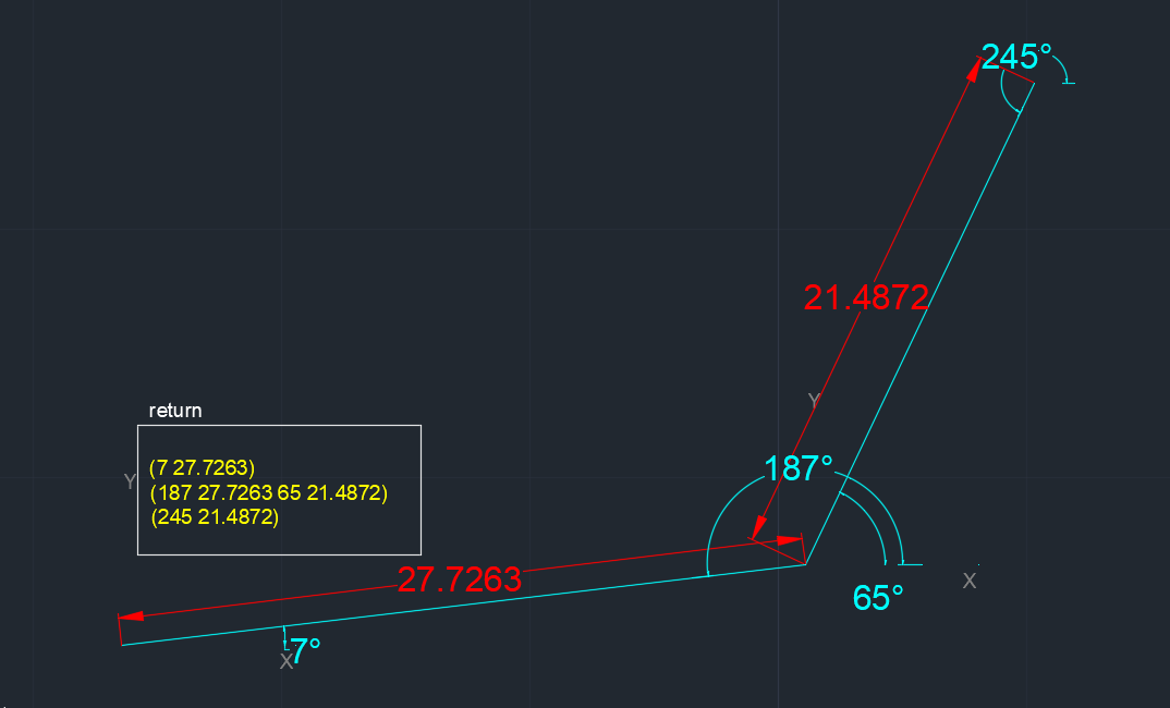

Hello, does anyone have a sub-function that returns me a list with the angle in relation to X and the distance between the verticies of a polyline ??
(7 27.7263)
(187 27.7263 65 21.4872)
(245 21.4872)

Do you want the  two angles for every segment or just the angle in the direction the polyline is constructed?
the two angles for each segment

And the angular units and accuracy?
angular units: Degrees
Accuracy: 4 decimal places
Try this, tested and working but may need tweaking as angles are in decimal degrees.
(defun rh:plad (ent / r2d ep sp sd sa ld la lst)
  (defun r2d (r) (if (>= (* 180.0 (/ r pi)) 360) (- (* 180.0 (/ r pi)) 360) (* 180.0 (/ r pi))))
  (setq sp 0 ep (vlax-curve-getendparam ent))
  (while (<= sp ep)
    (if (< sp ep) (setq sd (- (vlax-curve-getdistatparam ent (1+ sp)) (vlax-curve-getdistatparam ent sp))
                        sa (angle '(0.0 0.0 0.0) (vlax-curve-getfirstderiv ent sp))
                  );end_setq
    );end_if
    (cond ( (zerop sp) (setq lst (cons (list (r2d sa) sd) lst)))
          ( (= ep sp) (setq lst (cons (list (r2d (+ la pi)) ld) lst)))
          (t (setq lst (cons (list (r2d (+ la pi)) ld (r2d sa) sd) lst)))
    );end_cond
    (setq sp (1+ sp) ld sd la sa)
  );end_while
  (reverse lst)
);end_defun
Requires an lwpolyline entity.

Thank you so much it works !!!
Just a suggestion work in radians much easier with Autocad lisp.
