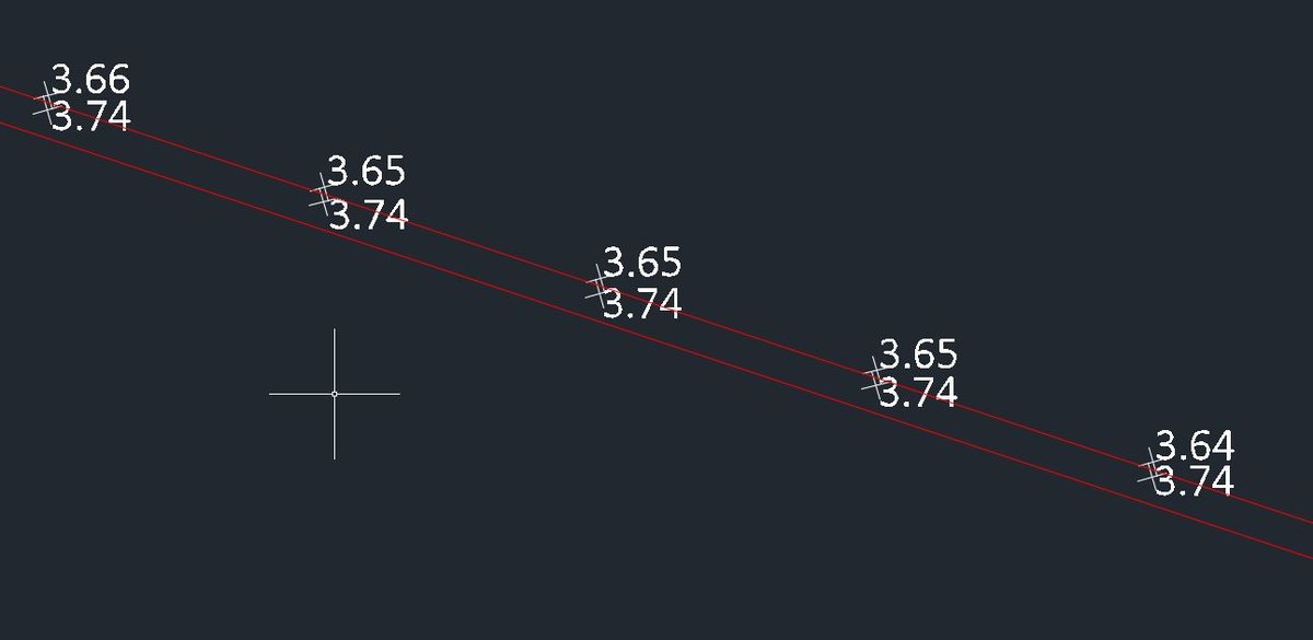

I received a DWG with 7800 levels like the picture attached.
Each level is composed by:
  • Label (Mtext) + Point. Both this 2 elements was placed whit the same Z value.
I need a lisp that split this Levels in 2 layers "by height".
The high value on the 1st layer (Top of the kerbs) and the low value on the 2nd layer (Bottom of the kerbs).
Someone can kelp me?
Many thanks.

OK. First attempt. This seems to work having tested in various orientations. You can set your own layers and colors for top of kerb and bottom of kerb in the user settings (setq)
(if the layers don't exist they are created and the color set)
It assumes all the MTEXT items are on layer LEVEL. There are no checks for matching pairs.

If think people are heading in wrong direction to many years in CIVIL, if you look more carefully at the dwg there are 2 Field survey "Points" these have a Z value. Top and bottom of kerb.
The 1st step is what type of kerb just because there are 2 points does not reveal a kerb type in this case its around 150 so this for me would suggest a "B1"
ok some kerb types
B1 Backofkerb, Faceofkerb, Bottomofkerb 150mm wide
B2 Backofkerb, Faceofkerb, Invert, Lipofkerb 450mm wide
The white line is a red herring and it basically is a line between the points so then end required result is two 3dlines joining the "Points", a solution is to walk along the white line looking for points then join lowest and highest at each location so get a true kerb.
If these points were say a csv then it would be possible to join them automatically if they have a "Code" attached to each point PNEZC is a typical csv.
Just need some time have some actual work to do 1st.
Ps some issues point surveyed order left and right may not be in same order so sort 2 lists X&Y must have 2 points else compare dist and stop as missing points.
To whosa does the whiteline exist for all kerbs etc or did you add it ?

yes,  I have a sigle pline on zero. I need to convert it in 3Dpoly
So, After split the levels in 2 layer I need to:
  • move all this point (parallel) under the pline and after
  • connect with 2 different  pline, one for the top and one for the bottom of the kerbs
Very time consuming

@dlanorh
This lisp work well but it has 2 problems:
  1. I need to apply the lisp only on selected object. Fixed:
(setq ss (ssget '((0 . "MTEXT") (8 . "LEVEL"))))
       2. The "Point" remain on Point Layer.  I would like to split the point as well. Maybe in separate layer as well Point_Top_Kerbs and Point_Bottom_Kerbs
You think It will be possible?
Many thanks for you time

OK, I wondered if that would be the case. Should have something later.
OK. Amended Lisp. I've removed the local  *error* and adjusted the ssget. Tested and working on your test drawing. As before you can adjust the text and point layers in the User Settings (setq). The same color is used for the bottom text and points (3) and the top text and points (6)

                    (vlax-put (vlax-ename->vla-object aent) 'layer tkp_lyr)
                    (vlax-put (vlax-ename->vla-object bent) 'layer bkp_lyr)
                  (t
                    (vlax-put (vlax-ename->vla-object aent) 'layer bkp_lyr)
                    (vlax-put (vlax-ename->vla-object bent) 'layer tkp_lyr)
            );end_cond
          );end_while
        (t (alert "Nothing Found"))
  );end_cond
  (mapcar 'setvar sv_lst sv_vals)
);end_defun
  • Thanks 1
(defun c:tbk ( / c_doc c_lyrs sv_lst sv_vals bok_lyr bc tok_lyr tc bkp_lyr tkp_lyr ss cnt ent elst typ i_pt tlst plst aent bent)
  (setq c_doc (vla-get-activedocument (vlax-get-acad-object))
        c_lyrs (vlax-get-property c_doc 'layers)
        sv_lst (list 'cmdecho 'osmode)
        sv_vals (mapcar 'getvar sv_lst)
  );end_setq
;; User Settings
  (setq bok_lyr "Bottom_Kerb" bc 3  ;Bottom of Kerb Layer and color
        tok_lyr "Top_Kerb" tc 6     ;Top of Kerb Layer and color
        bkp_lyr "Kerb_Point_Top"    ;Top of Kerb Point Layer
        tkp_lyr "Kerb_Point_Bottom" ;Bottom of Kerb Point Layer
  );end_setq
  (cond ( (not (tblsearch "layer" bok_lyr)) (vla-add c_lyrs bok_lyr) (vlax-put (vla-item c_lyrs bok_lyr) 'color bc)))
  (cond ( (not (tblsearch "layer" tok_lyr)) (vla-add c_lyrs tok_lyr) (vlax-put (vla-item c_lyrs tok_lyr) 'color tc)))
  (cond ( (not (tblsearch "layer" bkp_lyr)) (vla-add c_lyrs bkp_lyr) (vlax-put (vla-item c_lyrs bkp_lyr) 'color bc)))
  (cond ( (not (tblsearch "layer" tkp_lyr)) (vla-add c_lyrs tkp_lyr) (vlax-put (vla-item c_lyrs tkp_lyr) 'color tc)))
  (setq ss (ssget '((0 . "POINT,MTEXT") (8 . "POINT,LEVEL"))))
  (cond (ss
          (repeat (setq cnt (sslength ss))
            (setq elst (entget (setq ent (ssname ss (setq cnt (1- cnt)))))
                  typ (cdr (assoc 0 elst))
            );end_setq
            (if (= typ "POINT") (setq plst (cons (list (cdr (assoc 10 elst)) ent) plst)) (setq tlst (cons (list (cdr (assoc 10 elst)) ent) tlst)))
          );end_repeat
          (setq i_pt (caar tlst)
                tlst (vl-sort tlst '(lambda (x y) (< (distance i_pt (car x)) (distance i_pt (car y)))))
                plst (vl-sort plst '(lambda (x y) (< (distance i_pt (car x)) (distance i_pt (car y)))))
          );end_setq
          (while tlst
            (setq aent (cadr (car tlst)) bent (cadr (cadr tlst)) tlst (cddr tlst))
            (cond ( (> (atof (cdr (assoc 1 (entget aent)))) (atof (cdr (assoc 1 (entget bent)))))
                    (vlax-put (vlax-ename->vla-object aent) 'layer tok_lyr)
                    (vlax-put (vlax-ename->vla-object bent) 'layer bok_lyr)
                  (t
                    (vlax-put (vlax-ename->vla-object aent) 'layer bok_lyr)
                    (vlax-put (vlax-ename->vla-object bent) 'layer tok_lyr)
            );end_cond
          );end_while
          (while plst
            (setq aent (cadr (car plst)) bent (cadr (cadr plst)) plst (cddr plst))
            (cond ( (> (caddr (cdr (assoc 10 (entget aent)))) (caddr (cdr (assoc 10 (entget bent)))))
                  (t
            );end_cond
          );end_while
  );end_cond
);end_defun
What can I say.... THANKSSSSS!!!!!!!!!!!!. You are a genius.
This lisp will save hours of works.
Many thanks again for your help.
No problem. 👍
