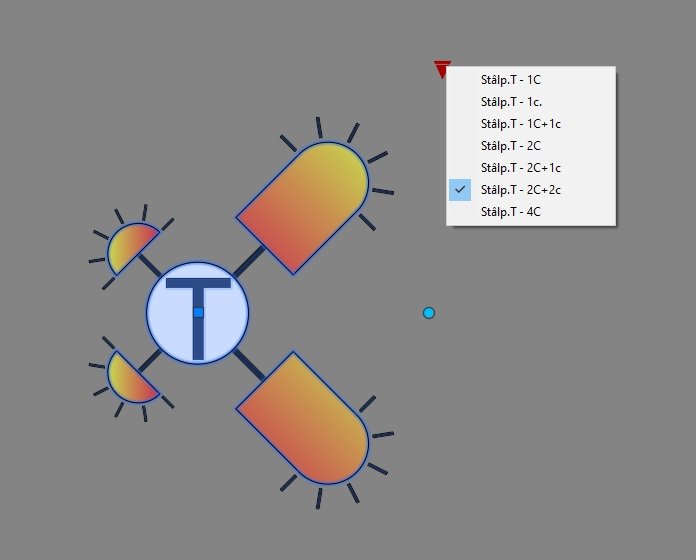

Sinucigasu Posted April 22, 2020 Posted April 22, 2020 Hello, If some one can help me please, i have this block in autocad with different Visibility, and i have a lot of them on a draw. What i want is to select all block but with a specify visibility state, so i can count them. I tried some LISP code from internet but no succes so far, and i'm 0 with coding. Quote

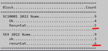

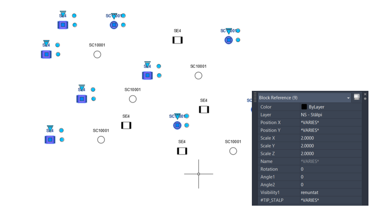

Midnight88 Posted June 16, 2023 Posted June 16, 2023 On 4/22/2020 at 3:29 PM, Jonathan Handojo said: Hello, I was wondering if we can have an update to the dynamic counter block lisp. I'm am okish with programing, but can't exactly understand the behind of lisp code. I've tried different scenarios to change the code so that the total number of each block that have the same visibility state name can be summed, but can't figure out how. I've tried to memorize the final number onto a variable that can be summed in the end but with no success. So what i want is if it can be possible to show me the sum of all blocks that have the same visibility name So in the end will show me 7 of "Ok" and 11 of "renuntat". Thanks a lot if someone could help! Quote
marko_ribar Posted June 16, 2023 Posted June 16, 2023 (edited) 6 hours ago, Midnight88 said: Hello, I was wondering if we can have an update to the dynamic counter block lisp. I'm am okish with programing, but can't exactly understand the behind of lisp code. I've tried different scenarios to change the code so that the total number of each block that have the same visibility state name can be summed, but can't figure out how. I've tried to memorize the final number onto a variable that can be summed in the end but with no success. So what i want is if it can be possible to show me the sum of all blocks that have the same visibility name So in the end will show me 7 of "Ok" and 11 of "renuntat". Thanks a lot if someone could help! Hi, I have this in my library... It select blocks by visibility states... So, you have to select blocks and input visibility state you wish through dialog box and new selection will be created... Then you can do (if (ssget "_I") (sslength (ssget "_I")) 0) to count blocks... (defun selvis ( / ent i props ss your_visibility ) ; <--- Returns the selection set with the desired visibility states (defun getvisstates ( ss / unique LM:getvisibilitystatesnames i blk lst ) (defun unique ( lst ) (if lst (cons (car lst) (unique (vl-remove-if '(lambda ( x ) (or (= (strcase x) (car lst)) (= x (car lst)))) (cdr lst))))) ) ;; Get Visibility States Names - Lee Mac ;; Returns the names of the Visibility States of a Dynamic Block (if present) ;; blk - [vla] VLA Dynamic Block Reference object ;; Returns: [str] Names of Visibility States, else nil (defun LM:getvisibilitystatesnames ( blk / vis ) (if (and (vlax-property-available-p blk 'effectivename) (setq blk (vla-item (vla-get-blocks (vla-get-document blk)) (vla-get-effectivename blk) ) ) ;(= :vlax-true (vla-get-isdynamicblock blk)) to account for NUS dynamic blocks (= :vlax-true (vla-get-hasextensiondictionary blk)) (setq vis (vl-some '(lambda (pair) (if (and (= 360 (car pair)) (= "BLOCKVISIBILITYPARAMETER" (cdr (assoc 0 (entget (cdr pair))))) ) (cdr pair) ) ) (dictsearch (vlax-vla-object->ename (vla-getextensiondictionary blk)) "ACAD_ENHANCEDBLOCK" ) ) ) ) ;(cdr (assoc 301 (entget vis))) (mapcar 'cdr (vl-remove-if '(lambda ( x ) (/= (car x) 303)) (entget vis))) ) ) (if ss (repeat (setq i (sslength ss)) (setq blk (ssname ss (setq i (1- i)))) (if (= (vla-get-isdynamicblock (vlax-ename->vla-object blk)) :vlax-true) (setq lst (append lst (LM:getvisibilitystatesnames (vlax-ename->vla-object blk)))) ) ) ) (unique (reverse lst)) ) (defun AT:ListSelect ( title label height width multi lst / fn fo d item f ) ;; List Select Dialog (Temp DCL list box selection, based on provided list) ;; title - list box title ;; label - label for list box ;; height - height of box ;; width - width of box ;; multi - selection method ["true": multiple, "false": single] ;; lst - list of strings to place in list box ;; Alan J. Thompson, 09.23.08 / 05.17.10 (rewrite) (setq fo (open (setq fn (vl-filename-mktemp "" "" ".dcl")) "w")) (foreach x (list (strcat "list_select : dialog { label = \"" title "\"; spacer;") (strcat ": list_box { label = \"" label "\";" "key = \"lst\";") (strcat "allow_accept = true; height = " (vl-princ-to-string height) ";") (strcat "width = " (vl-princ-to-string width) ";") (strcat "multiple_select = " multi "; } spacer; ok_cancel; }") ) (write-line x fo) ) (close fo) (new_dialog "list_select" (setq d (load_dialog fn))) (start_list "lst") (mapcar (function add_list) lst) (end_list) ;;;(setq item (set_tile "lst" "0")) (action_tile "lst" "(setq item $value)") (setq f (start_dialog)) (unload_dialog d) (vl-file-delete fn) (if (= f 1) (mapcar '(lambda ( n ) (nth n lst)) (read (strcat "(" item ")"))) ) ) (setq ss (ssget '((0 . "INSERT"))) your_visibility (mapcar 'strcase (AT:ListSelect "CHOOSE VISIBILITY STATES YOU WANT TO HIGHLIGHT" "VISIBILITY STATES" 40 30 "true" (getvisstates ss)) ) ) (repeat (setq i (sslength ss)) (if (or (eq (vla-get-IsDynamicBlock (vlax-ename->vla-object (setq ent (ssname ss (setq i (1- i)))) ) ) :vlax-false ) (and (setq props (vl-remove-if-not '(lambda ( x ) (wcmatch (strcase (vla-get-PropertyName x)) "VISIBILITY*" ) ) (vlax-invoke (vlax-ename->vla-object ent) 'GetDynamicBlockProperties ) ) ) (vl-some '(lambda ( x ) (if (null (vl-position (strcase (vlax-get x 'Value)) your_visibility ) ) (ssdel ent ss) ) ) props ) ) ) (ssdel ent ss) ) ) ss ) (defun c:selvis ( / ss ) (if (null (vl-catch-all-error-p (setq ss (vl-catch-all-apply 'selvis)) ) ) (sssetfirst nil ss) ) (princ) ) HTH. M.R. Edited June 16, 2023 by marko_ribar 1 Quote
