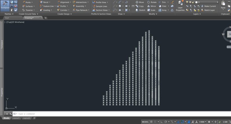

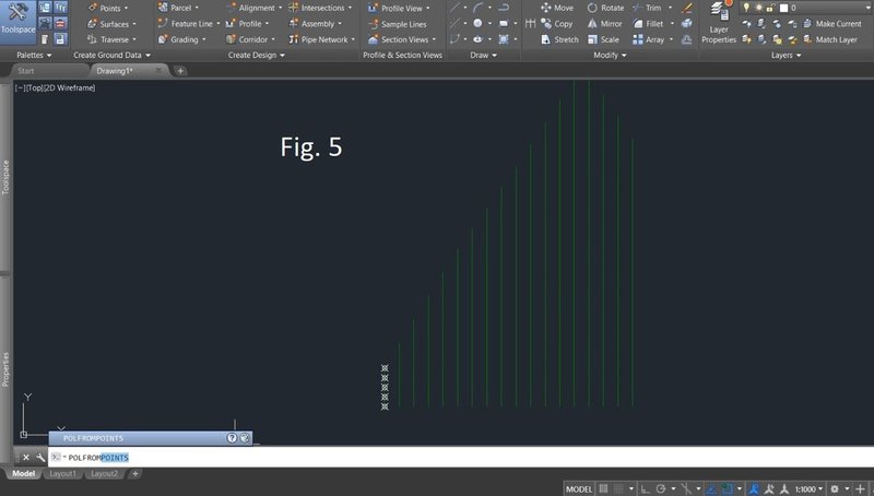

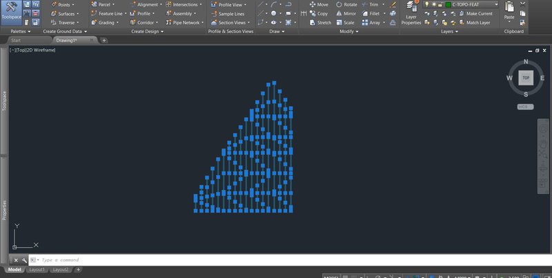

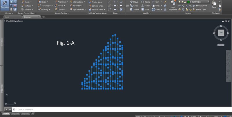

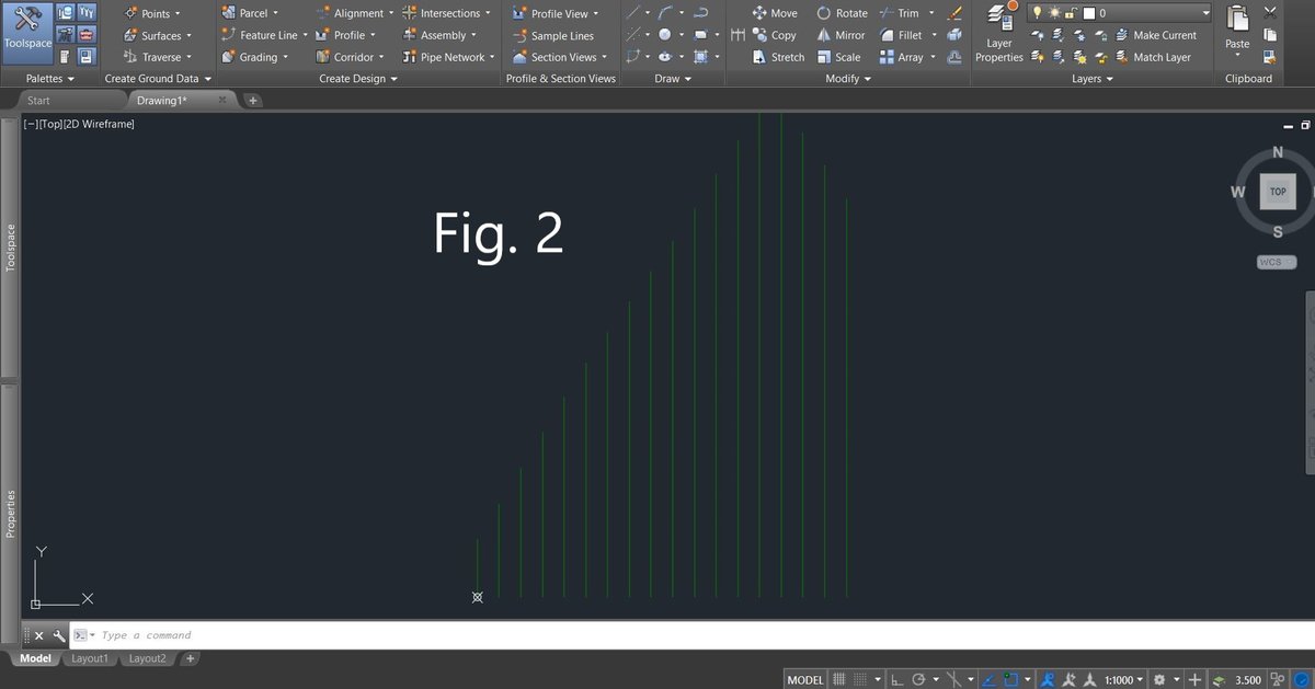

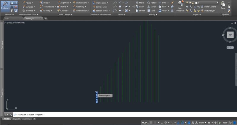

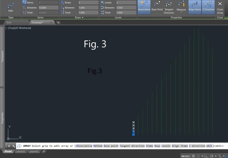

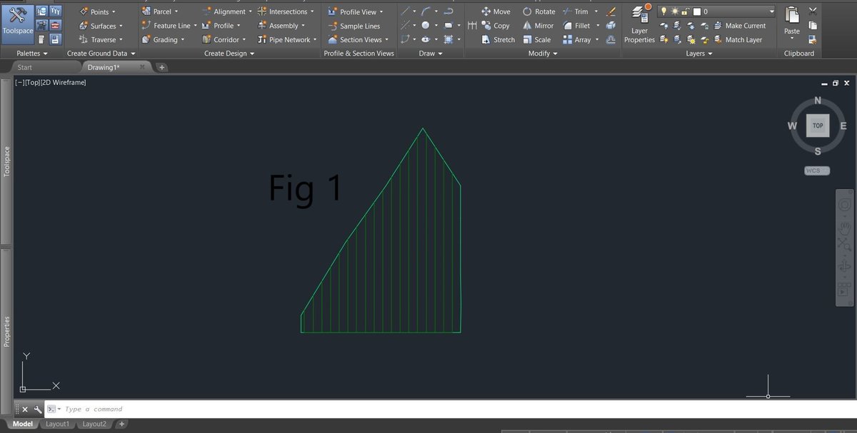

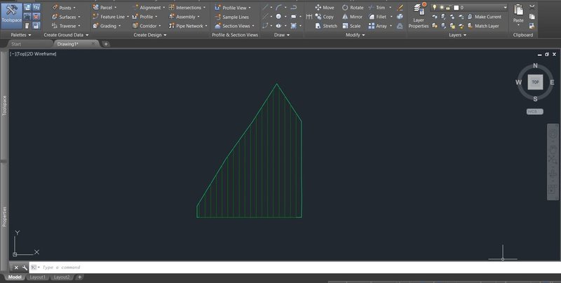

I have a collection of 3D poly lines (see Fig. 1 and 1-A), and I'm looking for a lisp that will do the follows:
1.draw a point object at the start of every  line (vertex No.1) - see figure 2
2. create an Path array from that point object and the 3d polyline. the Array parameters will be set now for the rest of 3d Polyline's collection. (Fig. 3)

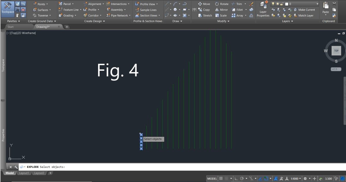

3. explode the array so it can be used to the points to draw the 3d polyline from them (Fig.4)

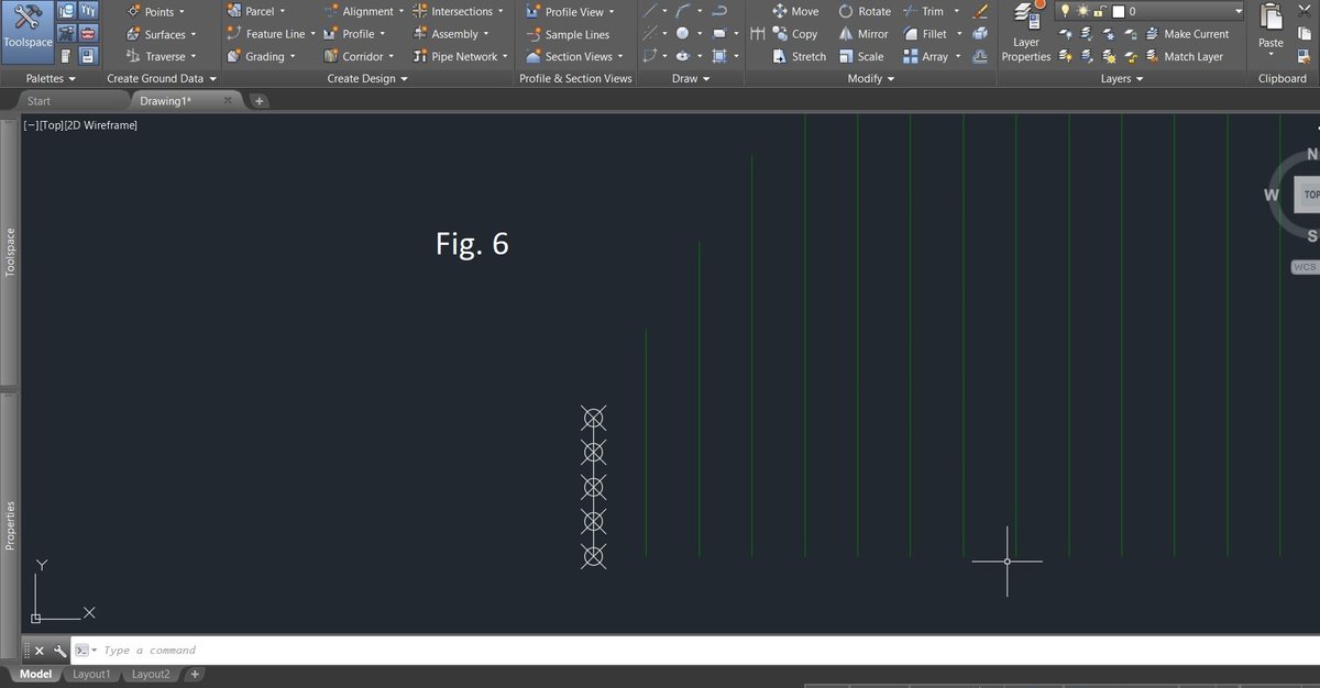

4. draw a 3d polyline from the point collection (Fig 5 & 6) by using use a lisp command called polFPoints.lsp. i found this lisp in this thread and the lisp was made by the user JohnM - MANY THANKS AND A FULL CREDIT TO jhonM!!!

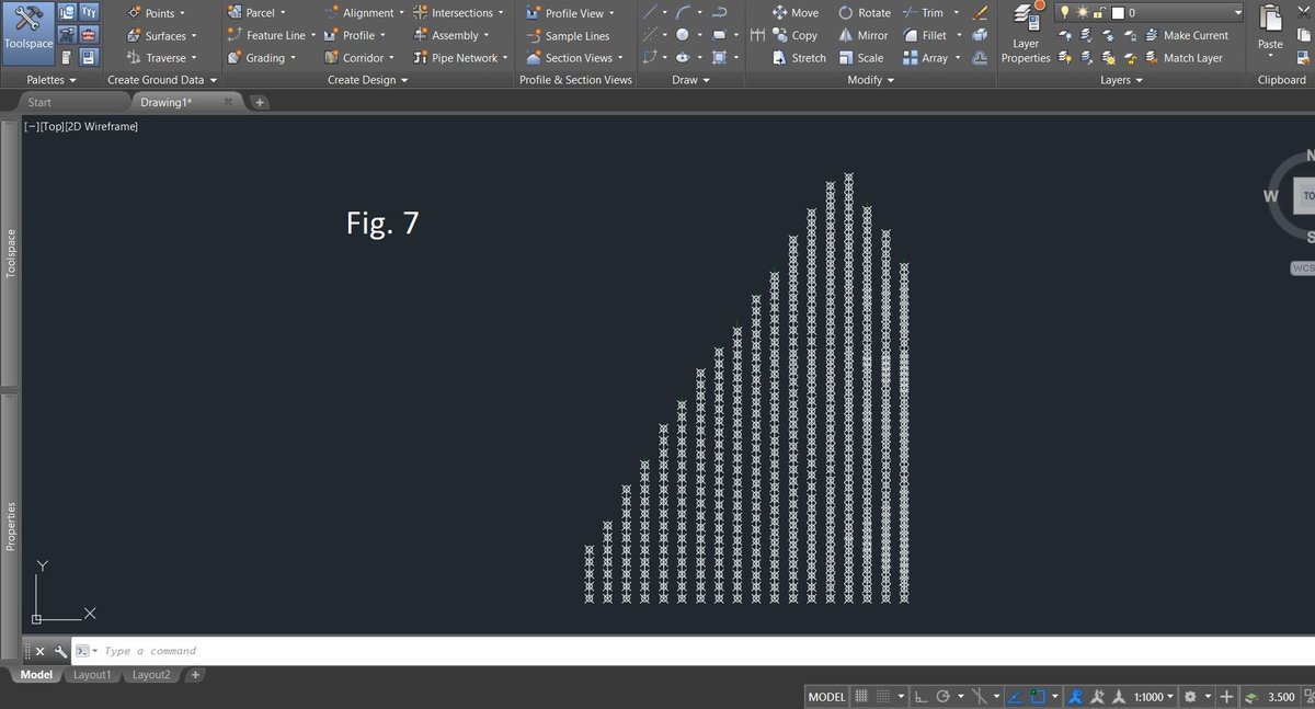

5. then i need to apply this set of actions to all the 3D polylines in the collection (See End Result in Fig.7) using the array parameters from step 2.

Can you maybe label which is Fig 1, Fig 2... Makes it easier for us to understand
From what I'm able to decipher, you want to draw a point at some interval from the start of the polyline. You don't really have to array it to find the points. This can be easily achieved by using vlax-curve-GetPointAtDist and incrementing the distance by a fixed amount. After which from there you can use those points to do anything... be it drawing a polyline, or even points.

So if you load the above, this example will draw a point on each one... This example is really no different than doing a regular path array on the curve (without rotation and any other settings).

2. the first polyline is a result of feature line of a TIN mesh of topography. i need to get a polyline with a fixed intervals,but one that will still use the elevation of the original polyline. that is why i create a path array of points with fixed distance along the first polyline and then convert it to the result ployline. the result polyline vertex's represent the location and elevation of irrigation emitters.

is it possible to add to it  a routine that do the last part - create from each set of points a 3D polyline like it is shown in fig. 5-6-7 with the polFPoints.lsp
