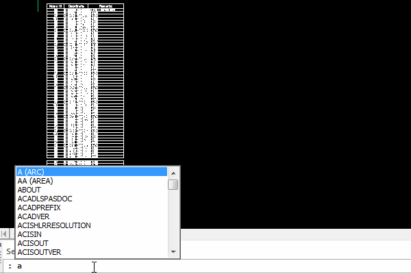

i have so many block attribute in my drawing, when i selection attribute and use attout. the result from txt file the list become not sequential.
for example :
I want the order to remain the same

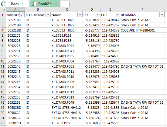

it seems ATTOUT sorts 'Handles' in decreasing (Z-A) order.
you can sort (A-Z) using EXCEL, select all excludes header (1st row)

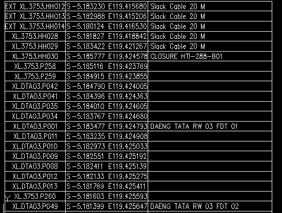

thanks for your help, However, this method is not always accurate, because some rows handles are not ordered from (A-Z). like this attribute:
and the result use sort by handle rows like this :

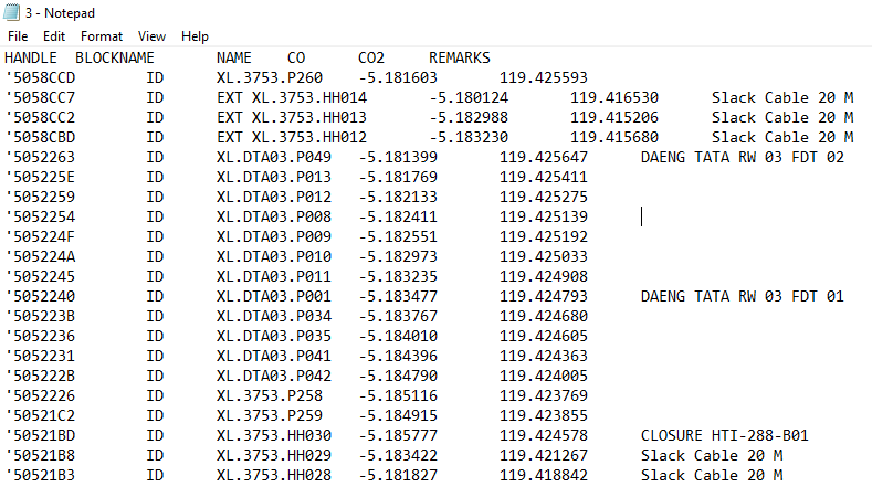

i just notice  Bricscad does not have Express Tool?! no ATTOUT ?
my attempt is not perfect, unlike ET can select all,
i just filter block name selection, i.e: much easier all same tags output
keep the output txt format same as ET does.

👌 ok not AcTable object , much easier
please read the header of routine of att:sort routine
you can customize your sorting parameters, simply edit index (0 1 2 3 ...) or (< >) sign
check in the example codes in C:ATTT, commented in side the code
(att:sort bn 1 >;;; here to adjust, (1) indicates sorting Y-coordinates, (>) Z-A
(att:sort bn 0 < )  ;;; (0)  indicates X-coordinates, (<) increment , but you need to rotate 90d to test
(att:sort bn 5 <;;This (5) indicates sorting TAGName , (4)=not in use BlockName all same, you can try 3,5,6 etc.. but can't promise
example:
Please test in your drawing
command ATTT
Index for block name ? : 39  ;;key in index 39 is for your block name "ID"

			  (setq	ls (cons
				     (cons (setq i (1+ i))
					   (cdr (assoc 2 b))
				     ls
		       -1
    (terpri)
    (princ x)
  (textscr)
  (initget 5)
  (if
    (and (setq i (getint "\nIndex for block name? : "))
	 (< i (length ls))
	 (setq bn (cdr (assoc i ls)))
	 (setq l (att:sort bn 1 >))  ;;; here to adjust, (1) indicates sorting Y-coordinates, (>) Z-A
	 (setq fn (vl-filename-mktemp
		    "att-"
		    nil
		    ".txt"
	 (setq f (open fn "w"))
     (progn (foreach x l
	      (write-line x f)
	    (if	f
	      (close f)
	    (vl-cmdf "_START" (strcat "EXCEL " fn))
     (princ "\nInvalid block selections!")
please test if work or error, i didn't test all
