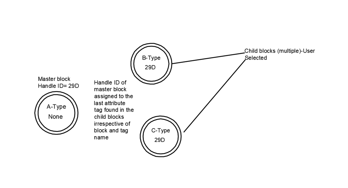

AbdRF Posted April 16, 2020 Share Posted April 16, 2020 (edited) Hello, I want to extract the handle value of a block (master block-single selection) and assigned that value to the last attribute tag found in the other multiple selected blocks irrespective of block and tag name. The blocks will have at the most 3 attributes (I mean to say that if there is one tag ,assign handle value to first tag, if there are two tags,assign handle value to the second tag and so on) Further I want to add that all the blocks in a given drawing will have same number of tags (either all of them will have 1 tag, 2 tags or 3 tags) and there will be no mix cases So here is my trail in which I am able to extract the handle ID of the master block but I don't know how to assign this value to the last attribute tag of the selected child blocks ( block name and tag name will vary from case to case but handle value should be assigned to the last tag found in each block) (defun c:AV (/ a b hv) (setq a (entsel "\nSelect the Master Block: ")) (setq b (entget (car a))) (setq hv (cdr (assoc 5 b))) Here I am attaching the image for further clarity Please help me to complete this lispI am attaching the sample drawing file. Thanks!Master-child block.dwg Edited April 16, 2020 by AbdRF Quote Link to comment Share on other sites More sharing options...
Jonathan Handojo Posted April 16, 2020 Share Posted April 16, 2020 Have you had a look at Lee's Attribute Functions link? You can use those. Or here's one without his reference (although it looks very similar in nature) (defun c:blkhandler ( / adoc atts hand i mast ss tag vlent) (defun *error* (msg) (vla-EndUndoMark adoc) (princ (strcat "\nError: " msg))) (setq tag "ins_no" ; <--- Tag attribute in block adoc (vla-get-ActiveDocument (vlax-get-acad-object)) ) (vla-StartUndoMark adoc) (while (null (and (setq mast (car (entsel "\nSelect master block: "))) (eq (cdr (assoc 0 (entget mast))) "INSERT") ) ) (princ "\nInvalid selection") ) (setq hand (cdr (assoc 5 (entget mast))) tag (strcase tag) ) (if (setq ss (ssget '((0 . "INSERT")))) (repeat (setq i (sslength ss)) (and (vlax-write-enabled-p (setq vlent (vlax-ename->vla-object (ssname ss (setq i (1- i)))))) (setq atts (vlax-invoke vlent 'GetAttributes)) (vl-some '(lambda (y) (if (eq (vla-get-TagString y) tag) (vla-put-TextString y hand))) atts) ) ) ) (vla-EndUndoMark adoc) (princ) ) 1 Quote Link to comment Share on other sites More sharing options...

BIGAL Posted April 17, 2020 Share Posted April 17, 2020 I notice the code appears to use tag's with attributes you can get the count of how many so can change any attribute without knowing its tag name. So for 2 3 4 its always the last attribute to be changed as per OP request can use foreach and a counter. Quote Link to comment Share on other sites More sharing options...
