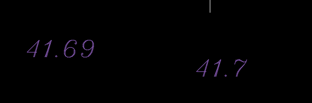

Another issue of mine. I got some texts, representing level above Sea Level on my drawing, but they are in old system, I got a constant that I should add to every TEXT object on that drawing.
Some pics of what I suppose to do, and I actually don't understand, why my code doesn't work..

It looks to me as if your "rtos" function is being affected by the system variable DIMZIN

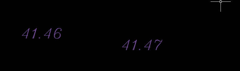

This step is executed by programm clearly, the problem is that code doesn;t change old text values to the new ones, as shown on pic I pinned. below are old values and above are new ones..
Edited by ojacomarket
I am presuming that your problem is that the new value of '41.70' is only shown as '41.7'. That is to say the trailing zero has been left off.
If you investigate the working of DIMZIN and its unintended effect on 'rtos' and 'angtos', you will see what I mean.
Just to test my theory, see what DIMZIN is set to now, change it to 1, run your lisp and see what happens.
If your lisp now runs as it should, then you can edit your lisp to run perfectly.
So... you got the insertion point, rotation, and text... where all you need is the text. Why would you need to gather all the other data?
Plus, you only set your results in the "new_coords" variable, you didn't actually modified the entity itself. You should look at the entmod or vla-put-TextString function.

Doesn't change...
I for real, have no Idea why the code doesn;t make new text objects with new elevations... as I made entmake with old coordinates and rotations... but nothing happend

Thank you very much! That result is what I needed. For sure I have forgotten about entmod func.
Code got excellent result!
